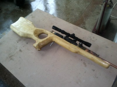

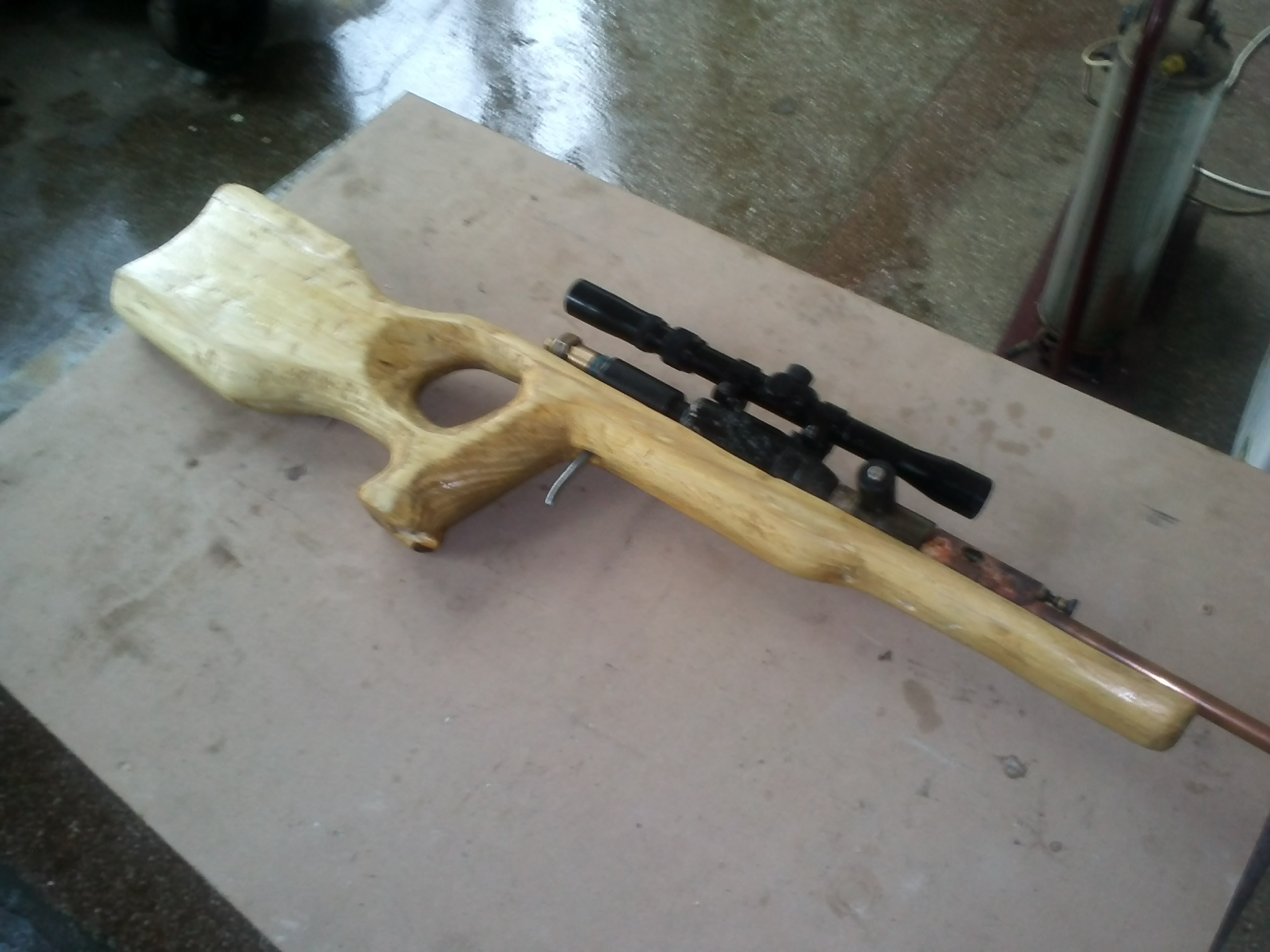

my second 6mm. custom QEV sniper airgun updated

so I went to the country and I had some target shots from 15 meters, my scope was off a little bit because I had to asemble the gun on site. hope you like it

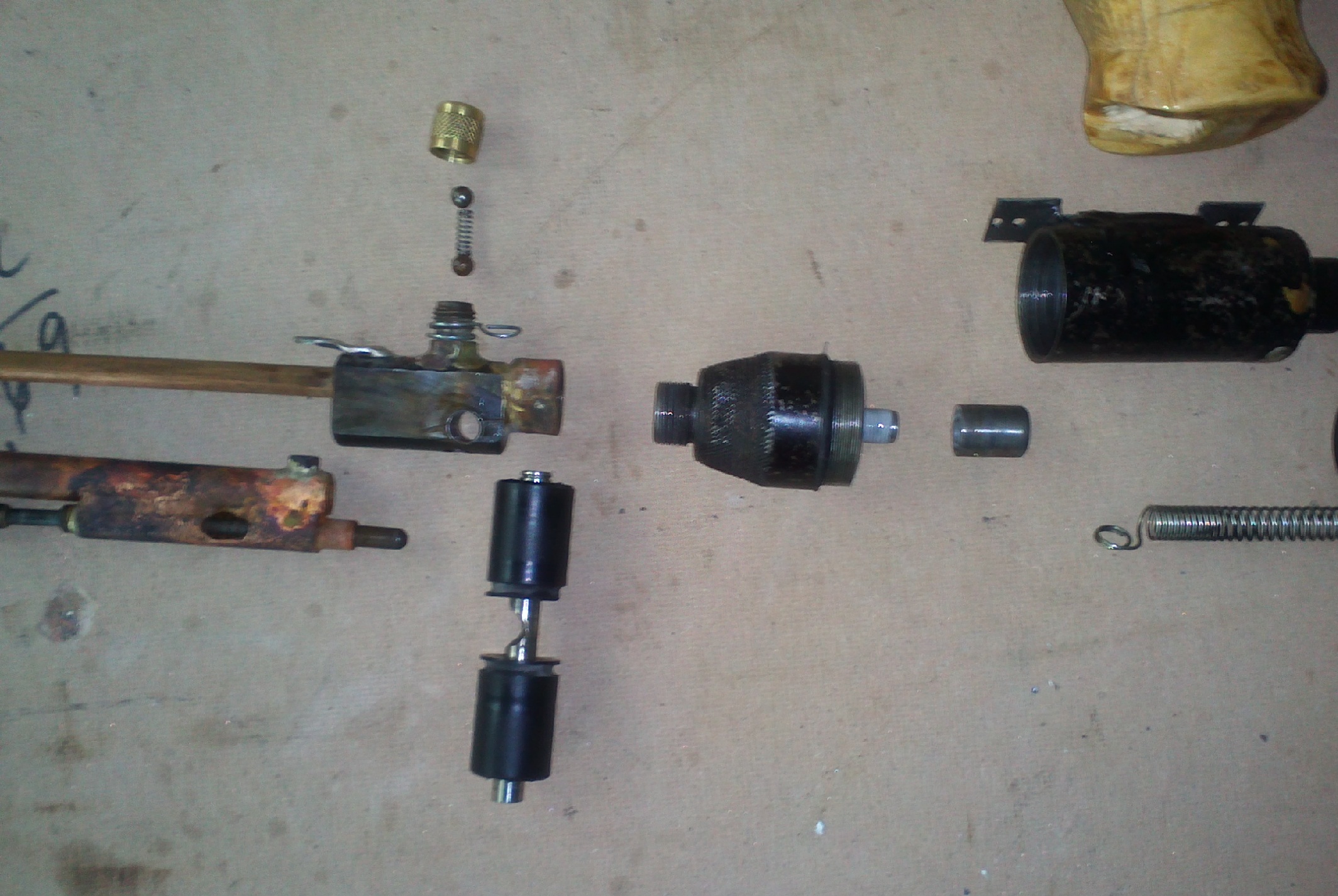

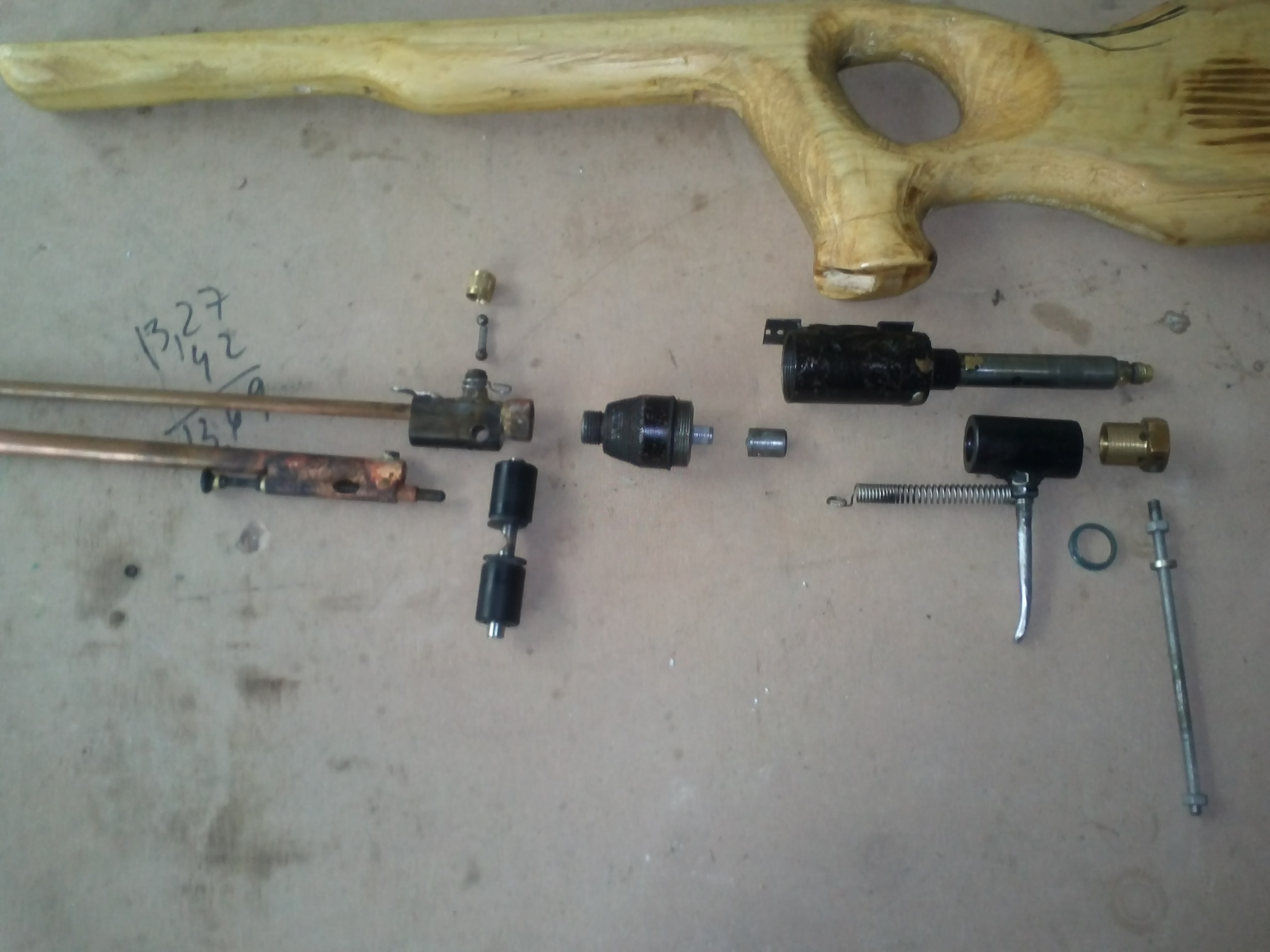

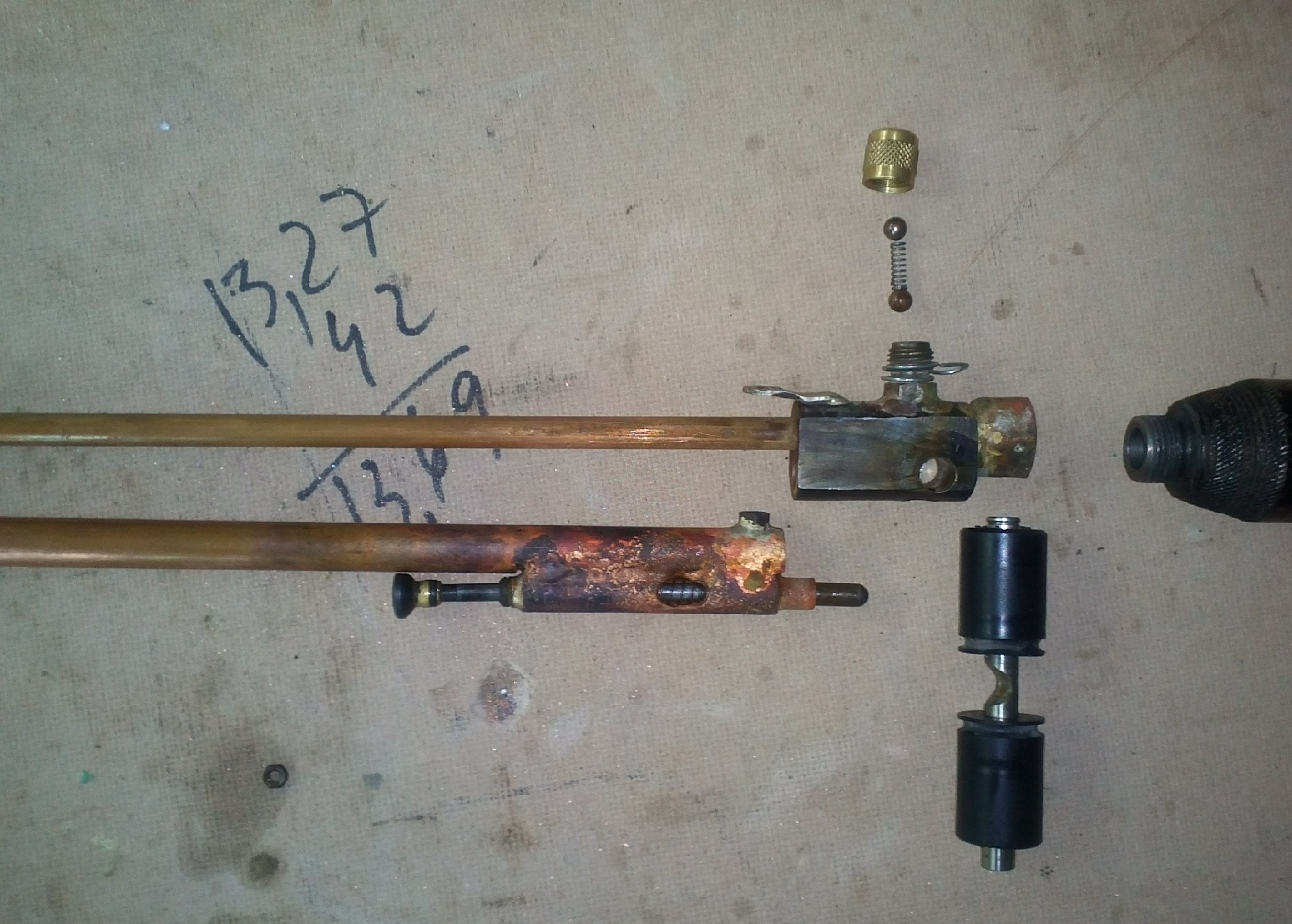

hy there, so I took your advice and made a detent loading mech, I think it achived semi, but I tested it on a lower gas pressure, because my co2 tank was nearly empty. Anyway, here are some pics, video will come when I'll carge my co2 tank.
It still needs some finishing.
airgun parts overview

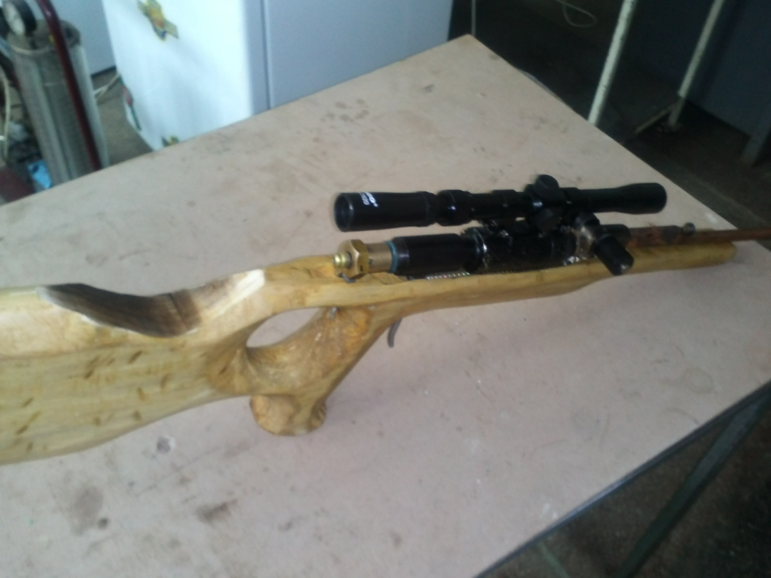

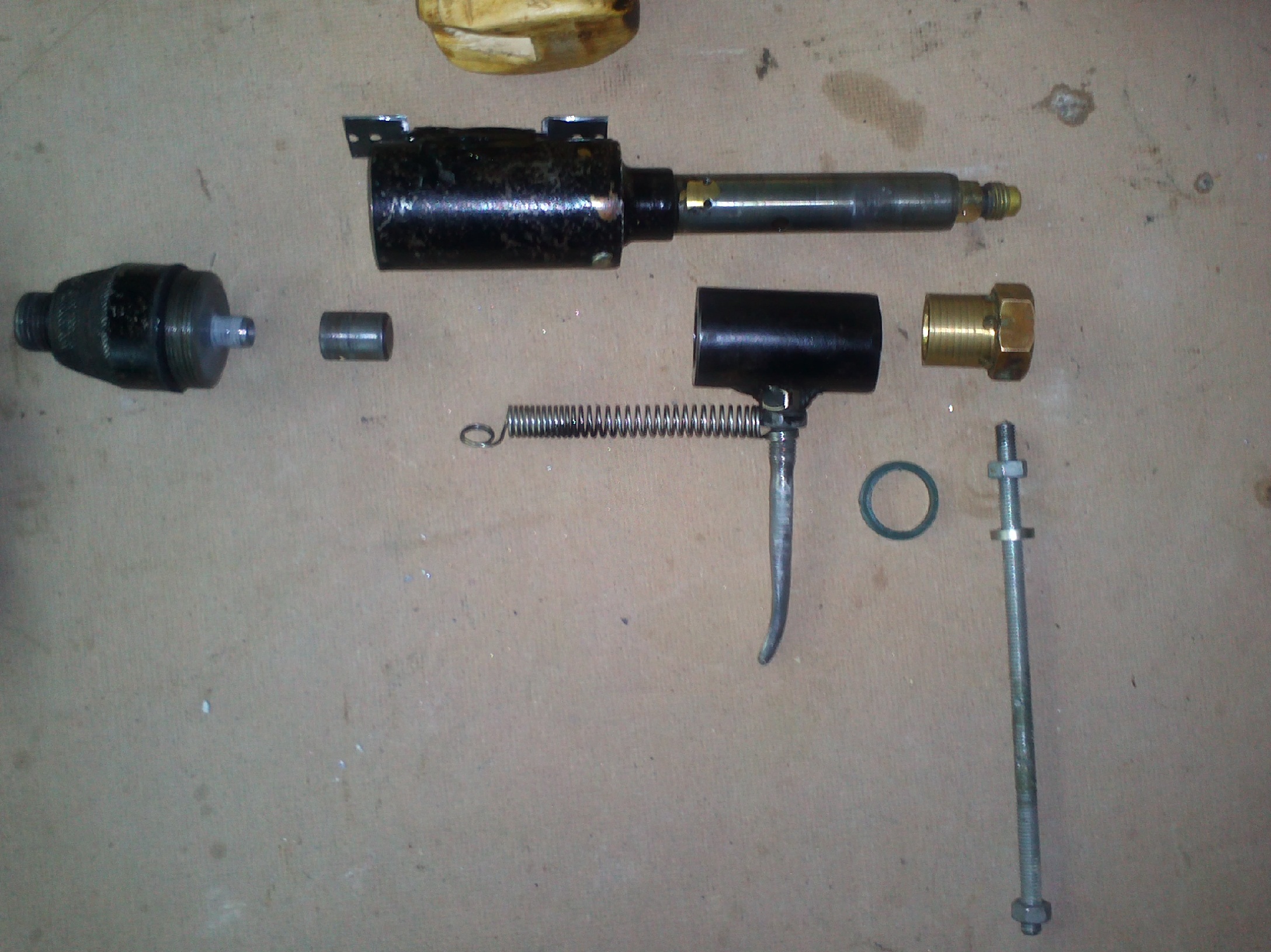

more pics ...
hopefuly some advices

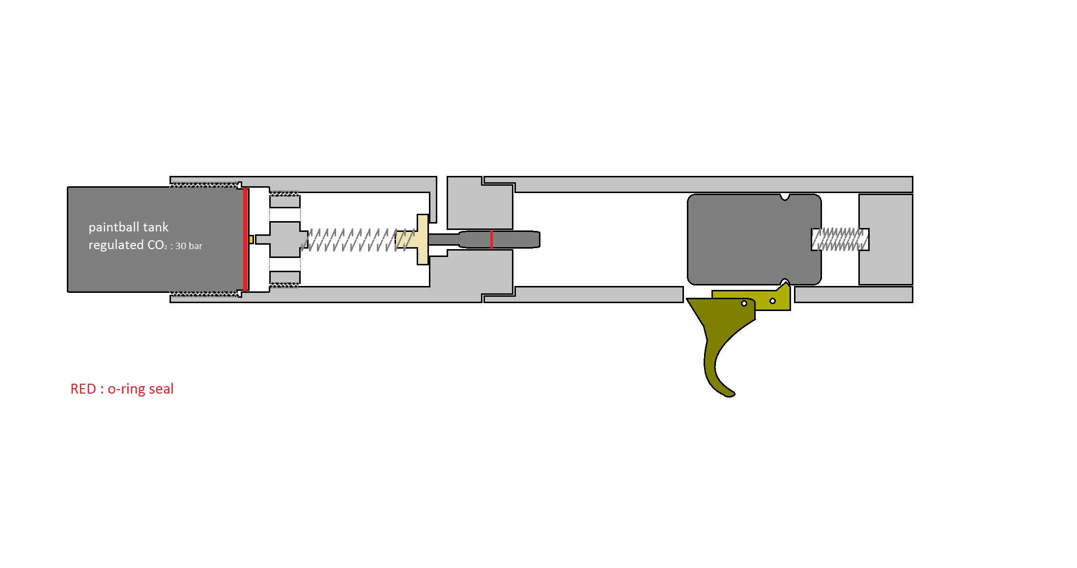

do you think this concept will perform better than my current one on regulated 30 bar pressure ?
BLD 3 project
BLD 3 project
Has thanked: 581 times
I don't think a hammer valve will give you more power unless you make one with exceptionally good flow struck by a decent hammer. What a hammer valve will allow you to do is tune the air usage to maximize number of shots per tank.

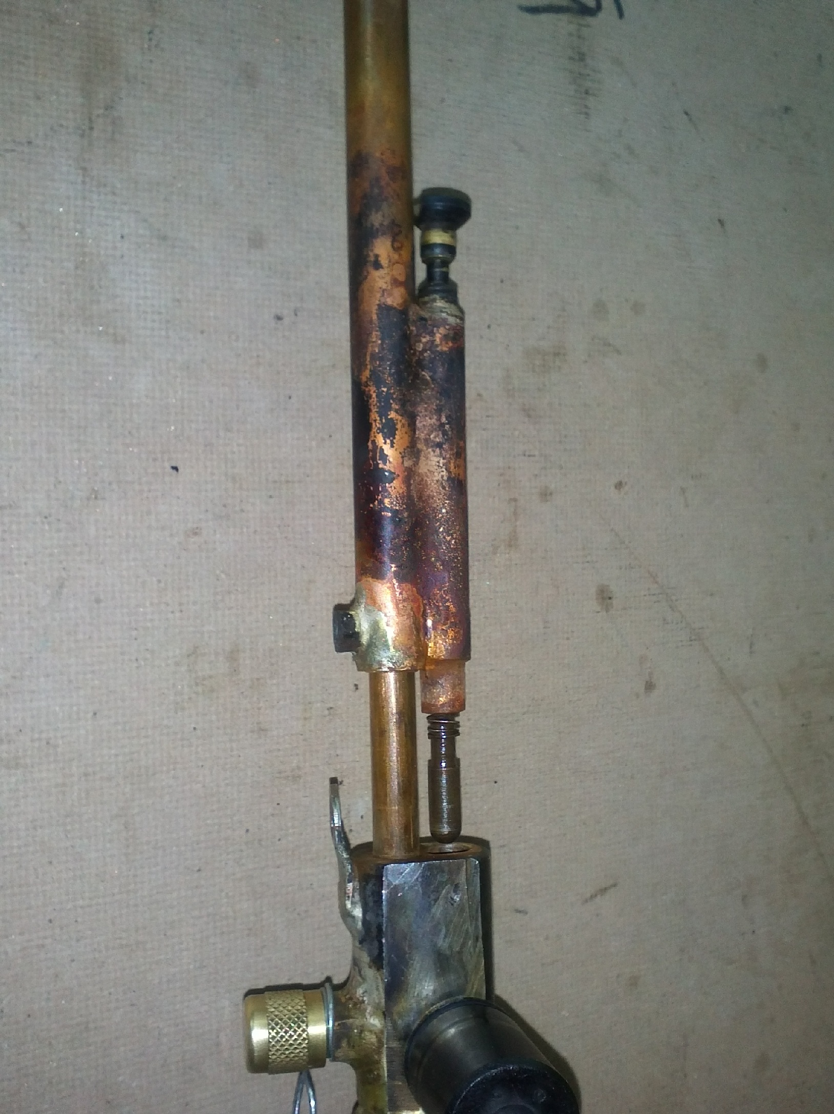

Hy there, it's been a while, since I worked on my BLD3 hammer-valve project.
I replaced my steel qev piston with a plastic one, much more light than the previous one, with a better fit; also added a spring behind it.
overall I feel a much better performance than before(better BOOM sound), and also less gas lost with the pilot(thanks to bravotoome).
