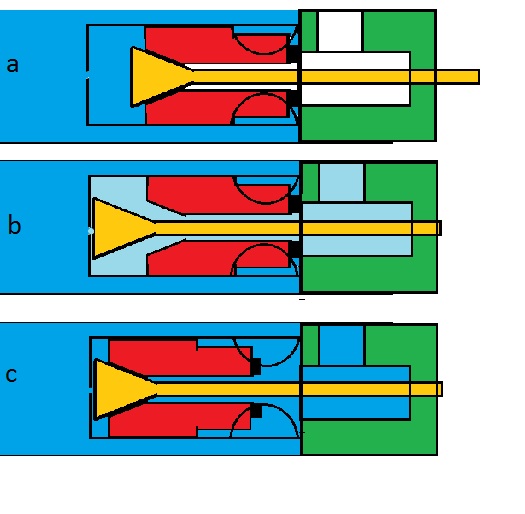

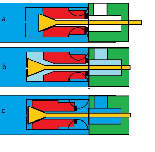

I thought I posted this here yesterday but somehow it ended up in the wrong topic..
Anyway:
You could do a hammered pistonvalve in a traditional hammervalve configuration.
This could be fired with a crosman style hammer, with a relatively weak spring.. but will give a much more powerful shot.
By not sealing around the valvestem you could make the hammer blow back.The blast from the piston should be powerful enough, especially since you won;t need a very powerful hammer to set it off.
a. hammervalve and pistonvalve are closed. (REST)
b. hammervalve releases the pilotpressure.
c. pilotpressure has dropped and piston pops back ( FIRE)
( What do I know right? I've only got 1 reputation point...
Anyway:

It is a pistonvalve housed in a tube, set inside a larger reservoir.
It is piloted through the center of the piston via a hammer- or poppetvalve.
Since the hammervalve is orientated just like a traditional hammervalve it can be used in the same way.
The piston however adds a lot of power to the valve.
As it is triggered, the piston will slam back and open the airflow to the transferport, opening a much larger "hole" than you could achieve with a normal hammervalve.
It asks little, yet gives a lot.

Ah, okay, that makes sense. That's actually really clever.........you may have just answered my questions.
