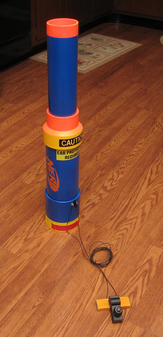

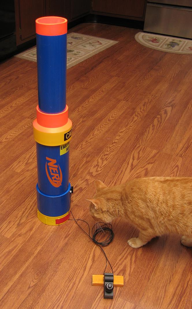

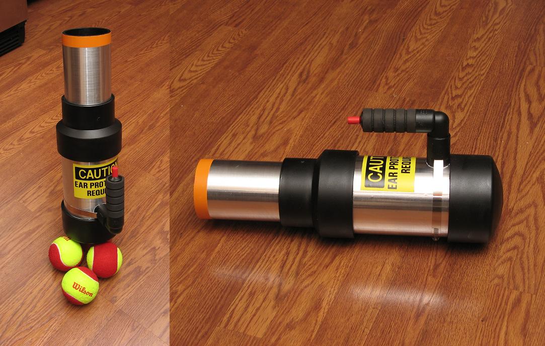

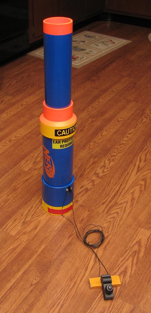

We decided we are going to try shooting 2 liter bottles converted into rockets off these with the smooth barrel. Most of mine have a sleve over the end near the muzzle but he didnt want that on his. I decided to make one like his with the Nerf colors
I used a sparker from walmart with the battery in it. I was able to run about 5' of wire off that sparker and still get a nice spark. Im thinking ill just leave it on the ground and it can be a foot switch. Tap it with your toe or a stick to ignite it.

they are not i took some foil tape i bought some years back for a guitar i rewired. I put the foil on the inside of the cavity and on the cavity plate to shield the electronics. Ive since used it for other things here and there mainly for stickers though.
I used a paper hole punch and just punched a bunch of them and stuck them on. I kinda like that rivets also it makes it look more machine like. I think i used to many im going to peel a few off, i forgot i added those to that cannon i need to add some to my motar now so they both kinda match.

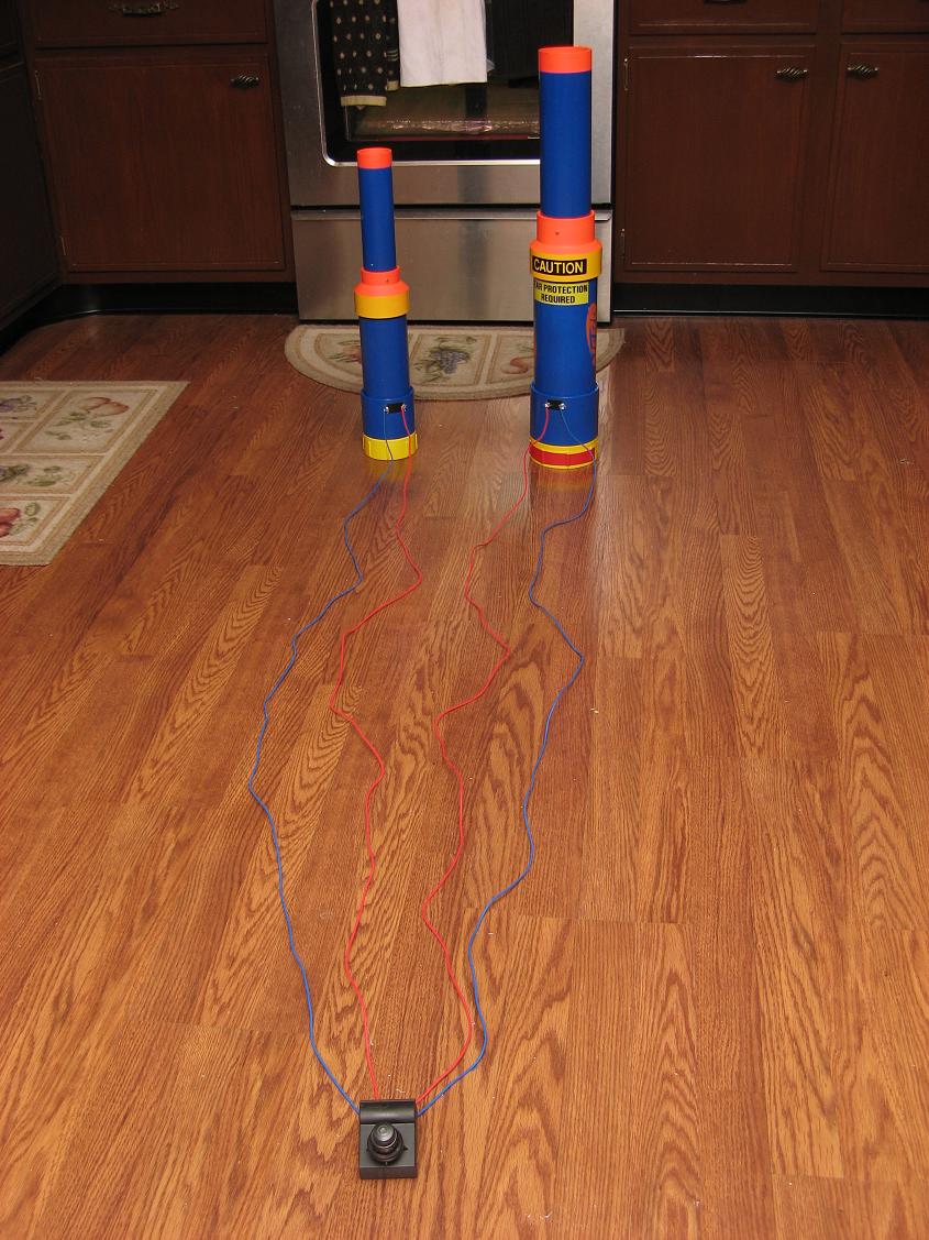

Has anyone thought of this one before? I was hopeing they would both fire at the same time and create like a chord of explosions, one being deep and one being higher pitched but i never thought about the resistance of the 2 being different. They spark together but a little bit apart like one fires then it charges the cap back up then the other one fires a milisecond apart. They are both different too, first the larger one goes then the small then vise versa on the next fire.
I thought maybe its the gaps i have the screws apart but im not sure, the wires art identical in length and stuff either.
With all these cannons my neighbors will be ready to move after 4th of july im sure of it.

I never thought of that! That's a great idea. Multiple cannon simultaneous ignition! I'm going to have to think on this one.
Two ideas...
1: You are using a parallel circuit, try using them in series? You have a positive and a negative wire running to each cannon( or each spark gap). Try running a positive from your ignition to one cannon, then a wire from the negative on that cannon to the positive on the other cannon and then a negative back to your ignition. I think this will fix you issue. If not try #2.
#2: Could you use two separate ignition systems with a switch that activates both at the same time. If both are separate your ignition doesn't have to recharge to fire the second cannon. Right?
Two ideas...

The 2 mortar cannons worked good running them in series with the electronic sparker, thanks for your help.
Give me a minute to edit the 2 cannon shoot i shot all 3 of them today
