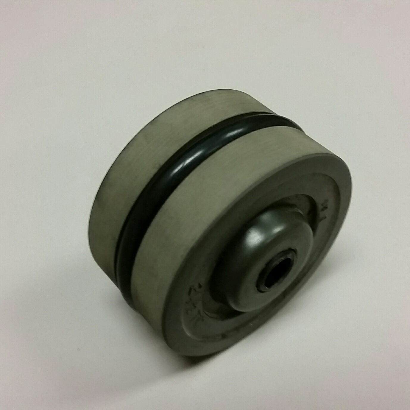

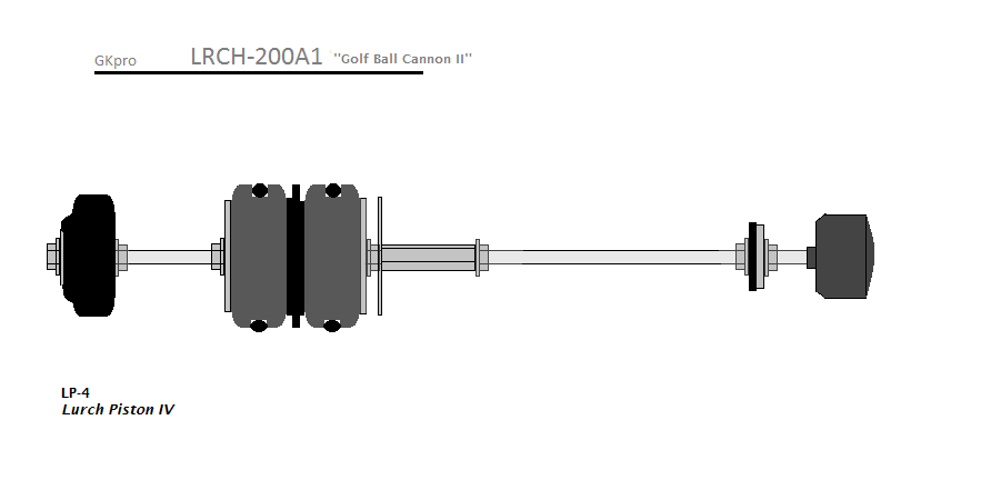

Boredom kicked in, and new ideas began to flow. I decided to roll the LRCH-100 frame into the LRCH-200. That was the easy part. Then I began brainstorming new piston designs short of having an aluminum one made on a lathe. I am now on the 4th iteration of my idea (LP-4). The LP-3 passed a "design potential" test yesterday, so it is pushing me forward with the design, but with improvements.
The LP-4 piston will consist of hard rubber caster wheels with O-ring grooves cut into them with a makeshift lathe. That's the hard part. The rest pretty much follows my original design.

LP-4 piston is making progress. LRCH 200 is slated for operational testing this weekend at the proving grounds.
Lurch Piston 4th Iteration
Modified Caster Wheel
