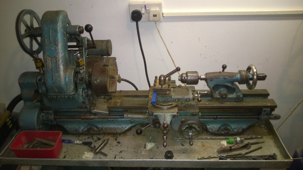

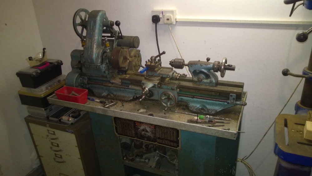

It's an old Myford ML7, think it is late 1940s!!! Its an English manufacturer so not sure if you will have heard of them. Not sure what size it is, I will take a photo of it. It isn't perfect, but I think operator incompetance doesn't help things. Hoping in near future that my dad is going to get a more modern smallish lathe, something like an Emco.

I like what you got right there better than a Emco. Some elbow grease to clean it up and you got a nice lathe. From the pic I'm guessing 10X22 on the size.Hoping in near future that my dad is going to get a more modern smallish lathe, something like an Emco.

Really!? I was hoping a new lathe would allow greater precision and accuracy, I must admit considering it is 65 years old it does OK. Think I need to practise along with a modified design to improve my project, I have ordered a 100mm long 1/2" bsp brass extension tube that has male threads one end and female the other, I will remake the bolt in delrin (as run out of brass) initially but this time only have one step in it for the spring seat rather than 2, I am also going to buy a brass fitting which is threaded one end and straight 15mm tube the other in the hope that it will be more precise than my current air inlet piece which is soldered into a threaded fitting. If I get chance tomorrow I am going to cheat and try chemical metal epoxy to bond the air inlet into place so that I don't need to pull it up tight on the threads and see what happens.

Ianbuckwell wrote:Really!?
Oh Yea. You probably have a fair amount of tooling already, there for won't have to rebuy all that like you would if you buy a new lathe.
Not ANY low cost hobbyist machinery that I know of. It's a trade off, price / quality.I was hoping a new lathe would allow greater precision and accuracy, I must admit considering it is 65 years old it does OK.
To most of us it's still practise! L0L :bigsmurf:Think I need to practise along with a modified design to improve my project
Tough stuff but flexing might happen with the thinner diameter.
Brass fittings are rarely true and to thin walled to fix. It's my only real con for using brass fittings as chambers.I am also going to buy a brass fitting which is threaded one end and straight 15mm tube the other in the hope that it will be more precise than my current air inlet piece which is soldered into a threaded fitting. If I get chance tomorrow I am going to cheat and try chemical metal epoxy to bond the air inlet into place so that I don't need to pull it up tight on the threads and see what happens.
