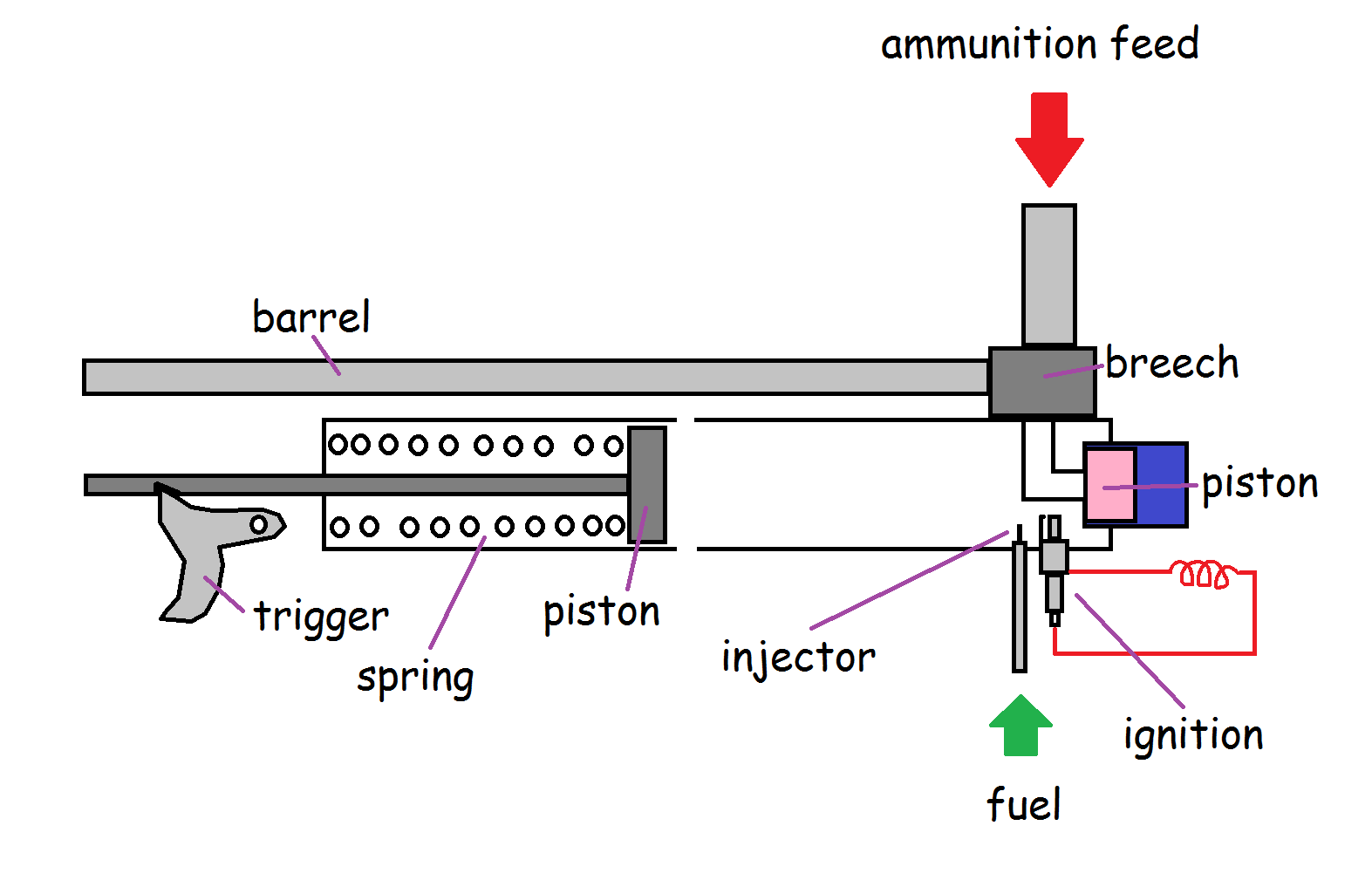

Compression piston driven by a heavy duty spring spring held by a trigger. Fuel is injected, trigger is released compressing the fuel air mixture which is ignited at the moment of full compression. Overpressure opens the breech piston which allows the hot gasses to dump through the barrel, and they also re-compress the compression piston ready for the next shot.

Why not use gasoline, it's a much more energy dense fuel than propane and this means you would not need any compressed fuel around the launcher at all. The only trick is injecting the right amount, but internal combustion engines have been doing this for more than a century.

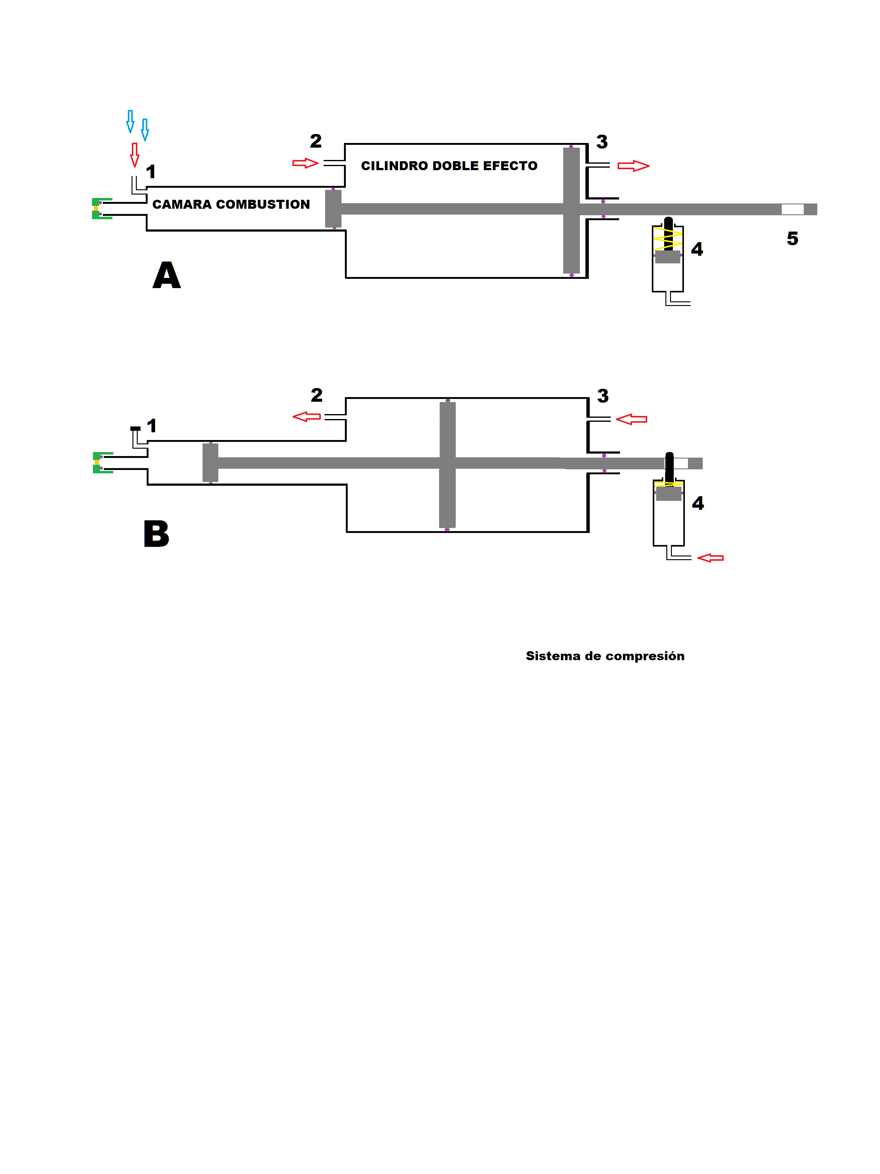

This is an idea to compress the mix into a hybrid I was thinking about.
It would work as follows.
In the "A" position of the diagram:
The double-acting cylinder can be operated with compressed air or a gas tank (propane), which has the advantage of not requiring the system any type of compressed air, to do anything. Directly use the gas pressure to compress the hybrid.
When the gas enters by "2" and escapes by "3", the combustion gas (previously dosed), and the necessary air are sucked by "1." This double-acting pneumatic cylinder is connected to a Distributing valve 5/2 to perform the retraction of the plunger in both directions.
The mixture is thus ready to be compressed.
In position "B":
The gas and air inlet "1" is closed by means of a valve.
The gas enters by "3" and escapes from the other side by "2", forcing the major piston towards the left. As the piston of the double-acting cylinder is larger than that of the combustion chamber, the force is applied in a smaller area and therefore the pressure rises.
The pneumatic actuator "4" actuates and locks the piston rod of the two pistons and is the one that tolerates the effort of the explosion, holding the two pistons in place.
For example, here an estimate:
If the propane is about 7 bar, and the area of the larger piston is about 28 cm2 (Diameter 6 cm), and the smaller piston has an area of 7 cm2 (diameter 3 cm), the force exerted on the piston greater:
F= P . A,
F= 7 Kg/cm2 X 28 cm2
F= 196 Kg
With this force as an example, in the smaller piston of the combustion chamber the pressure is:
P= F / A
P= 196 kg / 7 cm2
P= 28 Kg/ cm2 unas 400 Psi
There is no need for me to describe the cartridge loading system, which is based on the charging system I have built for the improvement of small autonomous hybrids. I will put it in my post as soon as I can make a video of how it works.
I would like to know what you think about this possibility. I'm sure there are MANY ways to do this ....
