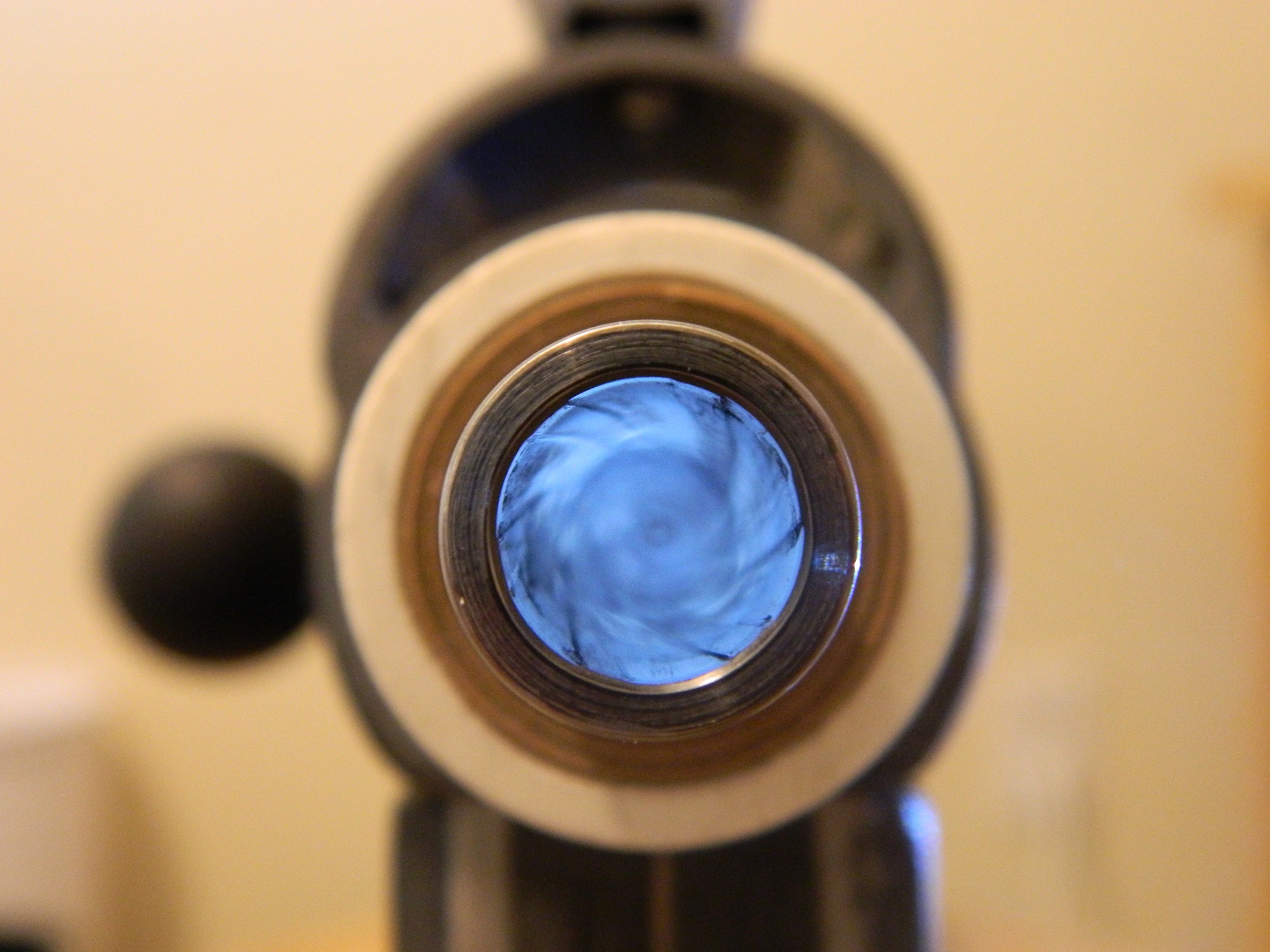

I got a chance to test out my idea of adding a smoothbore extension to the rifled barrel. It wasn't as accurate as just the 10.5" rifled barrel by itself. It did seem to do a bit more damage to the stool though. The damage is shown at the end of my shooting video:
I decided to go back to having just a rifled barrel because it isn't that much slower and it's more accurate. Plus it's a lot more compact and light.

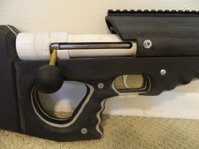

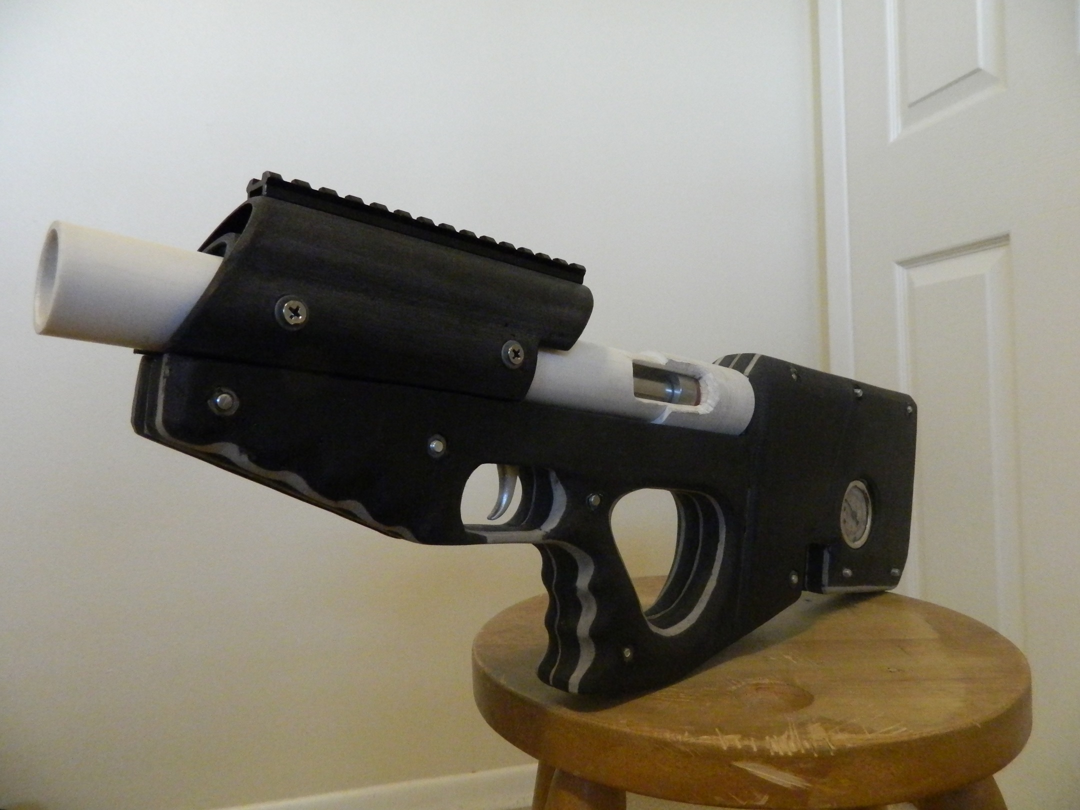

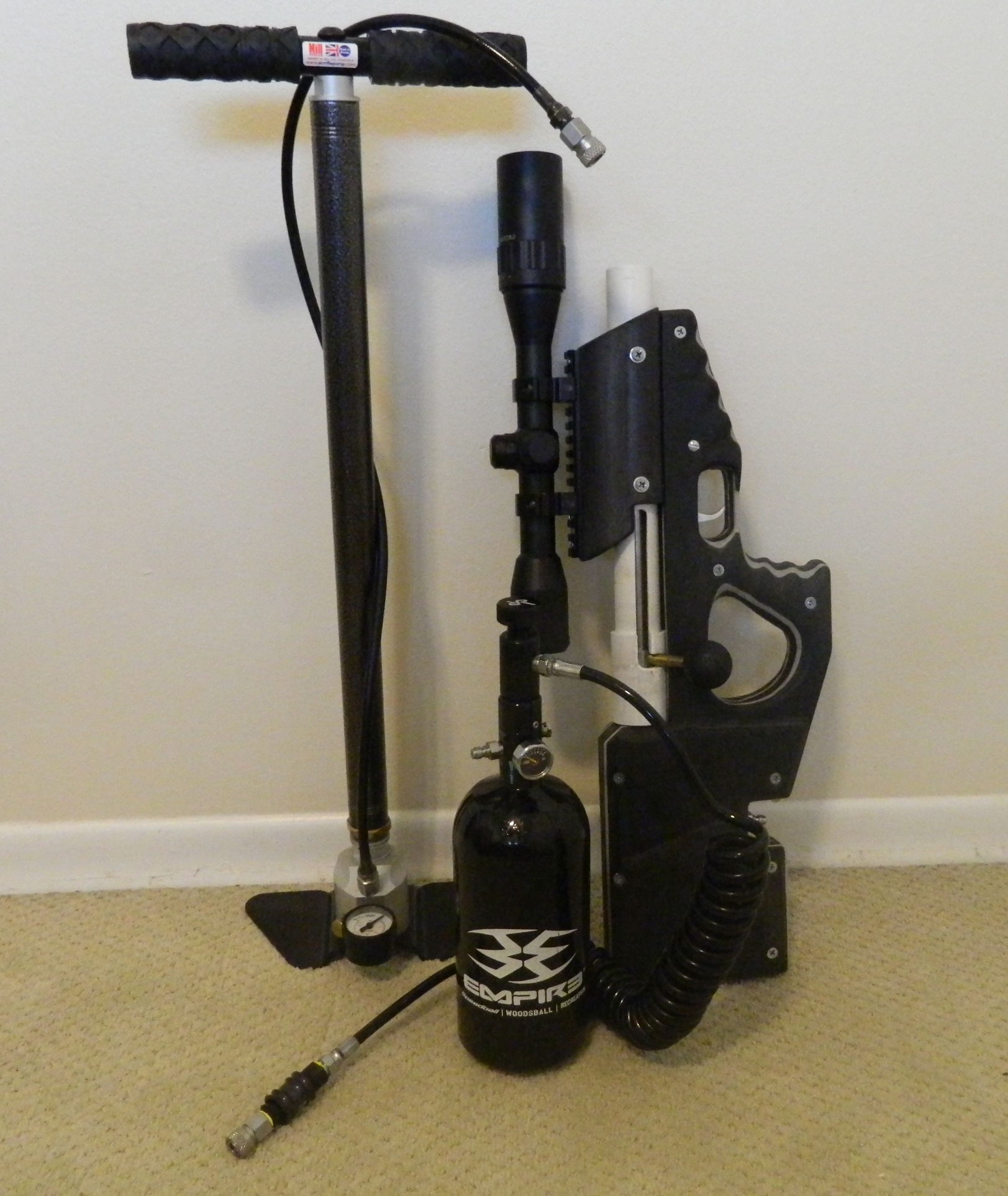

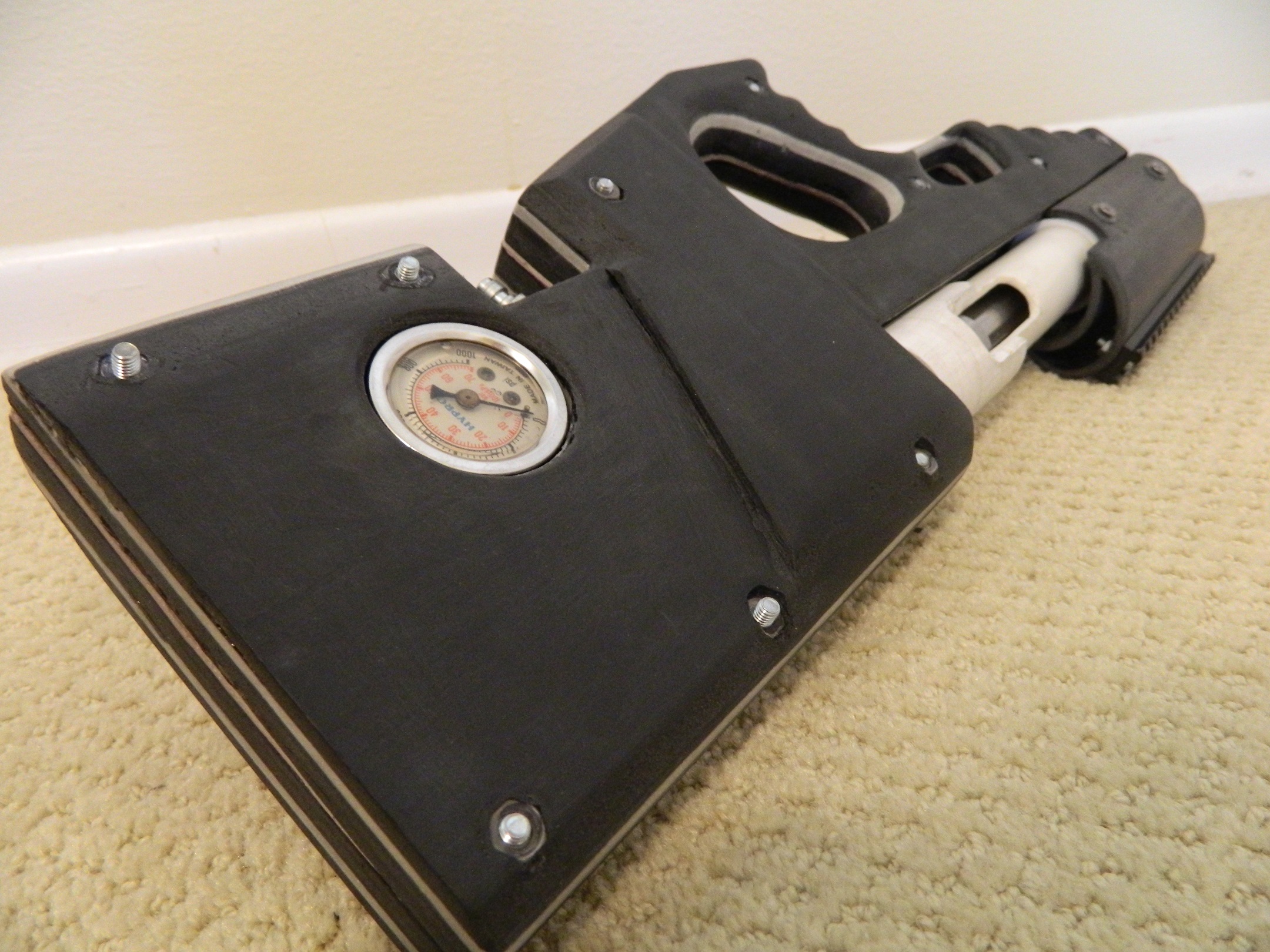

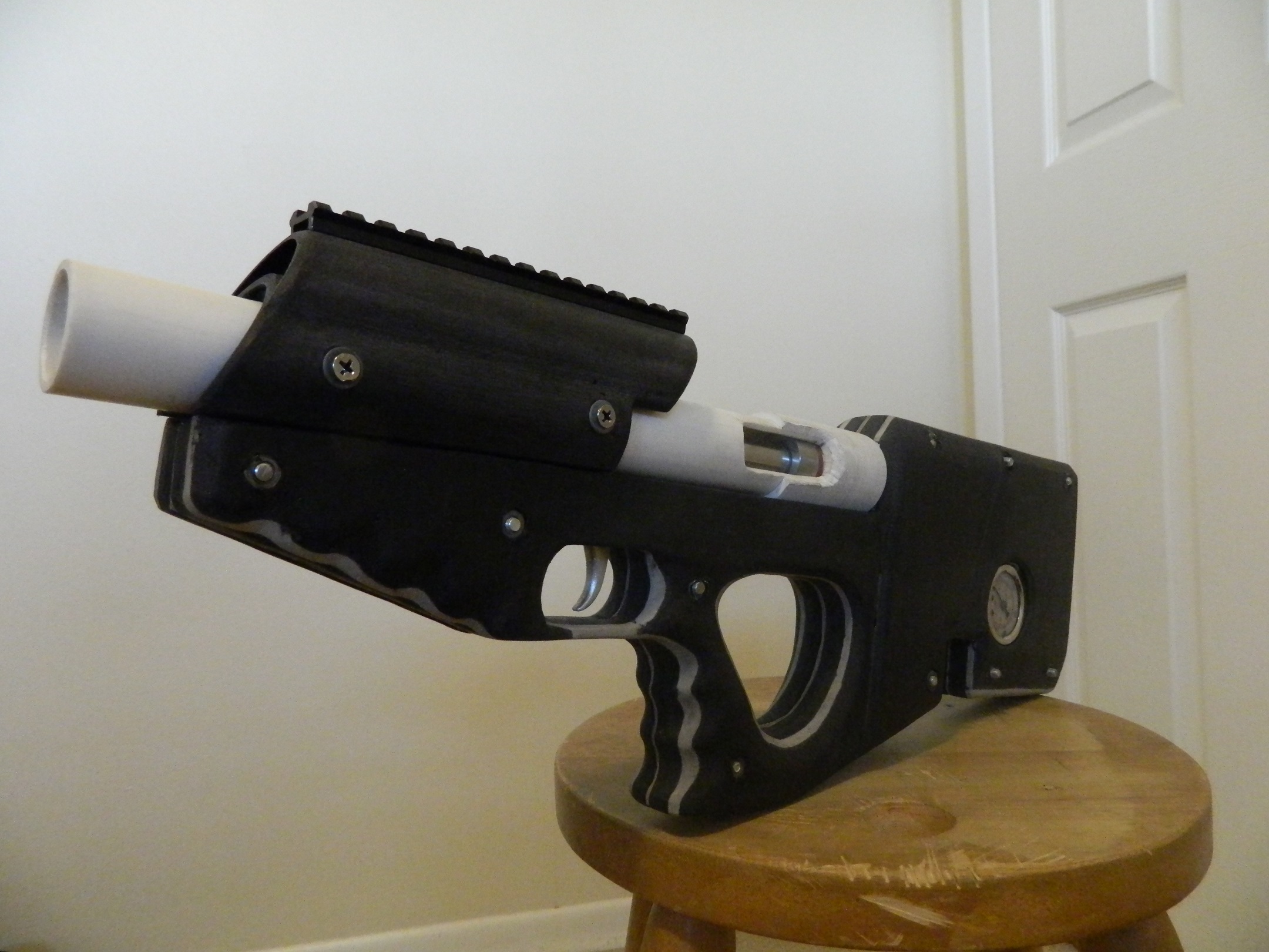

And here are some pictures of my final setup and a picture of the rifling:

Looks like the barrel moves in and out to expose the breech for loading. Is there any play in the barrel when locked in position?

There isn't any play in the barrel when locked because of the two points of contact. It is a similar sealing system to my most recent combustion cannon "The Jackal" where the wedge of the bolt slide forces the seal against both surfaces.
