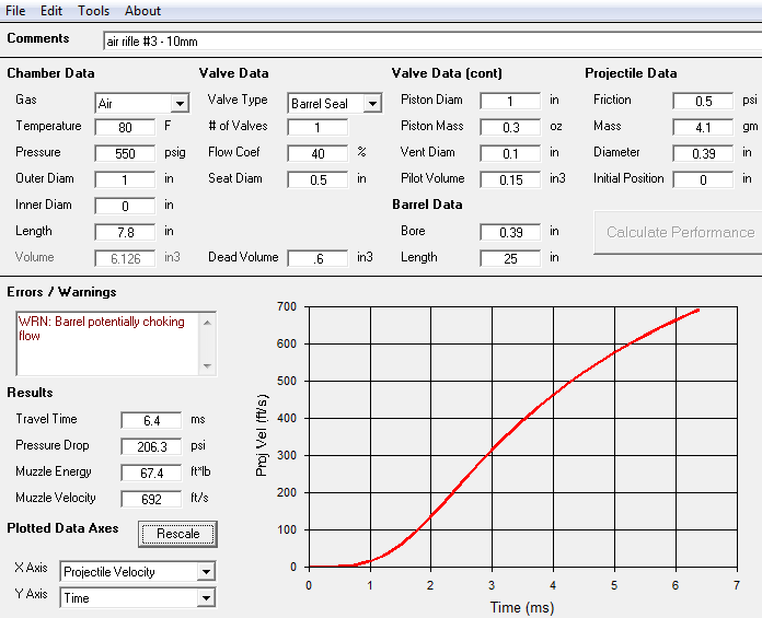

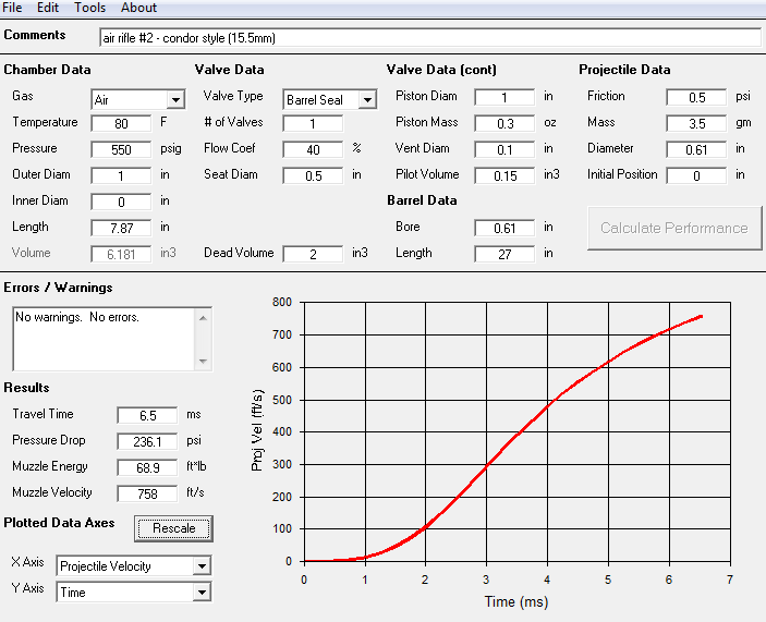

GGDT data:
15.5mm condor
15.5mm condor
10mm
10mm

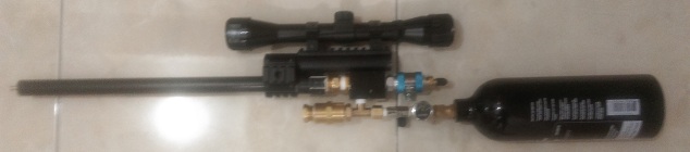

so, i just started testing today & i got a problem. I've connected the paintball tank with the remote line to the slide valve+ qev, like this:
it's the exact same setup as the first rifle only instead of the soda stream tank i got the paintball tank with the regulator.
when i open the regulator and take a shot, the slide valve won't go all the way backward (creating a leak), i think the pressure is to great for the slide valve to move all the way backwards. when i close the regulator & stop the air, it's easy to move the slide valve.

by jackssmirkingrevenge
Increasing the pressure should make the slide valve harder to open (more force on the o-rings -> greater expansion -> more friction) but it shouldn't limit its range of motion.
his paintball tank is connected to the air port, not to the pilot port & the slide valve operates fine at 800 PSI. is that the solution?
The beauty of the slide valve is that it is a three-way valve, simultaneously piloting the valve while also closing off flow from the main chamber. Note that in the example you posted, there is a separate ball valve that you need to open to fill the chamber before every shot, and then close before firing to avoid emptying the whole tank.
yeah, that's why i rather go with filling the air from the pilot side as I did before, but i have to find a way to deal with that slide valve. maybe I'll build a button valve similar to the one here

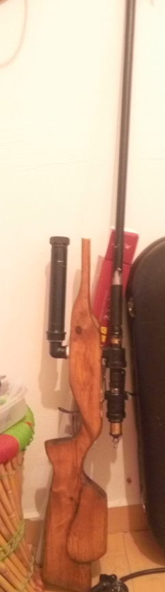

here is the stock i made for the old 15.5mm condor style rifle, it's not finished yet.. still got some sanding & shaping to do, but i'm getting there.
after that i'll mount the 3-9X40 scope on it.
ones that's finished I'll get to the new 10mm rifle with the 2.5-10x40 scope, it will have a smaller, 3\8" QEV + Slide valve to avoid barrel potentially choking & i hope i can embed it all in a new stock so the valves will stay hidden.
This isn't really an issue per se, GGDT tells you this to say that you can have a bigger barrel if you want. That being said, with a smaller QEV you'll get more efficiency.

can't wait to build the 10mm one (allready got 63 grains bearings balls for it) , I think i'll make the air chamber half the size (50cc) this time, GGDT tells me that velocity won't be affected much by it (gotta get a chronograph), and i suspect it will increase (double :?: ) the amount of shots .
