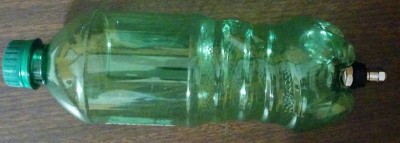

My bottle "shell"
My bottle "shell"
Sorry for the extremely long wait, I took a break from this project but I'm back at it now!
I finally found some Schrader valves, and I installed them into mountain dew bottles (they are a pretty good fit in 3" PVC and are made of a thicker plastic).
However, the burst disks are still not working. I tried an O-ring but it was too thick and would not let me screw the cap back on. I tried taping the aluminum foil, I tried glueing, I tried alternate burst disk materials, but nothing seems to work!
On top of these struggles I'm worrying whether it will even have the necessary force to leave the barrel, but perhaps adding some water into the bottle like a bottle rocket may help...

by Anatine Duo
I want to see this work so keep at it!
Try using a gasket from inside the bottle cap for a burst disk. It should fit perfectly and seal. If it doesn't rupture nicely maybe alter your firing pin as suggested above (blade/s instead of nail, or a serrated tube)
Also you can cut a hole in that gasket to use as a sealing washer... much thinner than the o-ring.
The water rocket idea sounds good too, probably more fun to watch.

Re: CO2 Stokes Mortar
Posted: Sun Nov 05, 2017 12:12 pm
by Cthulhu
Thanks for the advice guys, I made a lot of progress this morning, but it's still not functioning properly.
I found out that the mountain dew bottle caps have a little extruding ring on the inside that prevents a gasket or O-ring from fitting inside. I simply opted to use coca-cola caps instead.
My sealing rubber is actually a rubber pad meant to go under furniture feet, but it's fits perfectly and seems to make a good seal if the burst disk is cut well.
Sadly, even though I've been able to pressurize the bottle, the disk refuses to burst. Instead the firing pin simply pops a hole in it and the pressure instantly leaks out with a "pssssss" noise. I'm pretty sure this is from low pressure, but every time I try to pump higher the disk explodes before I'm able to remove the pump.
Then again it could be because the air pressure has no mass to push on, so perhaps placing some water in the bottle is needed... :scratch:
