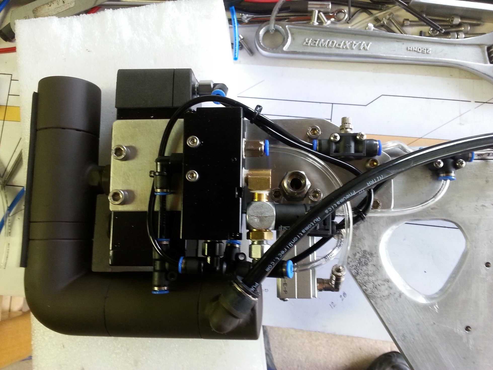

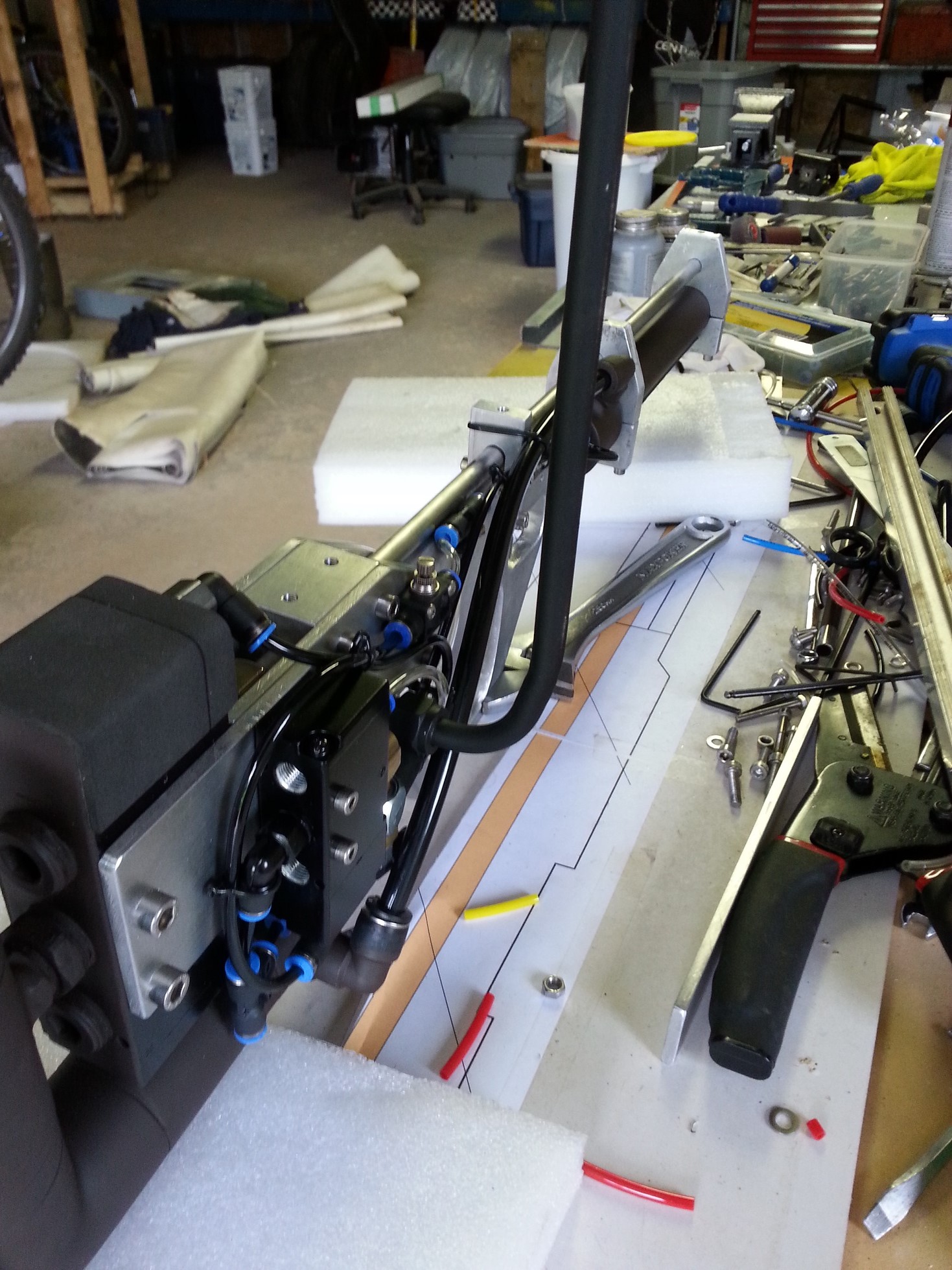

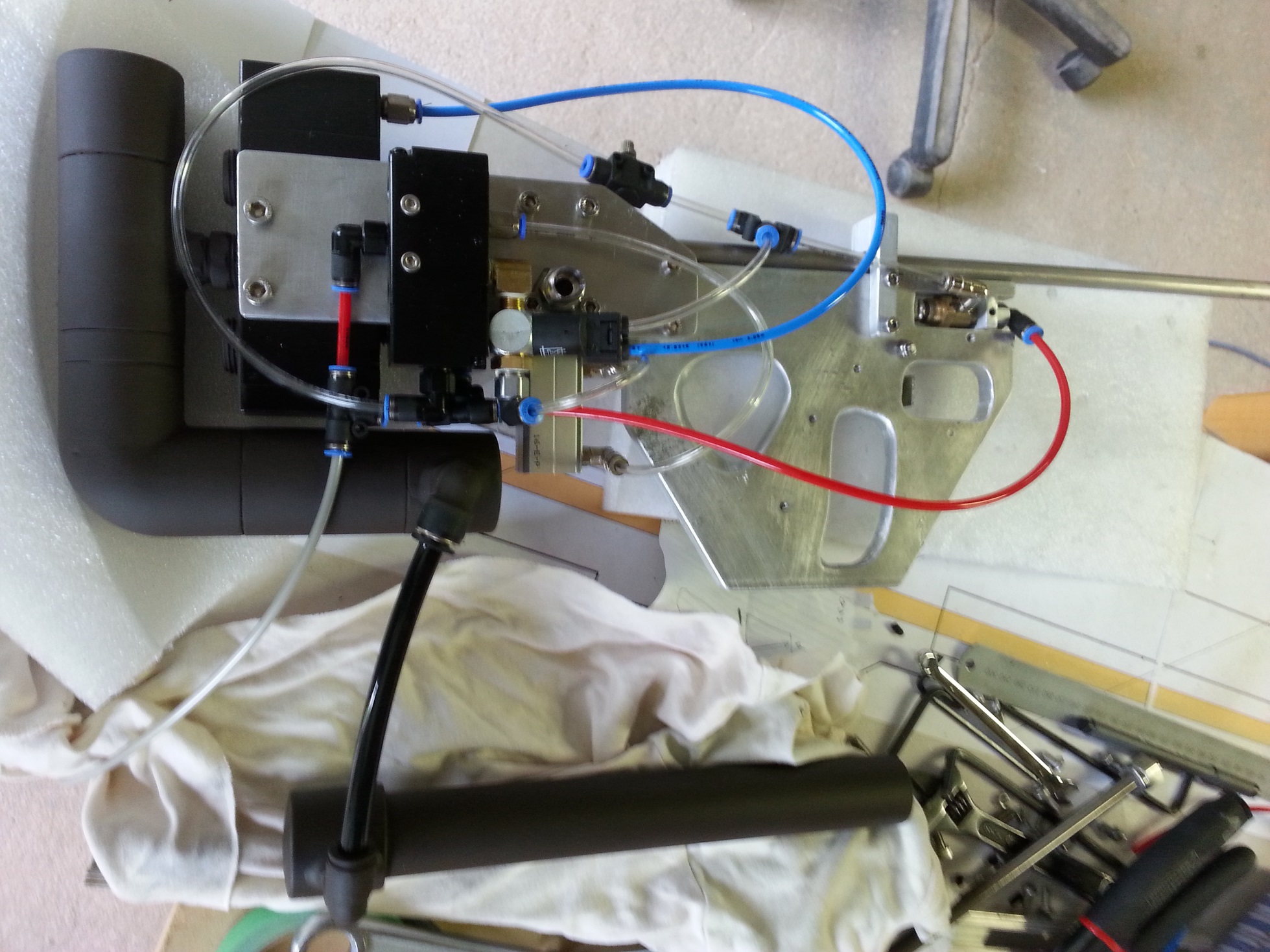

Got enough parts assembled to test fire, the small cylinder will do the reload, magazine tube tube attaches to the threaded fitting on the side.
Re: FAR2017/WA2000
Posted: Sun Sep 17, 2017 2:29 pm
by farcticox1
tidied it up a bit, still got to make nylon grip pads, palm rest & attach the mounting rail for the scope and bipod.

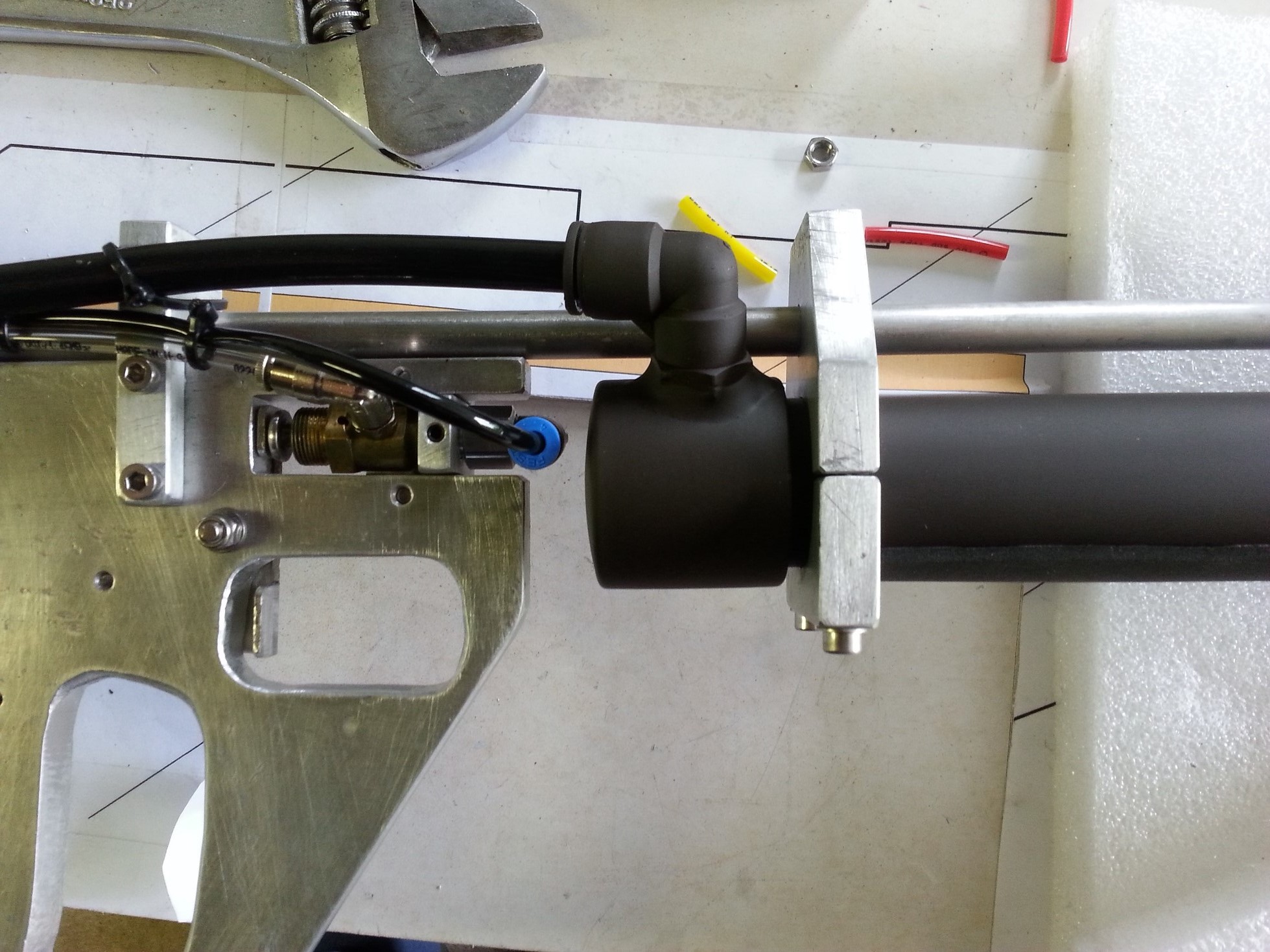

Scope mount finished.

Dropped the scope about 10mm and moved forward 20mm.
One problem I discovered was double feeding, especially when the ammo tube was full, I guess the extra weight was the cause. When fired, some air leaks into the ammo tube and shoots the BBs up, (you can hear them rattle) and because the reload cylinder opened the instant the main valve closed the BBs were managing to feed 2 instead of 1. I put an exhaust restrictor on the reload cylinder to slow it's opening and make sure the BBs have settled before it opens the port. It slows the reload cycle time slightly but does seem to stop the double feed.
