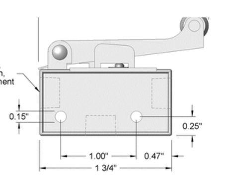

Air2theBrain wrote:New trigger doesn't work sadly, its leaks once air is applied...sure i have my trigger on the right way around...? :shock:
Which type is it?
Re: Help Needed For First Semi-Aiuto Project
Posted: Fri Nov 17, 2017 7:40 am
by Air2theBrain
The picture on mine looks different to the ones you showed, didn't know their were variances in these triggers :shock:
Posted: Fri Nov 17, 2017 7:48 am
by Air2theBrain
I thought it was possibly damaged, etc, will swap attachments over when i can to hopefully hear a difference. :)
I taking a guess here..but it has to be de-energized diverter because its a 2-way? :?
Posted: Fri Nov 17, 2017 7:51 am
by jackssmirkingrevenge
You need to figure out which port does what. The easy way to do it is to simply blow into each of the ports with the trigger in its rest position. The port which is blocked is the one that you will leave unconnected. Now blow again into this port with the trigger pressed. The port where the air exits will be the port that you connect to your QEV pilot. Connect the main air supply to the third port (the one that is blocked when the trigger is pressed).
Posted: Fri Nov 17, 2017 7:59 am
by Air2theBrain
Ah thank you! :P
Had it around the wrong way :roll:
I was going from a forum pic and was certain i had it :lol:
Hopefully tomorrow i find the right spring for the mag feed and attach a barrel. :)

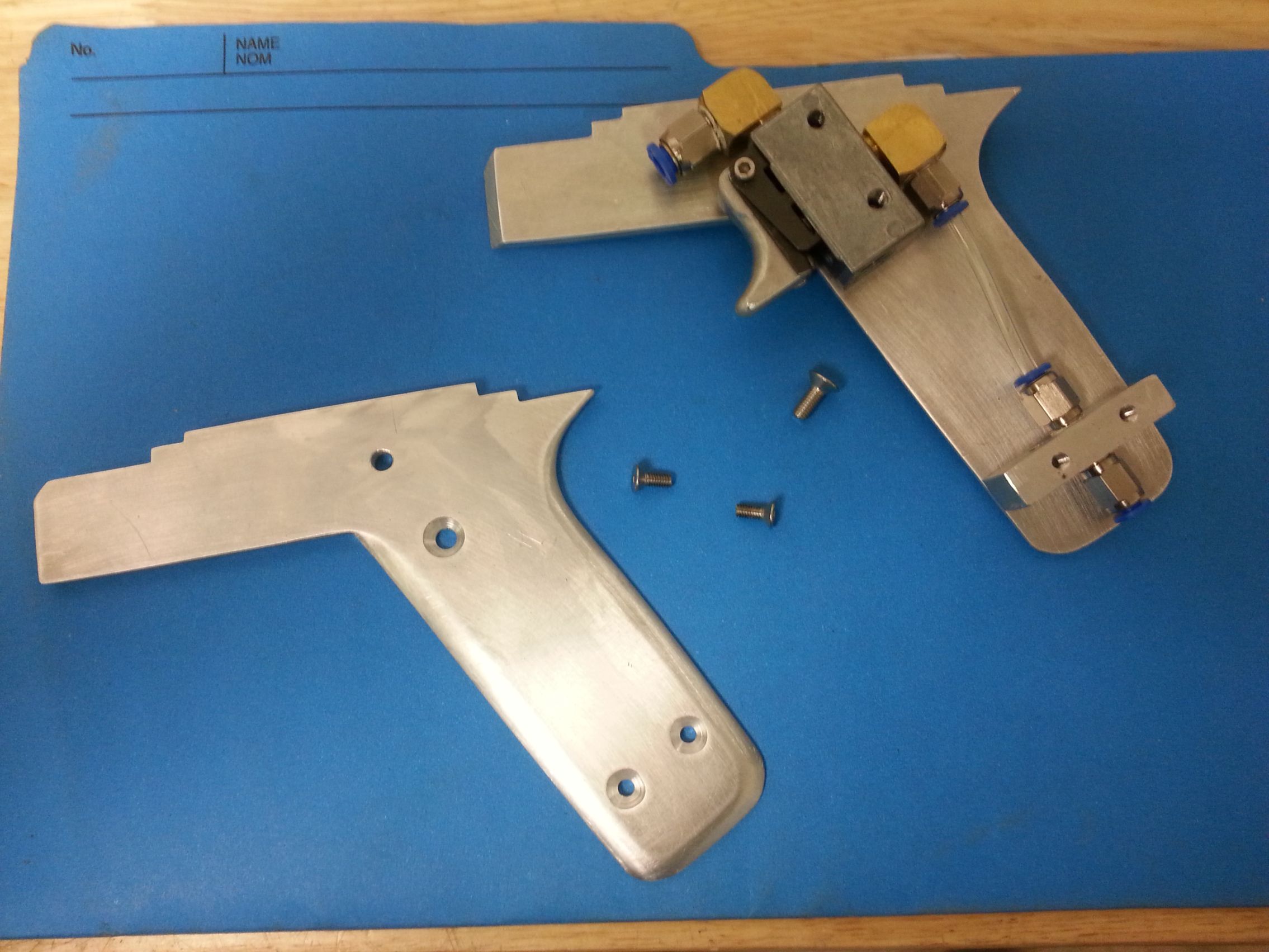

Posted: Fri Nov 17, 2017 5:10 pm
by farcticox1
that must have been a 3 port (3/2) with an internal bleed, eg. no access to it and not able to connect to it. I used a true 3 port for my QEV trigger so I could fill through it as well.

Posted: Fri Nov 17, 2017 7:30 pm
by Air2theBrain
Oh i see how yours is very different. :wink:
Love the trigger set up, looks great farcticox1. 8)
