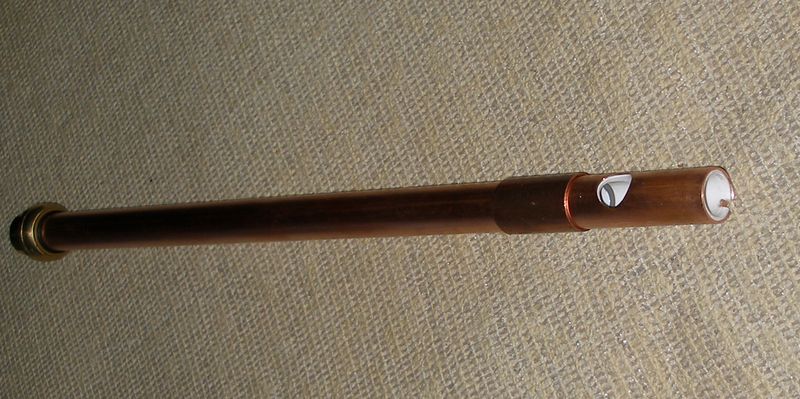

Your post is interesting because I made a new barrel last night of 5/8 bore pvc lining 3/4 copper 17" long. Then came in and started modeling changing the chamber size vs velocity gain %.
I settled on a 6" length of 1" rigid copper for the 100 psi chamber. Then I started bumping up the pressure and shortening the chamber to see what happens.
Since I am using type "M" copper, I can go to 300 psi if I lose the shark-bite muzzle cap. There is a local company which sells the low temp solder Stay-Brite which lets me theoretically go to 500 psi since it won't anneal the copper (if I am careful). Those numbers bump up about 100 psi for type "L".
The copper ratings are from a mfr"s web site.
I'm not worried about the pvc vs higher pressure here as the pvc fit in the copper is pretty tight.
If there are any worries I could also make the joints leaky (I use three pieces) and allow the pressure to equalize inside and outside the pvc liner.
Just as you all predicted, it's pretty obvious: I need more pressure!

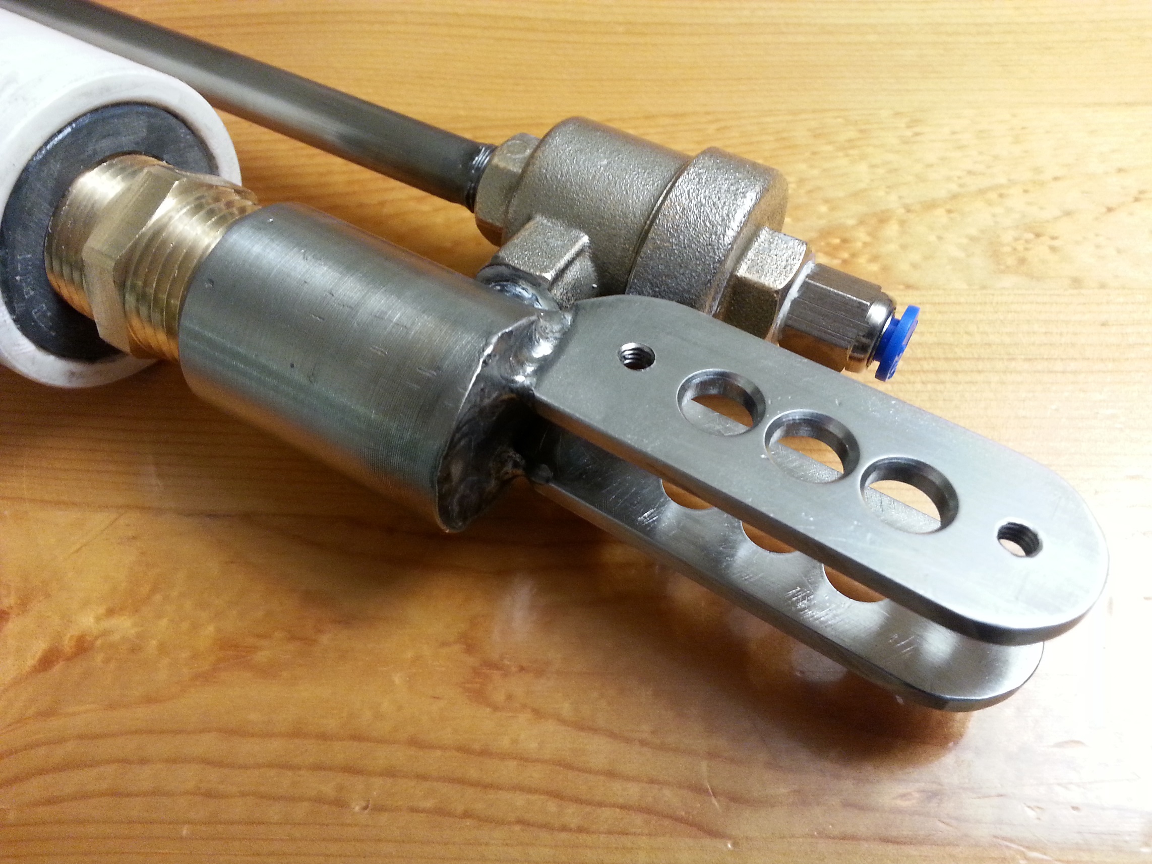

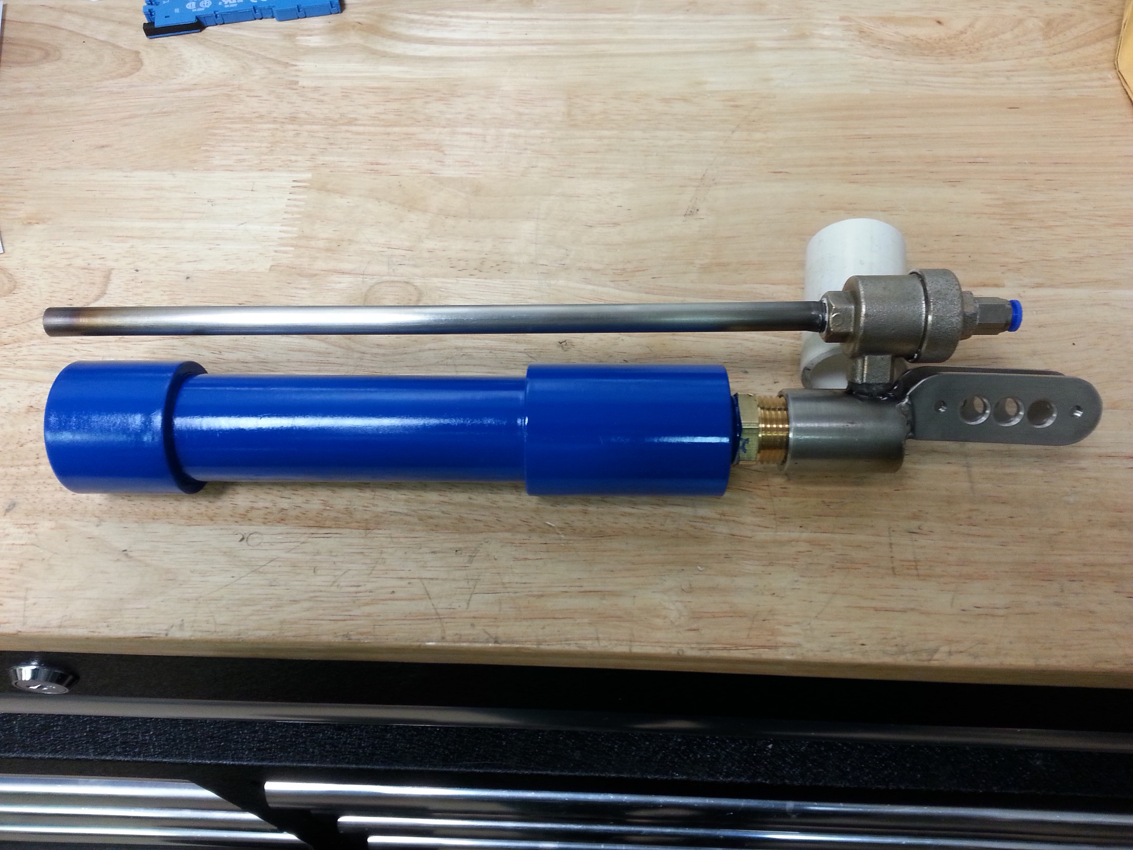

It's a 1/2" Npt nipple with 1/8" thread welded on the top and the end capped off. The flat pieces are to attach the grip.notarobot wrote:Yeah, sometimes the parts dictate the layout.
BTW, love that chamber to barrel ratio.
What is that silver cylinder between the chamber and the QEV?

Thanks for the thoughtful comments and offer to assist.Spudinator said:
There is no question that I know very little about the right way to operate the lathe. A machinist would probably have a heart attack if he watched me one day. A couple of knowledgeable friends have guided me in several areas, especially safety. The basic concepts of a lathe and machining seem rather straightforward. The application of same never quite turns out as well as I planned. But I persevere.
I did try your "cookie" suggestion. It worked (as anyone with an ounce of brains would have agreed), when I needed to ream the pieces of pvc a little more to allow a greater percentage of the gum balls to pass through the barrel. If only pipe was a bit more consistent dimensionally.
The shark bite fittings were removed from service after a maybe a decade. They showed minor signs of leakage, but were in otherwise in good shape. Rated at 200 psi, I figured "why not?".
Agreed, rigid copper appears to be the best bet in the future. The gum balls called for standard 1/2" pipe in brass. This is one case of find cheap ammo, locate a barrel that fits.
Regarding the washer, I made it as easy as possible for the ball to pass through the center by removing material so there were only three points where the washer material had to flex. Even though, the first was too thin and followed the ball downrange in excess of 200 fps. It's replacement is 5/32 rubber gasket material. We will see how this holds up. The newest short barrel has a steel spring "U" to retain the ball. It is still on probation.
I am looking really hard at more pressure. A local bike shop stocks shock pumps, and I was tempted to go there and talk to them. I need to read the Gippetto thread again and think on this.
