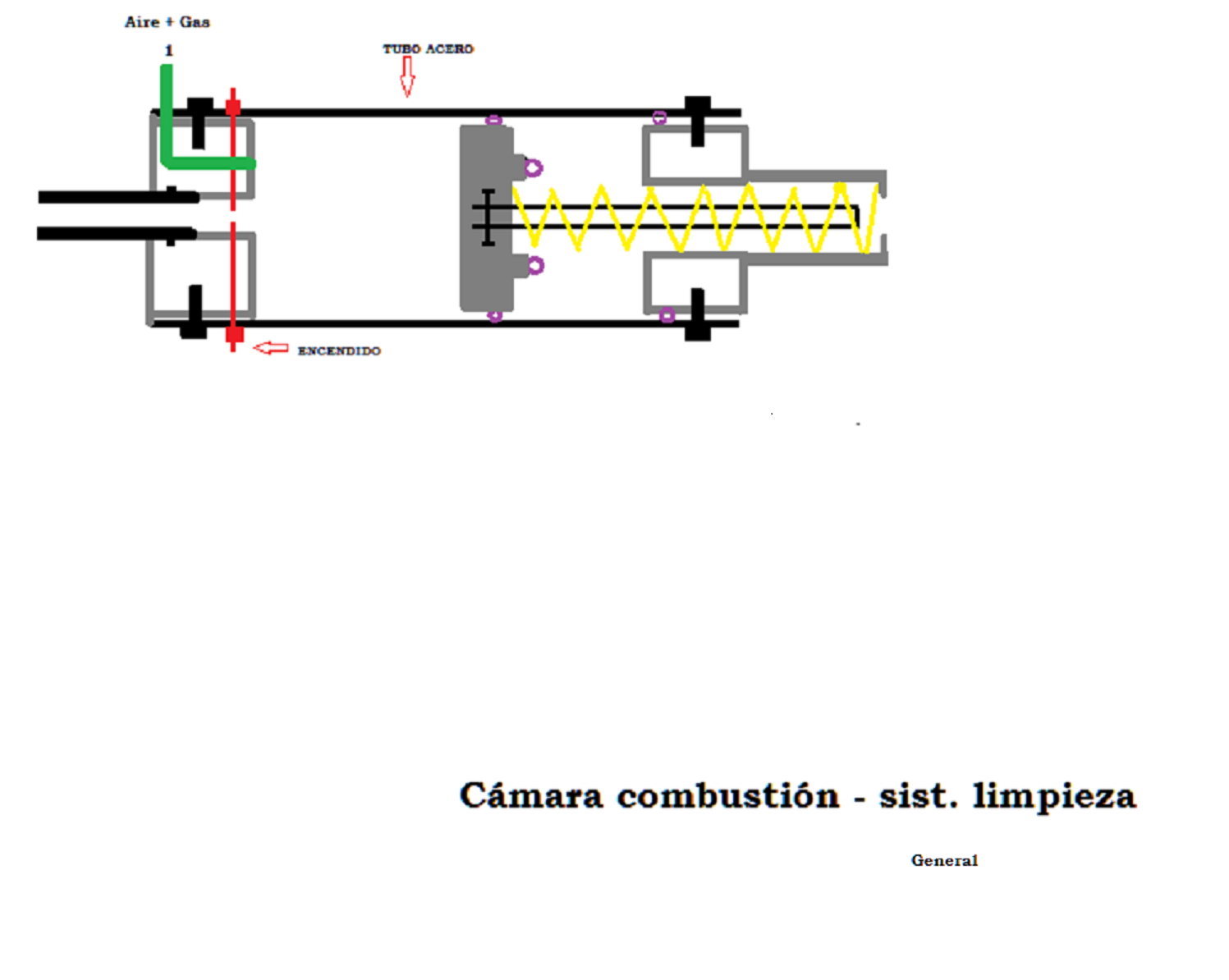

I mean that a combustion chamber of 10 cm3, in my particular case, to shoot at 5X, is very small. A 20X would work very well, solving everything else. I am referring to the system of closing the weapon, piston valve, rupture disc, etc, and the method to completely clean the camera after each shot, and the method to understand the gas and then the air in an almost automatic way, just by touching a button.

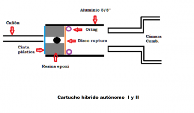

No. The cartridge incorporates the rupture disc, an o'ring for the seal and the ammunition. These are the diagrams:
In my case the heat is a lot. With an ambient temperature of 30 - 35 ºC and firing every 20 or 30 seconds, everything heats up very quickly because heat accumulates. Enter more calories than it dissipates because there is not much time. I shoot rounds of 4 or 5 cartridge and let it cool. The resin gets very bad with the heat.
You can continue with your project here, or open a new thread, as you prefer. I will be attentive to talk about this and help as much as I can.

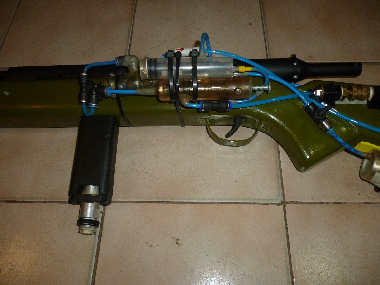

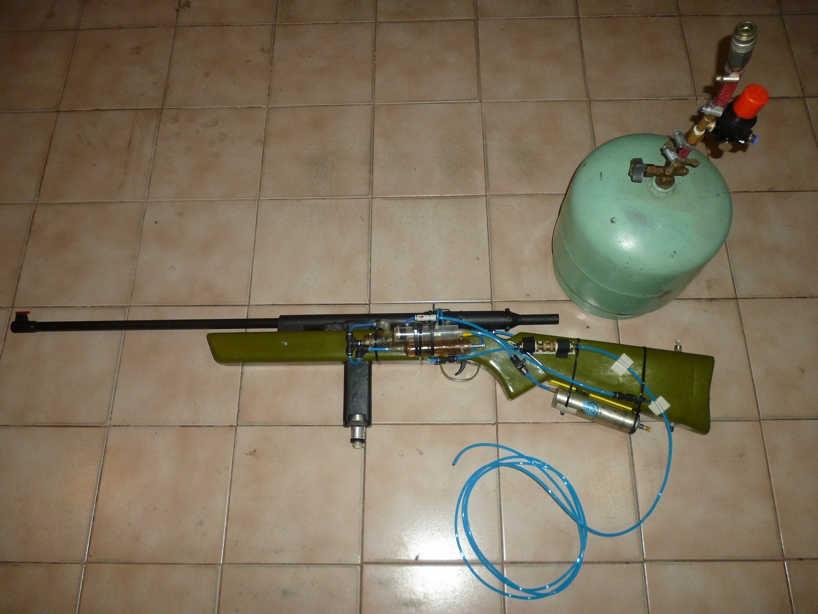

So I am shooting with the dosing unit attached to the weapon and the external air tank. I'm thinking of replacing the woods, (green), to careen everything, and that the appearance is more aesthetic. In this version, I replaced the solenoid valve with a 3/2 coolant valve with exhaust. The cartridge is simply loaded and manually activated by the mixing charge and triggered.
Actually it is a great comfort not to use a manual air pump, but it is more complicated to build.
The air tank has 150 psi, and I can shoot 30 cartridges uninterruptedly, at 6X. It drills two cans perfectly and the noise is little, so a sound suppressor is unnecessary. The noise comes from the objective, actually.
