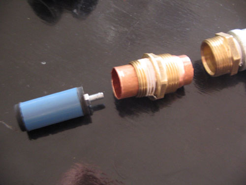

When I blew into the chamber port the piston opened. The washer is bigger than the barrel. Is there no way this can work without a bigger piston? What do you mean by slightly smaller barrel port? ,do you mean I must get a smaller barrel?

It isn't even finished yet, I can do anything more until my mom gets paid next week. My 20mm piston is just going to be the small piston fixed inside the 20mm pvc, which fits nicely in the copper. It has taken soooo long to drill the fitting larger on the inside.

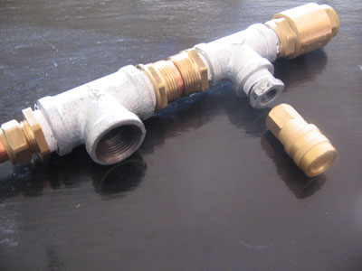

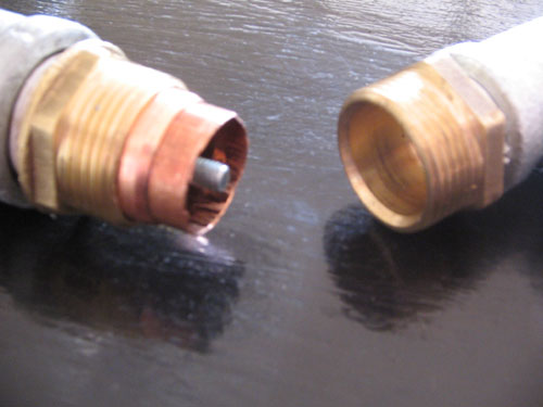

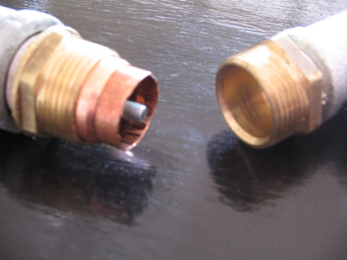

Ok, I have done a bit of work on this again.
Now I have added a bigger piston, exhaust valve(pilot), more galvinized fittings and a port for a female quick disconnect.
As you can see the piston housing after the valve(larger tee) is bigger. This is because the piston is now 20mm pvc. The people at the hardware store sold me irregular sized fittings which I can't get a link for, you can see that the piston housing needs to be linked. So what I have to do is get the two compression pieces and drill out the lip so the copper ring can still be there, then silver solder them together to make my own link. Too bad I don't have the tools to do that so I will have to find someone with them.
I have kept the space behind the piston to a minimum and it should work fine.
Check out the pics.
Check out the pics.

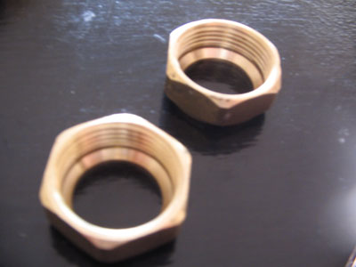

- These parts are going to be the link.

- Things are progressing nicely.
Seen here is everything put together. - update-1.jpg (19.42 KiB) Viewed 4228 times
