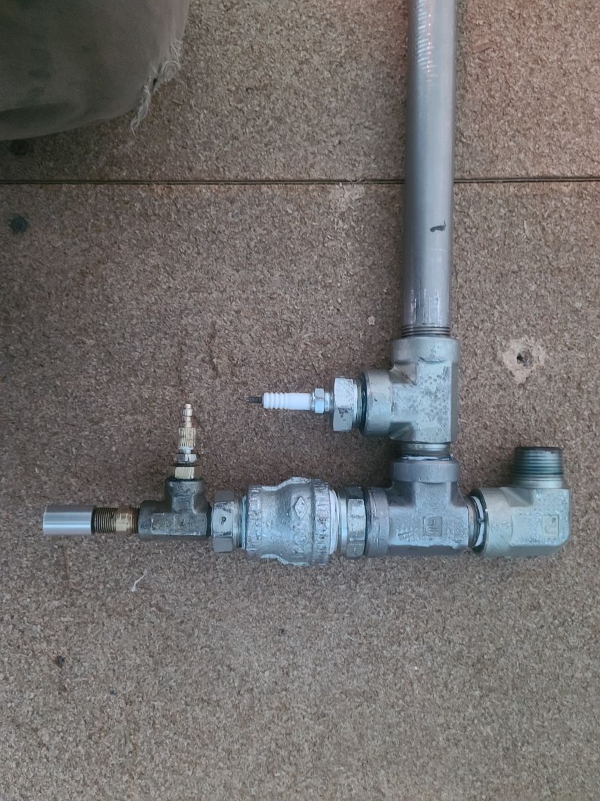

So you guys were on the money. I was lean for sure. I think higher mixes helps aswell. I have been successful up to 30x with roughly 20psi propane 420psi air. Now it seems to be on par with the phenumatic counterpart.
I do intend on mounting it on a stock or something of the sort. Like a bulpup configuration. So I rearranged the components so I'm not staring down the relief port any more.

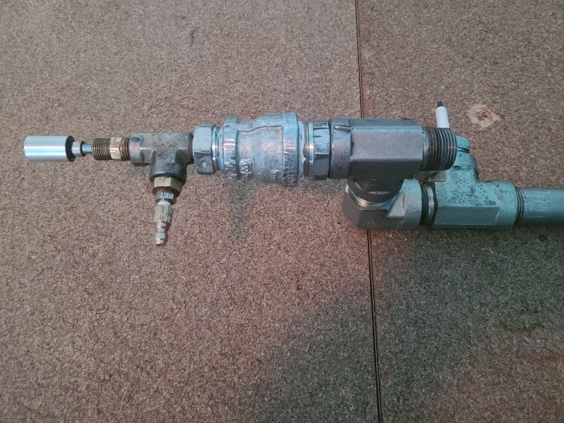

I have ran into an interesting problem... moisture from combustion is condensing in the spark gap. If I get 2 misfires in a row I pull the plug, and sure enough there is a micro droplet of water bridging the terminal. It happens quite frequently. Unfortunately if I open the gap any further the spark plug will arc from top to bottom opposed to in the chamber at 30x.
Has anyone else experienced this problem?

PracticallySane wrote: Mon Dec 28, 2020 8:14 pm I have ran into an interesting problem... moisture from combustion is condensing in the spark gap. If I get 2 misfires in a row I pull the plug, and sure enough there is a micro droplet of water bridging the terminal. It happens quite frequently. Unfortunately if I open the gap any further the spark plug will arc from top to bottom opposed to in the chamber at 30x.
The same thing happens to me, sometimes. In my city, the north of Argentina, the climate is extremely humid and hot. On very high humidity days, the first shots sometimes miss. It seems that when the camera takes some temperature, the problem disappears. With my air compressor, in my workshop, it is the same. When I use it, when I finish doing it, I have to draw water through the bottom plug, and it is quite a lot. In short, shit! :( The same thing happens to me with a pneumatic airsoft gun, self-built, all rust in the air chamber ...
The solution for me is to heat the chamber, or the spark plug, a bit so that the water evaporates.

I was hoping to find a solution to avoid removing the spark plug. I am also putting some thought into a glow plug ignition instead. Trial and error...
I was even debating placing a "silicon desiccant pouch" in the chamber to absorb excess moisture.. I figured it would end up fired out the barrel so I have not messed with that yet.

Argentina
Posts: 1064
Location: Argentina
Has thanked: 274 times
Been thanked: 276 times
You may be able to direct the air - mixture inlet towards the spark plug contacts. A little air with some speed might do the trick. My combustion chambers are no more than 10 cm3, and I have the gas inlet stuck to the spark plug contacts. Matter of testing.

That is a very good idea! Not bad at all, I think I will give that some kind of effort. Many thanks.
I’m a scientist; because I invent, transform, create, and destroy for a living, and when I don’t like something about the world, I change it. ~Rick Sanchez.
PracticallySane wrote: Wed Dec 30, 2020 8:28 amI was even debating placing a "silicon desiccant pouch" in the chamber to absorb excess moisture.. I figured it would end up fired out the barrel so I have not messed with that yet.
There are commercially available solutions that you can attach to your pump: https://www.pyramydair.com/s/a/Hill_Scr ... kring/1141
Failing that it should be relatively easy to make an inline filter containing some desiccant.
