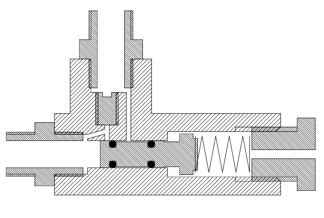

This regulator was designed to be manufactured with inexpensive precast bronze parts, available anywhere. Does not use lathe machining for metal. The two grooves for the two o'rings are made on the domestic bench drilling machine and a small file. It can be put together in a couple of hours ...
What you are making is something much better, in terms of finish and resistance, I like it!
The regulator works very well.
I think that if the piston is twice the diameter, there will be more force produced by the air in this piston to more easily overcome the drag force of the o'ring.
Example:
Diameter = 0.6 cm
Perimeter = 1.88 cm
Area = 0.28 cm2
Pressure = 3 bar
Force = 0.84 kg
Diameter = 1.2cm
Perimeter = 3.76 cm
Area = 1.13 cm2
Pressure = 3 bar
Force = 3.39 kg
In the first case, the relationship between the drag force and the force exerted by the air on the piston is 2.
In the second case, the ratio is 4. Undoubtedly there is more energy to move the piston, and overcome the resistance of the o'ring. It is an approximation that assumes that the two o'rings are of the same thickness and that the resistance to rosing is proportional to the amount of rubber that has contact on the cylinder walls.
I incorporated a small additional spring as in the drawing, and I can regulate to less than 1 bar, without touching the main spring on the right. It works well, and it will not be necessary to redo the entire piston to be able to regulate the outlet at very low pressure
Good luck with your project and we look forward to seeing your finished work. Greetings

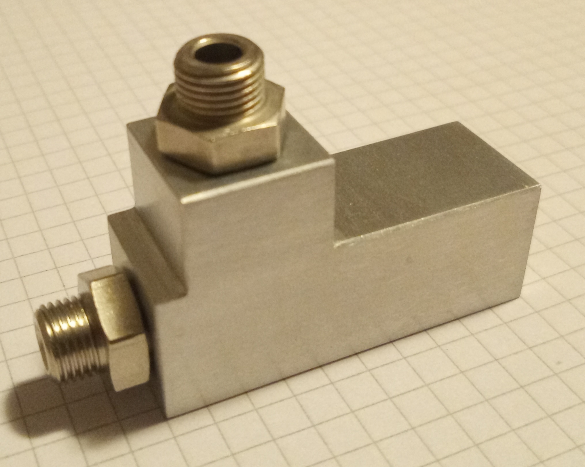

I just finished making the v3 based on hectmarr's design. This is the final arrangement:
The body is 2011 Aluminum, just so it would be easier to machine. Both ports are threaded for G1/8
Piston is 5,8mm steel rod with 3x1,5mm (6mm OD) O rings
The test rig:
It gives a near constant 6bar output as long as the inlet pressure is below 12bar. At anything above 12bar, the piston starts failing to move into the closed position and slowly lets the full inlet pressure into the outlet. I guess O ring friction under higher pressure is just too much...
I might make the v2 design next and see how it behaves. Maybe both designs would work best in a two stage configuration.
