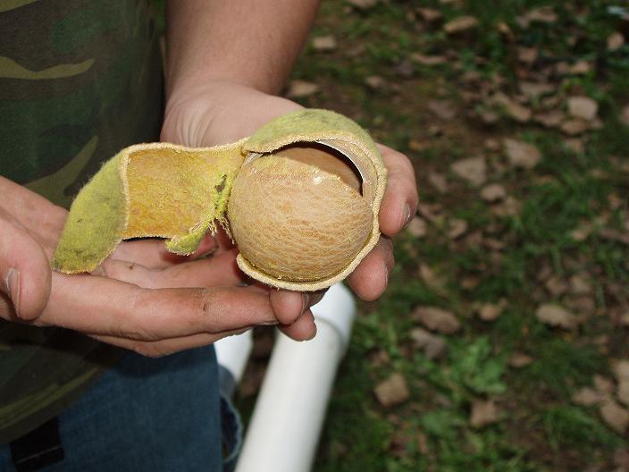

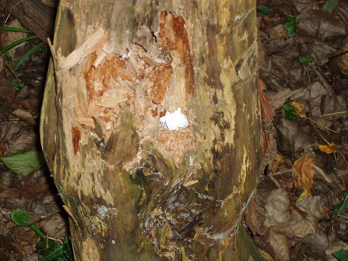

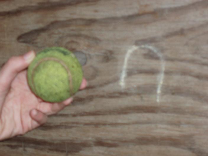

So here are some more pictures. The first two are of what the first prototype did to a tennis ball and a 3/4" plywood board. The next is of what the valve does to stumps with golf balls.

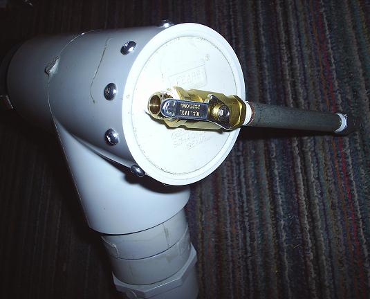

This is what I have been using for "shop tests". Since I have relocated my building space to my workplace where there is a much cleaner environment than a shed and more and better tools, I need something that will work to test valves that doesn't make too much noise or power. The chamber on this is a whopping 18 ci including the chamber volume in the tee. The barrel is about 16" of SDR. I bulit a trap for projectiles in case I feel like shooting stuff. This setup is more powerful than sprinkler valves guns I've shot with much much larger chambers and barrels. It gives a 10 second hangtime. Remember, 18 ci chamber.

The pilot you see on there is a 1/4" 3 way ball valve (smaller diameter than standard 1/4" ball valves). There is a male QD on the pipe nipple where the compressor hooks up to. Turn the arm to the QD and it fills. Turn it the other way and the pilot dumps. It will pilot through the QD too if the hose is disconnected.
So what do you guys think?

I am really impressed with the performance of this valve! Was the stump rotten or hard?

Funny you ask about the log. Spudstuff asked the same thing on Spudtech a couple hours ago. It is old and dried out but I wouldn't say it is rotting. It's kinda in the between stage but I still think it's impressive. It rips the bark off live trees easy though.
