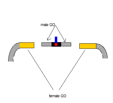

ok guys im back before an hour because i tried the qd valve (quick disconnect) and when i pull off the qd it just dumps the pressure....i was wondering how u r supposed to use a quick disconnect without activating the valve because it is just a straight hole through the disconnect no stop or anything in side....how are u supposed to use them??leave them on and pump running while u fire????

Ball valve after the QD,close the ball valve when filling is complete then disconnect QD from gun. The welding also ruined my paintjob I just went over it with red zinc spraypaint and its as good as new.
well the male QD has no sealing mechanism, so you have to A:but a check valve inbetween, B:use a ballvalve, or C: have a female QD hooked up to the gun, and a male to male QD setup and then have that go into the female QD on the compressor. one of the female QD's will go into the gun.
