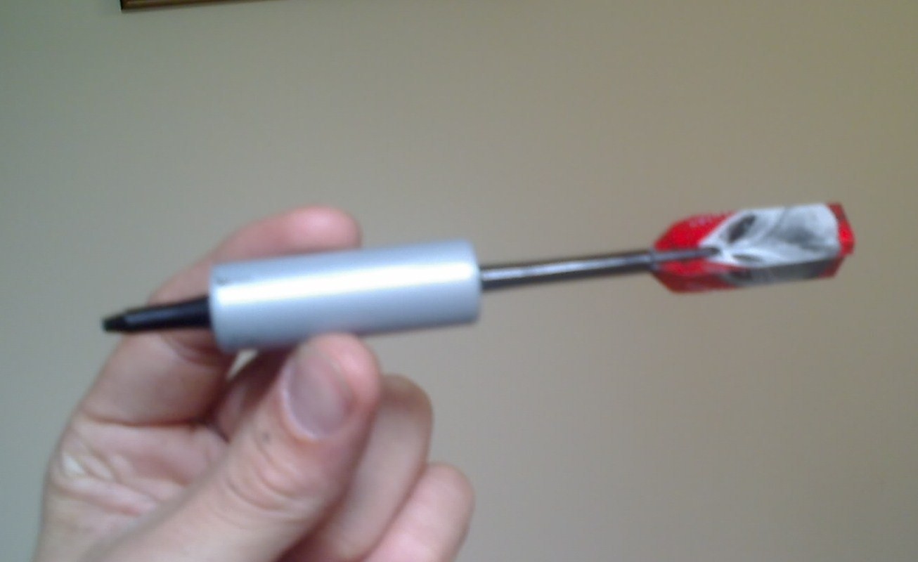

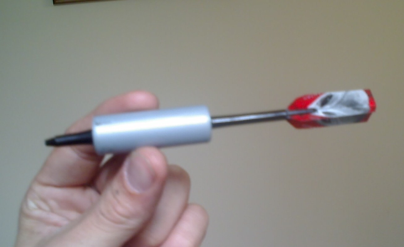

@ mr nickname
something like this maybe??

Yep Fore
Dart projectiles or projectiles with a forward center of gravity are the way to go (foster slugs etc).
