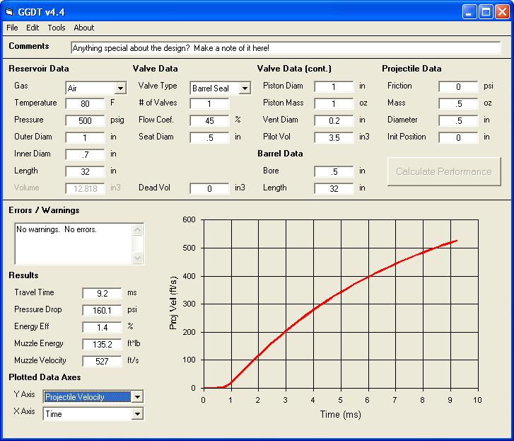

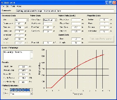

No Iknowmy3tables, what I mean is, by having less shot to a round (load fewer BBs) each piece of shot will have a higher muzzle velocity, meaning more impact down range.
And no a BBMG would not have the range.
Here, I believe that something like this might work:
