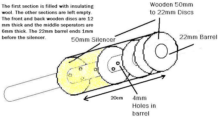

What you need is a section of the pipe you used for the barrel, and a wider length of barrel for the silencer body.
This design was posted by LucyInTheSky and should work very well:
You could either build it on your existing barrel, or make a separate unit if you have a means of attaching it to the barrel.

Not a good idea at all in a spudgun, simply because they don't have the spare power in reserve - but we're not playing with the tens of thousands of psi that firearms develop, and the vast majority of spudguns are subsonic anyway, so there's no need to resort to such drastic measures. A conventional silencer with baffles should do the trick in the most cases. The key here is that as with engines, there's no substitute for cubic capacity - the bigger the silencer the more effective it will be.
