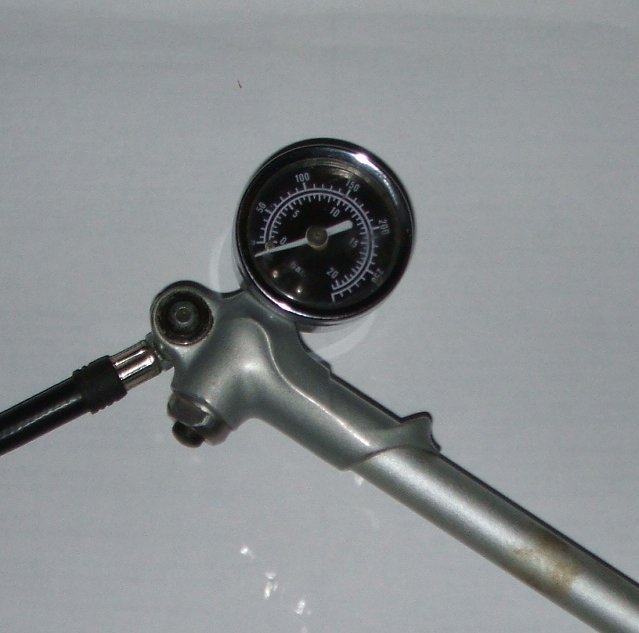

I'm using a presta in mine at 240psi and I'm likely to be using it at 300psi too when I get hold of the right kind of pump.
What are you using to get 400psi?
Good to know, though I think I'll stay with the schrader for this one, don't feel like hacking it up. This is the pump I have:
the 400 psi figure is assumed, gauge only reads till 300 (for spartaaa!) but I keep on pumping until the needle hits the stop (see attachment)

shock pump at 400 psi, thereabouts :)
