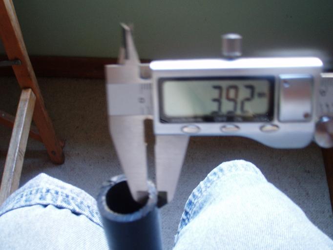

Ever looked at the wall thickness of pressure rated and non pressure rated?Pressure rated ABS pipe in 3/4 size has a wall thickness of 3.92mm,that is as probably as thick as wall as on your 3" ABS non pressure rated pipe.I'm not attacking ABS as a pipe just the non pressure rated kind being used in pressure situation.

I can't agree with you there, the two pipes are completely different in how they are made and our thick they are and even their shape and socket depth is different as you already know.SpudBlaster15 wrote:What is the difference between pressure rated and non pressure rated pipe? Exactly as the name implies. One type is tested, the other is not. Otherwise, they are virtually identical.
And thats just PVC, with ABS if its cell core its not even structurally the same, as you know its got air bubbles in it like foam.
