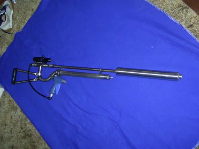

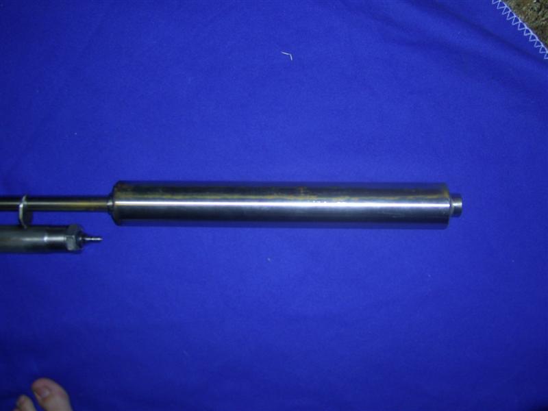

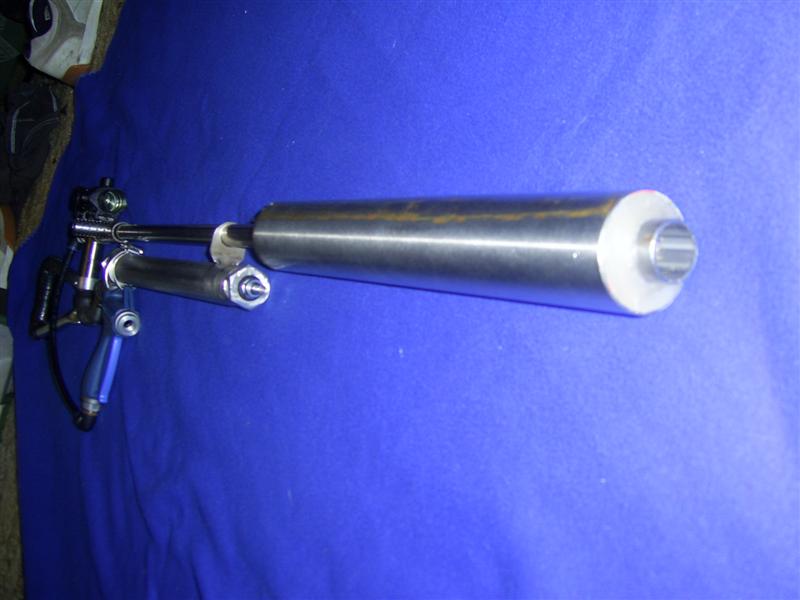

well i set out and made a bigger better silencer, and i did test it for yas.
its 2" outer tube and a 3/4" barrel and yes back to metric its 470mm long, i used slits instead of holes and it seems to work really well.

thats awesome chaos il be allot safer shooting ur gun off now specially at the high pressures 8)
Posts: 26220
Been thanked: 352 times
sweet! shame you didn't do this before contest voting was over, it would have increased the "wow" factor considerably.
You should have made it the same I/D as the barrel, it would have been more effective. Sorry to be so pedantic, nice effort :D

yer true but i had no compression fittings of that size just laying around, but hey it works so im happy.
still i think it may have increased the "wow" factor there weren't to many people interested int voting for "old Tech" :? ah well the comp doesn't matter to me it was my first and probably not my last.

Wow is definitely right,that looks sweet and sure does look like it will suppress the sound fairly well(haven't watched the video yet)
Does that add excessive weight to the front of the gun?Can it be removed or is it welded there?
Watching the video,that gun still seems quite loud but the camera is close to it while its being shot.

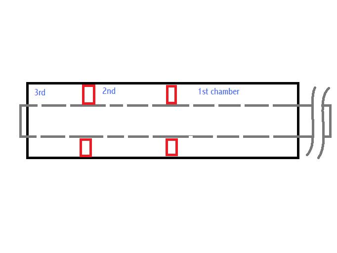

Here is a cross section of a silencer with chambers much like some used on guns,the grey is the barrel wiht holes/slits in it the red are stopers to block each chamber off from each other.If your silencer is removeable you could easily add something to add chambers to it.Couldn't you?
Here is the design.
Yes im sure i could add chambers to it and yes it is removable, it adds a bit of weight to it but i can handle it without bitching about it, i can shoot it at 200psi and not worry about a headache anymore (its F***ing loud with out it)
ill keep on working on it and keeps ya's all posted on its current stage of improvement*
