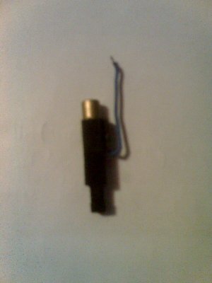

better one get an empty glue stick big or small drill a hole in the middle of the twisty thing at the bottom (this will also remove the central rod) you may also find the twisting bit will separate from the tube. a bit of glue will fix this
get a little black sparker out of a reusable lighter hot glue, super glue or epoxy it in the hole let it cure
ready to fire remove the end cap spray in propellant as hi said wave it around put the cap on press the igniter in the base and the cap shoots off
great fun and pretty harmless if used properly
