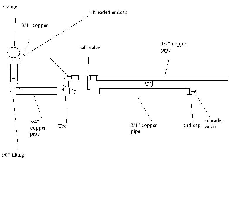

Thanks turbo, but the thing is, im afraid the pvc will explode so i'll probably stick with copper the whole way.
Well, since this is going to be my first cannon, i'm going to make it simple. I'm going to use a schrader valve and probably a ball valve. Is there also an alternative to a ball valve that can hold a lot of pressure? If i do use a sprinkler valve, i don't know which one i can use or not. Also, do i need a blowgun for it? I will be going to Home Depot later today. I would like to know what brand and type of sprinkler valve i should buy.
Thanks

o ok, thanks. Since this is going to be my first pneu, i think ill jus use a ball valve. Then later, i use sprinkler. Thanks. Also, for the gauge, will any pressure gauge work? Thanks
edit:: Here is what i want to make my cannon look like.
Also, was wondering how long the chamber should be when i have a 26" 1/2" barrel. Itd be nice if you can tell me what the lengths should be. Thanks

Ok, thanks. Ill think about using one. Can someone help me show how long the pipes should be when the barrel is 26 inches? Thanks
Jumpin Jehosaphat
Posts: 188
Joined: Wed Jun 06, 2007 8:20 pm
NoXi wrote:Ok, thanks. Ill think about using one. Can someone help me show how long the pipes should be when the barrel is 26 inches? Thanks
Remember this for future use.
It's easy to figure out what lengths of pipe you should use to get the C:B ratio you want (Unless you are trying to be super exact, then it is hard)
Pipe measurements give you the diameter of your pipe, you need the radius, so divide it by 2. (radius of 1/2" pipe is 1/4") Once you have that plug your numbers into the volume formula.
V= pi X r² X L
The approximate volume of 26" or 1/2" pipe can now be found.
V= 3.14 X (.25)² X 26
V= 5.1 cubic inches
You know the highest you want your C:B to be is 4:1 which means your chamber is 4 times the size of your barrel.
So, the largest chamber without being overkill is going to be 4 times the volume of your barrel
5.1 X 4
20.4 cubic inches.
Now work the volume formula backwards for pipe with diameter 3/4" (radius is .375")
V= pi X r² X L
20.4 = 3.14 X (.375)² X L
20.4 = .441786.... X L
L= 46.22
This means the maximum amount of chamber pipe you want you use is about 46" and a C:B ratio of 4:1, if you want to figure out how much to use for a different C:B ratio, just do the same thing I did.
