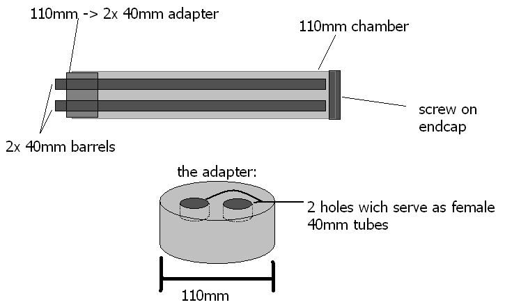

Damn, this double barrel rocket launcher idea was in my head last week!
They only problem is: How will i make a double barreled (coaxial) combustion.
My idea was to have one 110mm pipe as chamber with 2 40mm pipes in it as barrels. Here in the netherlands they have a REALLY nice adapter for that. (110mm -> 2x 40mm and its flat, not sloped down)
But now how would i do that?
Is it possible to fire 2 barrels with one chamber?
Or could i make something to divide the big chamber in 2 (in the length!)
i dont know it yet...
Edit: added design picture:

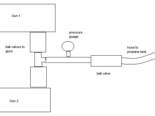

Noname has the right idea with the propane system.noname wrote:Well, just a little input, but if the two guns are the same size, you could make one propane meter for it, with a ball valve going to each gun.

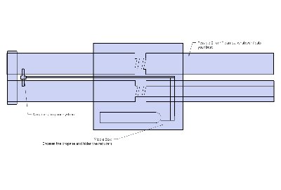

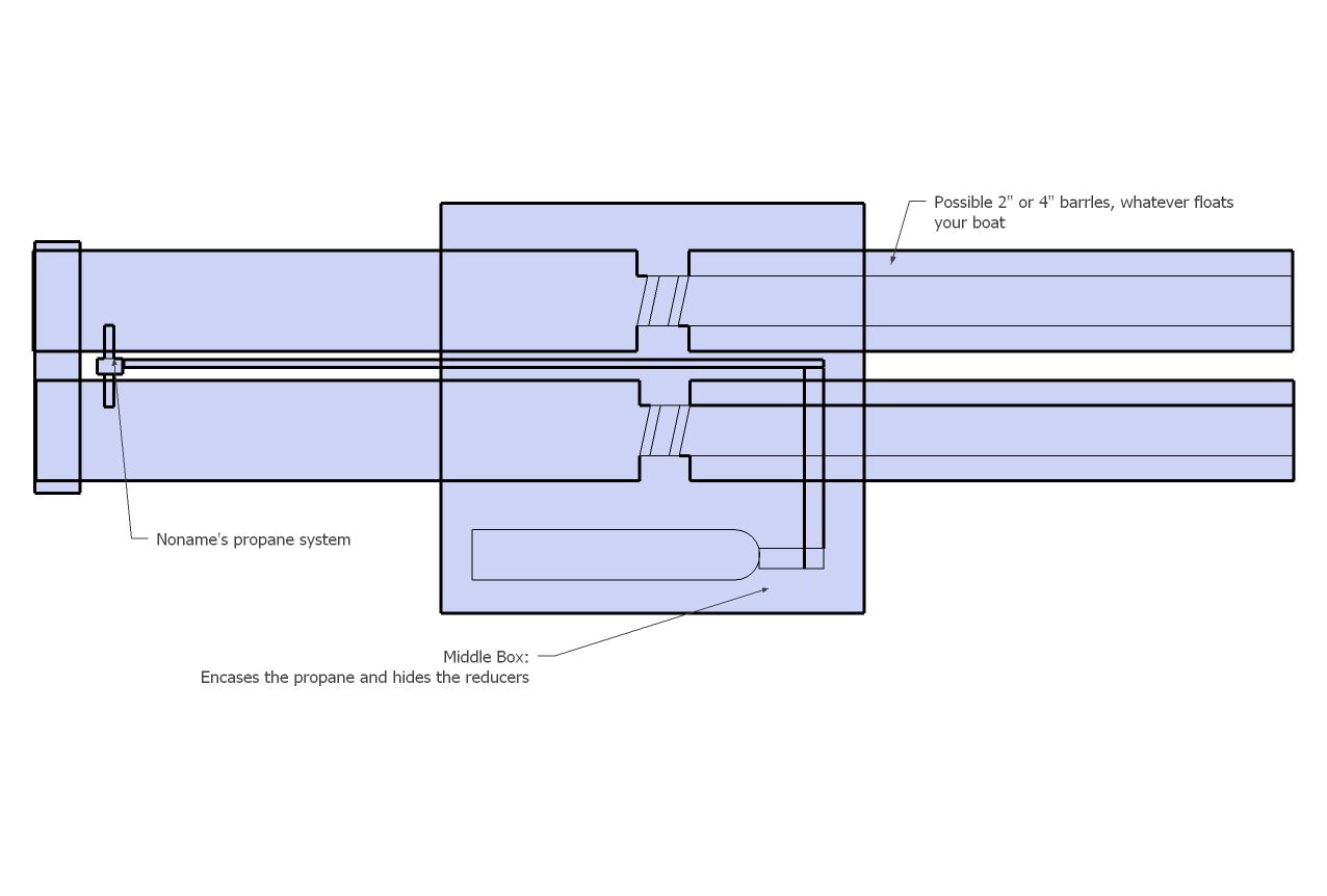

You might be able to set it up like this: See picture
The slanted lines in the middle indicate male/female adapters and possible reducers
Maybe it would be wise to change the ball valves into check valves.noname wrote:Well, just a little input, but if the two guns are the same size, you could make one propane meter for it, with a ball valve going to each gun.
They you wont need to keep turning them on and of AND can they be build somewhere inside.

thanks for the drawings. they help tons! i think i might just use that system. It will really depend on how heavy the whole setup is with or without the tank,and how easy it is to house the tank

looking at this picture might have just let me figure it out....Kufive wrote:Noname has the right idea with the propane system.noname wrote:Well, just a little input, but if the two guns are the same size, you could make one propane meter for it, with a ball valve going to each gun.
