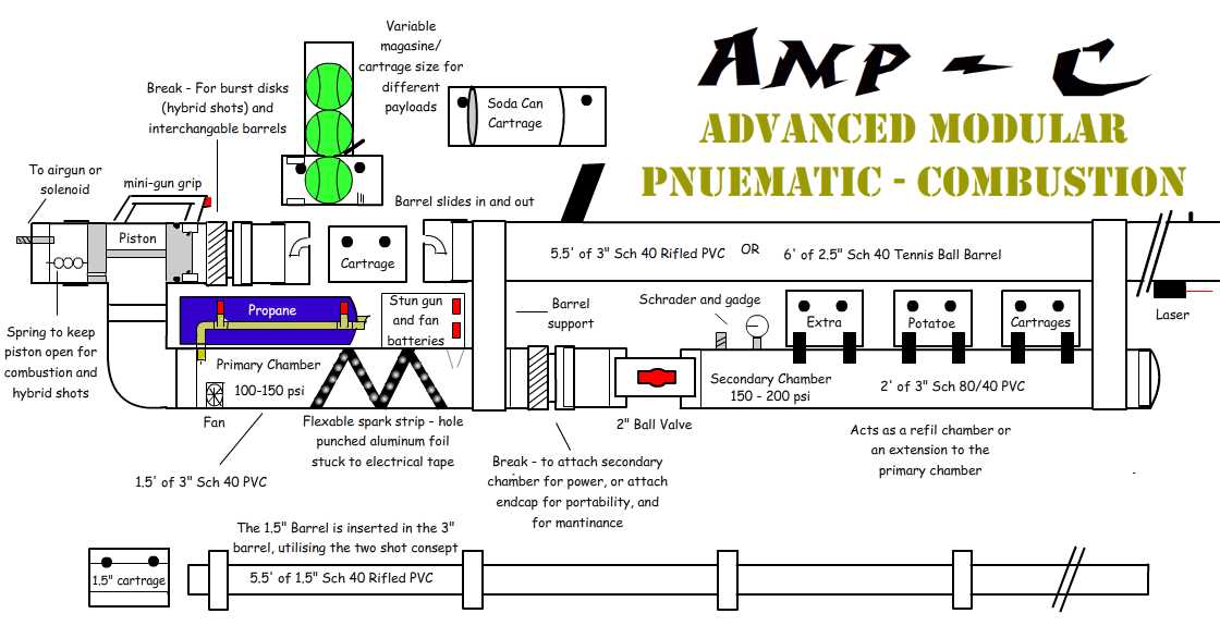

That sucks though a 2" ball valve is 50 bucks
- iPaintball
- Corporal 2
- Posts: 695
- Joined: Sun Mar 04, 2007 8:37 pm
Only if you buy a brass one...
I know for a fact that they sell precut and 10' lengths of pressre rated 3" PVC at HD, if your lookin for it.

But you're gonna need a brass one if it's planned to hold 100-150psi

PVC ball valves are rated to 150 psi at 73 degrees.

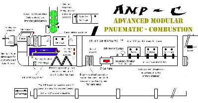

K, thx Fnord for the ideas! Here's the new pic; it is lower quality, but 1/5th the size of before. I also updated the pic on the first post. Its almost perfect quality, but half the file size.
Steve, a 2'' ball valve is 10$ online. It said rated to 225 psi, I think, but that was test pressure. 150 "working pressure" - I guess thats the number I need, huh. And yeah, at our HD I saw 3" pipe rated to 250 psi. (I Think?)
http://www.flexpvc.com/cart/agora.cgi?p ... lValvesFPT
I might have to go with brass and sch 80 to be safe, though. Origin, I heard of using a fire extinguisher, but I have not looked into it. A possibility, though.
My gun is basicly a hybrid with a piston, so i'll get some ideas off the hybrid page.

Not at my Home depot.iPaintball wrote:Only if you buy a brass one...

I just notaced a couple problems wwith my new designs.
1. When I fill the Chamber from the pilot, it would fill both tanks, or just the front one. Meaning I would have to empty the primary chamber to do a combustion.
2. When I shoot the first pnuematic shot, the pilot empties, and needs to be refiled. However, in refilling, air leaks around the pilot, unless I put an O-ring around it. Also, this would mean I have to pressurise the tanks and pilot separatly.
3. How am I gonna afford a compressor that reaches to 200 psi? Or should I make the second tank much larger than the first so I don't have to get the pressure up? Maybey if the primary was 1ft, and the secondary was 3 ft, I could pressureise it to 150 psi.
Questions
1. Will I be able to find 2.5 inch fittings for my gun at a reasonable price. I am leaning towards a tennis ball barrel.
2. Basicly, I do not want a decrease in preformance for the second shot. If the tanks were the same size, and same psi, would I loose power? The second shot would have the same volume of air, but lower psi.
3. And last, should I make other posts with the ideas from this thread? Like the magazine cartrage? In its own way, I think it is a better idea than the "preloaded pnuematic cartrage" idea.
jk. Much easier, the only diference is that the tanks are not in the cartrage.
Questions

Thx for the help and relpy, frank. I might hove to use that site.
