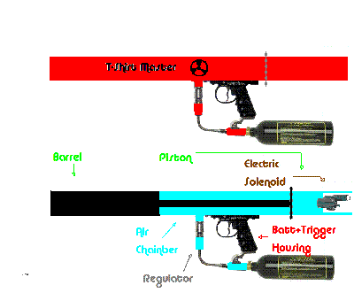

Build something like this...

I'm fine with pushing a button. So Can somebody list what is needed to build this?
