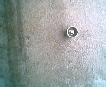

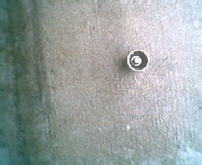

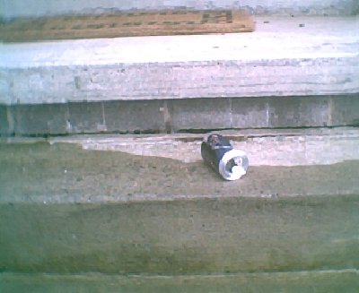

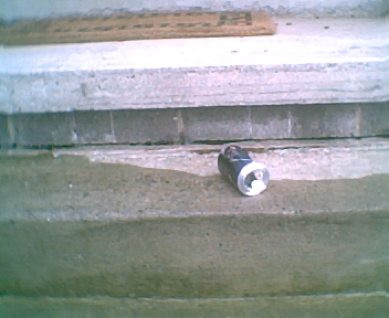

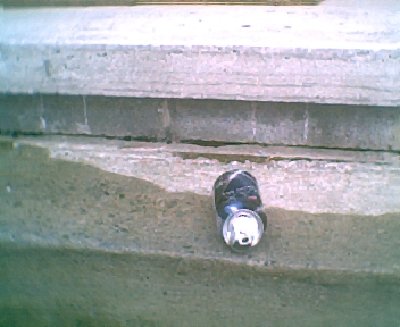

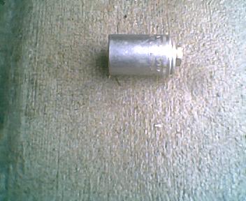

here is the new ammo and damage it does
ammo 2.jpg (20.08 KiB) Viewed 2653 times
spud yeti
Posts: 1030
The ammo looks pretty cool, but how far away did you shoot the can from?
really good quote/phrase here
666lucky693
Posts: 169
Joined: Sun Dec 03, 2006 5:46 pm
point blank so i didnt lose it it went the whole way thru and bounced back so it could do more damage but right now i cant do much the pump broke again and will only go up to 100 psi so yea once i get a better pump i can show what it really can do i will try to get it up to 300 psi it should do better at that pressure

Do you use a sabot with that ammo?
666lucky693
Posts: 169
so u dont think it will hold up at 300 and i dont sabot the ammo it fits perfectly in the barrel and i put the bolt and washer to keep air from going thru it

What exactly is that ammo? Have you ran it through GGDT to find out its velocity and muzzle energy?
