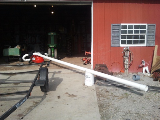

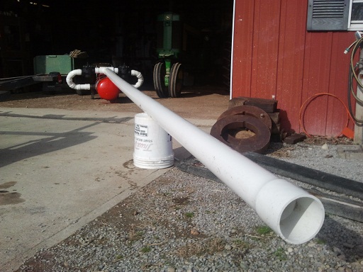

I did a quick mock up of the cannon. The trailer to which it is going to be mounted is in one of the pictures on the left. The "sweeps" are not permanent.
Crna Legija
Posts: 2333
Location: australia
looking good, but why didn't you put the ports on the same side of the tank. would have taken out 1 turn, still looks like it can do some dmg

With the PVC barrel, you could do an in barrel chrony shot to optimize the length of the barrel.
That thing is a beast..

-_- wrote:why didn't you put the ports on the same side of the tank
I was worried about the integrity of the welds of the pipe to the chamber, so I put the whole pipe through so that any forces outward would negate each other, rather than having two nipples facing in the same direction that do not have any backing. The pipe is weight bearing.
And Technician1002:
I will have to trim the barrel at least 3 feet to get it to mount to the trailer without hitting the truck.. so barrel optimization will probably be one of the last steps.

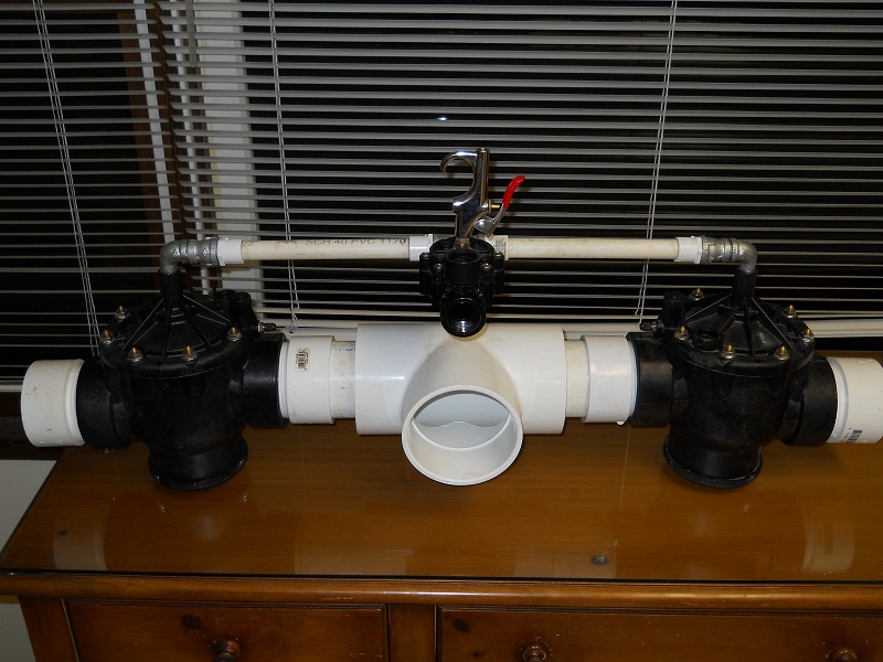

Here is the complete valve and trigger assembly.
Gun Freak
Lieutenant 5
Lieutenant 5
Posts: 4971
Holy crap that's a monster.

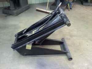

Here is the hydraulic hoist I am going to use (unless someone decides to use it for a dump trailer - my dad - before I get to it). It should work well.
Posts: 3643
Been thanked: 62 times
Hmmm, just read you had an acetylene torch.
I would air on the side of caution when bending PVC for that purpose, since they will be fully pressurized for longer periods of time than if you had left the valves at the compressor and used the "sweeps" to connect to the barrel.
I would suggest that, whatever you do, you pressure test remotely. Sure, those pool guys use bent PVC in spa systems, but that's a longer radius bend, and at much lower pressures.
If you want to solve both the pressure rating problem, and how to keep your valves supported better, miter cut and weld some steel pipe into the shape you need.
