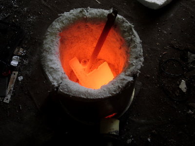

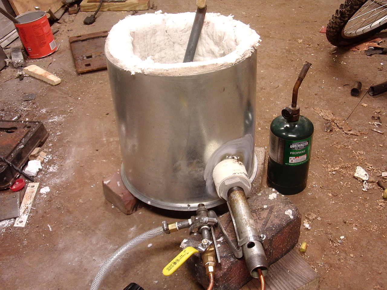

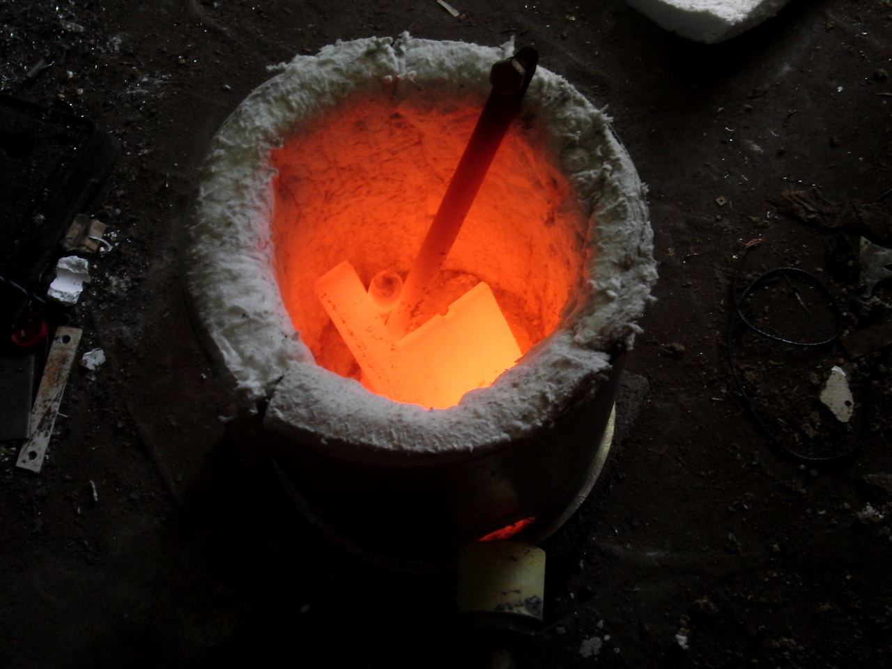

New foundry built today, and a torch to go with it.
Capacity will probably be about 200 cubic inches with a steel crucible, about 1/3 that with my graphite one.
I threw five pounds of steel in it and got it glowing orange in 3-4 minutes. It's mainly for bulk aluminum, but I might try using it to cast steel in the far future.

That's a possibility, though the paint bucket foundry had enough capacity for the bulkiest part in that design(piston). For testing purposes I'll probably make some ash trays for the guys at work, since a couple of them asked me why I rolled a big chunk of galvanized steel yesterday :).
Oh yeah, and I may use this as a forge in the future.
ramses
Posts: 1679
Does that use waste oil or straight propane?
Zeus
Posts: 1505
Location: 'Straya, C*nt
Nice work, looks like propane to me?
/sarcasm, /hyperbole
Fnord
Posts: 2239
Location: Pripyat
It's just propane. You can probably see there's no second inlet on the torch. (typically you need forced air with a waste oil torch).

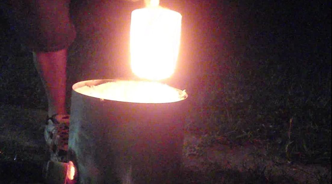

I cranked up the heat a little sunday night and scrapped some copper I had laying around... here's a crappy video still of the crucible coming out.
There was somebody else there with me  but the camera was on the tripod the whole time.<br />The rest of the video is just me complaining about stuff and talking about all the horrible things that can go wrong when you're playing with hot metal.
