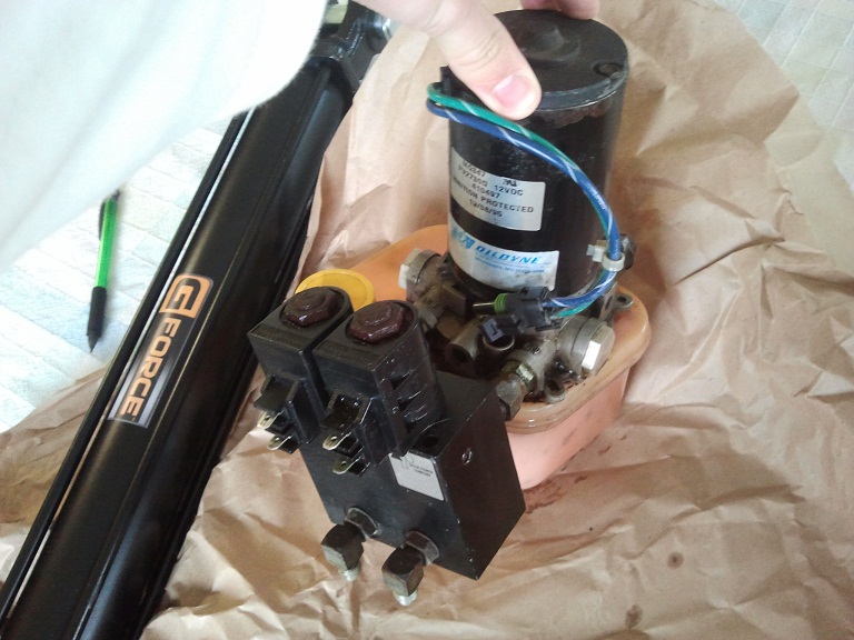

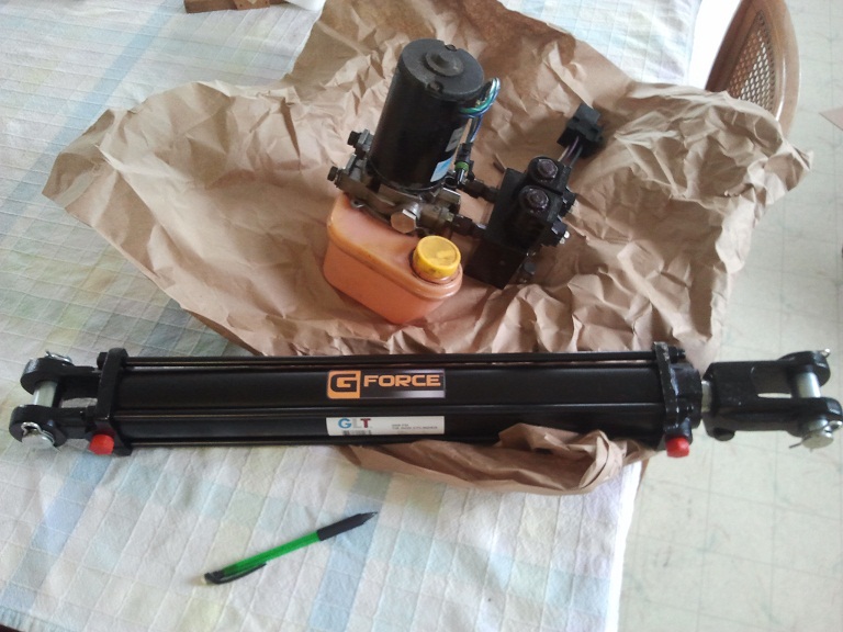

I showed my teacher of record a bunch of pictures today, and, even though it is not even close to being finished, he gave me an A for the semester, which basically means I'm done with high school. I hereby diagnose myself with senioritis.
And look at what came in the mail today:

Lawl... my reaction to that picture was DAYYYYYNGG!!!!
The cannon will be fully adjustable from 0 to 70 degrees. I didn't want to go any higher than that. With the small pump and such a long (16") stroke, it will be very easy to get precise measurements on the angle of elevation for calculations too.
