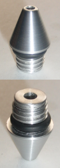

Part 3, which is just terrible because:
- the thread is not concentric
- the major diameter is far too small again, this time because I got carried away turning it down before cutting the thread
- the cap length is 14mm long instead of 15mm because yours truly didn't take the 1mm thickness of the parting tool into account
Also, as I imagined I like machining aluminium a bit less than I do brass.

jackssmirkingrevenge wrote: the cap length is 14mm long instead of 15mm because yours truly didn't take the 1mm thickness of the parting tool into account
Hows the finish with the parting tool? :D
You should cut the part so you have enough material for facing to the final dimension. You should really check those videos I sent you, JSR. Theres a lot of tips and tricks that will make your machining a lot easier. Not to mention step by step instructions and propper machining techniques :roll:
Well, you didn't practice before starting a simple project did you? You choose to practice ON the project :D
Don't feel bad, you'll need practice, one way or the other. I think you are doing quite well for a second day with the machine.

FighterAce wrote:You should cut the part so you have enough material for facing to the final dimension. You should really check those videos I sent you, JSR. Theres a lot of tips and tricks that will make your machining a lot easier. Not to mention step by step instructions and propper machining techniques :roll:
I'm trying to mix a bit of that with the self-taught technique of my mentor, today I spent more time reading that producing brass and aluminium shavings :D
This was deliberate, personally it's a better way to further my "education", if at the cost of "proper" materials.
No bad feelings at all, well actually just one, the threading aspect, but I'm working on it :)

edit: been thinking about how to get a concentric thread, came up with the following ptential solution which I hope to try later today. I figure if I make the rod 5mm or so longer than the final length, and turn this down to just over the minimum diameter of the thread (say 9.9mm or so in this case) this will give the die enough space to easily bite into the rod while in the lathe, allowing me to accurately finish off on the vice. The extra thread portion is then removed once the thread is complete.
Opinions?
