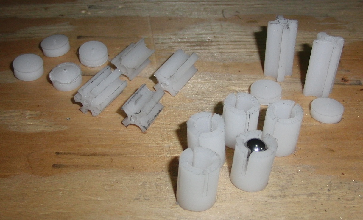

I've done some machining in the meantime, i apologise that the workmanship is quite shoddy and rough, I don't have much free time at the moment - but it should all fit well and give you some good results :D
There's 5 8mm bearing sabots for your rifled barrel, 4 collars and pusher plates for your smoothbore barrel and 3.4mm diameter nails that should slip on without modification, and two tail sections that would require you to cut the head off the nails.

Thank you!
I can not wait to test all these shoes!
I will remove the burrs, no problem!
you made multiple versions, it is good
Petitlu wrote:Thank you!
No worries, will post them tomorrow :) looking forward to your results.
I'm hoping the centrifugal force on the 8mm sabots in the rifled barrel will help the sabot spread and separate.
Don't bother too much, they are going to be fired after all :)
Thinking about it, it's best if you cut off the heads of all the nails you use, in order to avoid the weight at the back making it tail-heavy. A bit of 5 minute epoxy to keep the nails in place should be enough.
