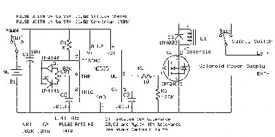

Here's what I plan on using... it's used to heat a small coil, so switching frequency isn't terribly important.
- 555pwm.gif (4.2 KiB) Viewed 5765 times

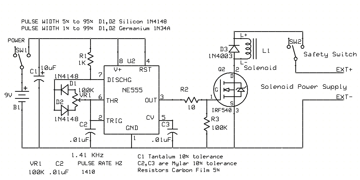

There appears to be an error on the potentiometer wiring.
I will do a schematic for 5-95% duty cycle.

The potentiometer's wired as a rheostat so doesn't function as a voltage divider but a variable resistor... using only one pin and the center one (wiper). Measuring the one I plan to use gives around 50 to 1000 ohms... probably need a 10kohm one or larger though.dewey-1 wrote:There appears to be an error on the potentiometer wiring.

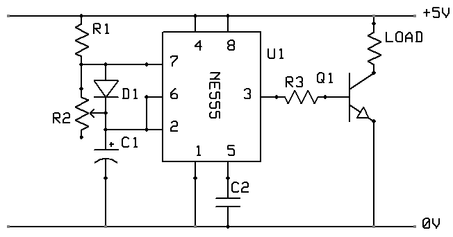

Mark, here is typical PWM 555 circuit.

I guess I have to actually study the workings of the 555 a little more to get why you would use a potentiometer to supply a fraction of the supply voltage to the trigger than threshold pins... I think either circuit would work but yours has the advantage of a constant switching frequency? Off to the books, lol.
EDIT: For instance, this makes more sense to me.
