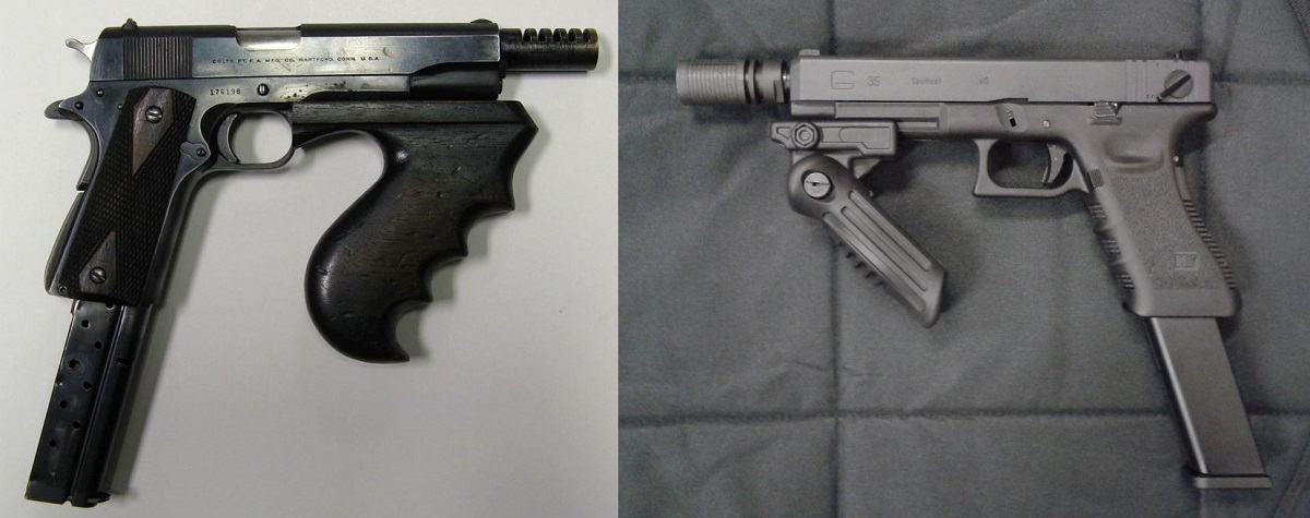

Here's some insanse stuff for you, had a go at recreating John Dillinger's autopistol as it would look in the 21st century

You do know there are drums for Glocks right

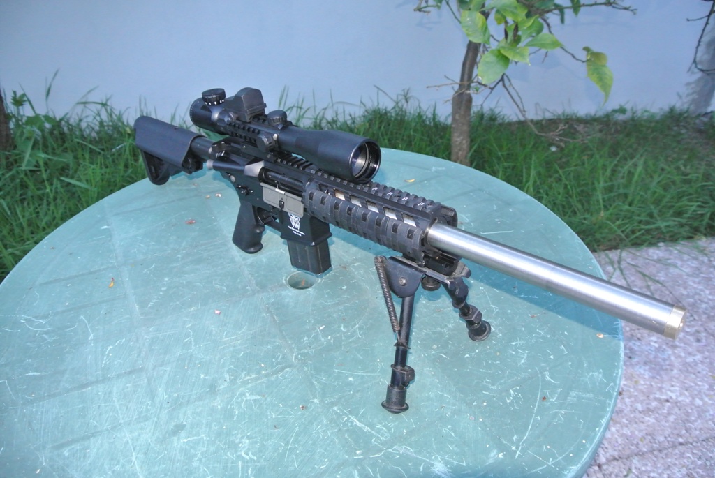

Well apparently the Portuguese airsoft forum has some users of "advanced stupidity" and a bunch of intolerant a$$holes, the forum was like the Spanish inquisition and my post was treated like witchcraft.
Anyway, in general it is true that the air bottle made the majority look down of these systems. So I combined what I know about PCP air rifles with my air blowback system.
Based on a G&G m4 raider, the close bolt offers lower air consumption and the usage of aeg hop up is very handy. So I removed the original outer and inner barrel, the reservoir made the new outer barrel and a 6.01 tight bore is sealed through it with floating o-rings meaning I can change the barrel when the reservoir is empty. The reservoir consists of a SS tube, only charged to 800 psi via a standard PB bottle, then the pressure is regulated to 100 psi by the CP inline regulator hidden in the buffer tube. It doesn't last much but for a HPA powered sniper rifle the capacity of lasting for a low cap is enough for a single match in my opinion.
