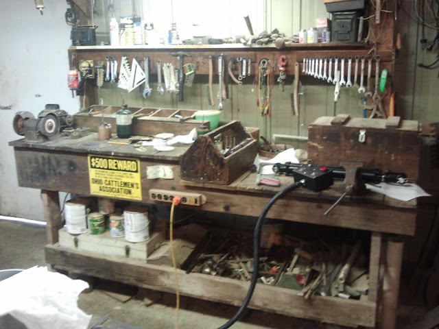

I added a support for the trigger and forgot about the recoil, so both ends of the 1/2" PVC leading to the trigger sheared off. Here's the new pilot and trigger assembly:
The hydraulic system is now fully functional too. Just need to find a 12VDC 30A power supply and do a little more wiring.
