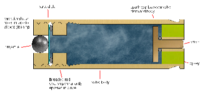

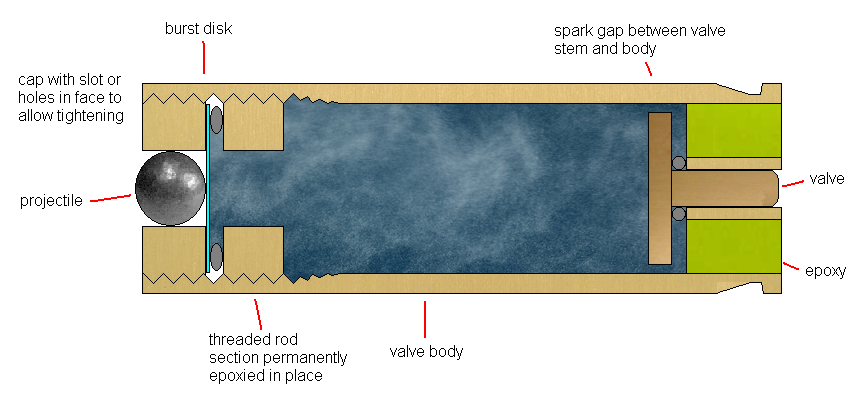

Now that I have some experience with my lathe, here's a design for a hybrid cartridge that is about as simple as I can think to make it with a burst disk.
There is no pump connection on the valve because the entire cartridge is intended to be placed in a fill chamber.
The epoxy base is essential to insulate the valve from the body to allow the spark to arc across the gap.
I would be more inclined to make a "valveless" cartringe with an adjustable o-ring detent that can hold the projectile at mix pressure but not at ignition pressure.

Awesome! Your is going through with the hybrid cartridges! These will be very cool to see when they are completed.
First I know nothing about hybrid and cartridges... but... I want to learn!

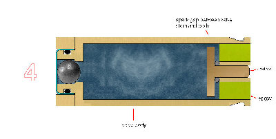

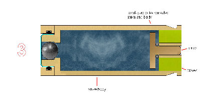

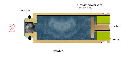

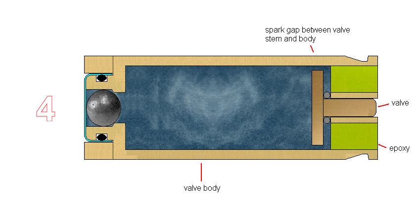

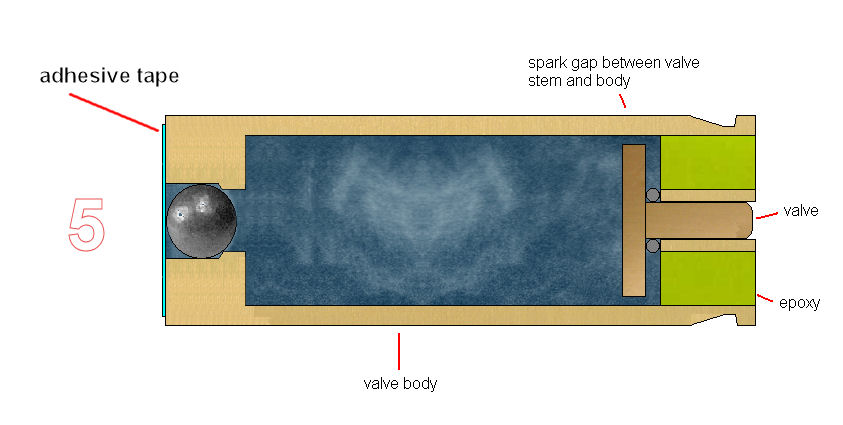

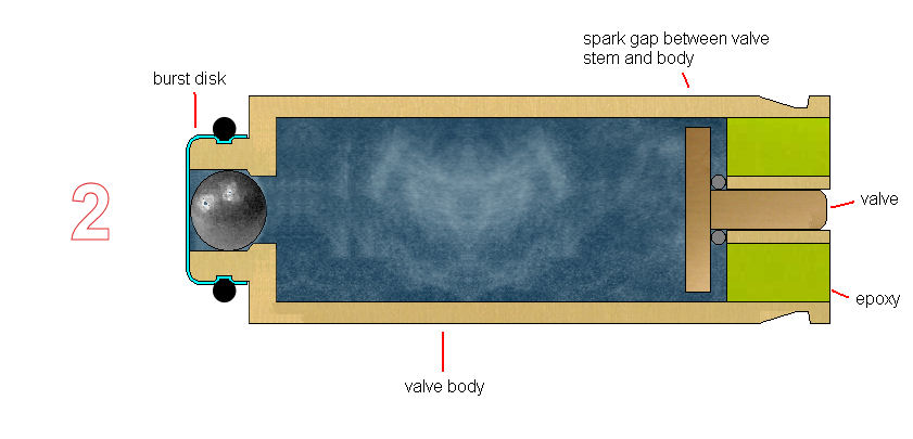

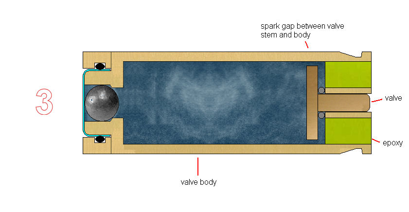

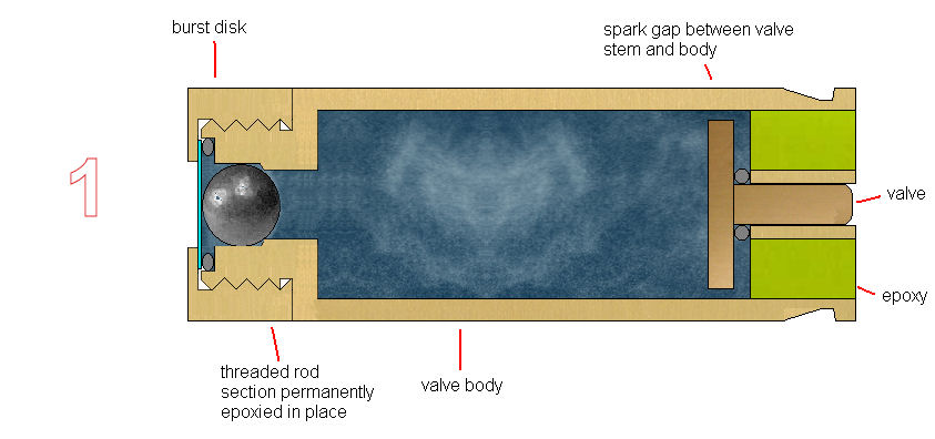

In the meantime this little ball just waiting to fall down was bothering me.
So here's my process of thoughts:
1) Over-engineered just as I love it. More fun to machine too
then I thought... threads are not JSR's best...
so... let's remove them!
2) Why not using a o-ring simply to tighten the disk around?
3) and 4) are just variations with a ring helping the compression.
5) And then
... why not a simple piece of adhesive tape? Too ghetto? Surely it has been done before!
Oh well... a little fun after a very long day at work.

I did it with packing tape and my pvc hybrid... Stupid me I know, but it was really loud.LeMaudit wrote:
5) And then... why not a simple piece of adhesive tape? Too ghetto? Surely it has been done before!
