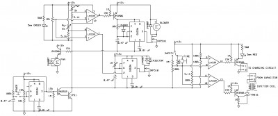

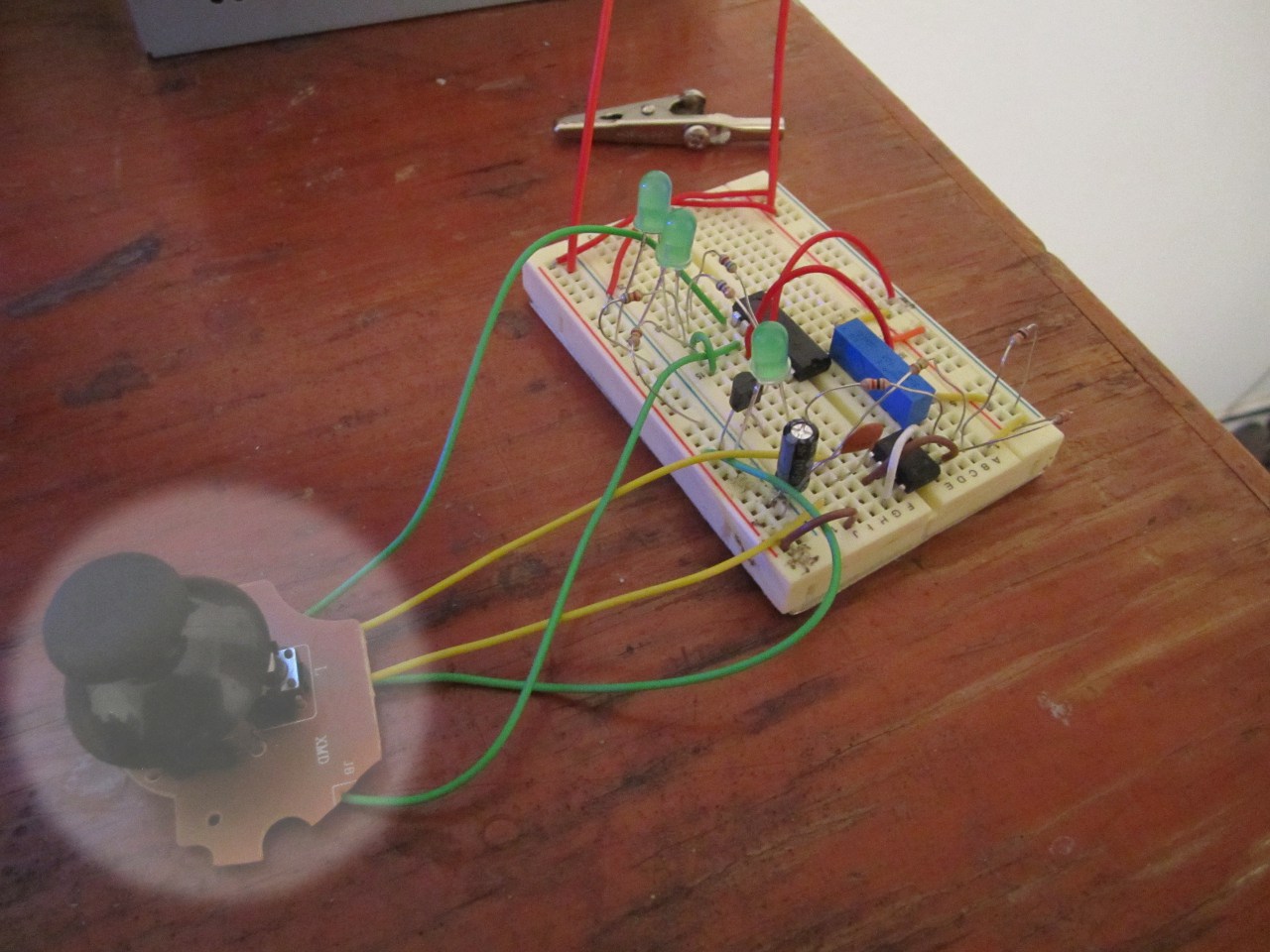

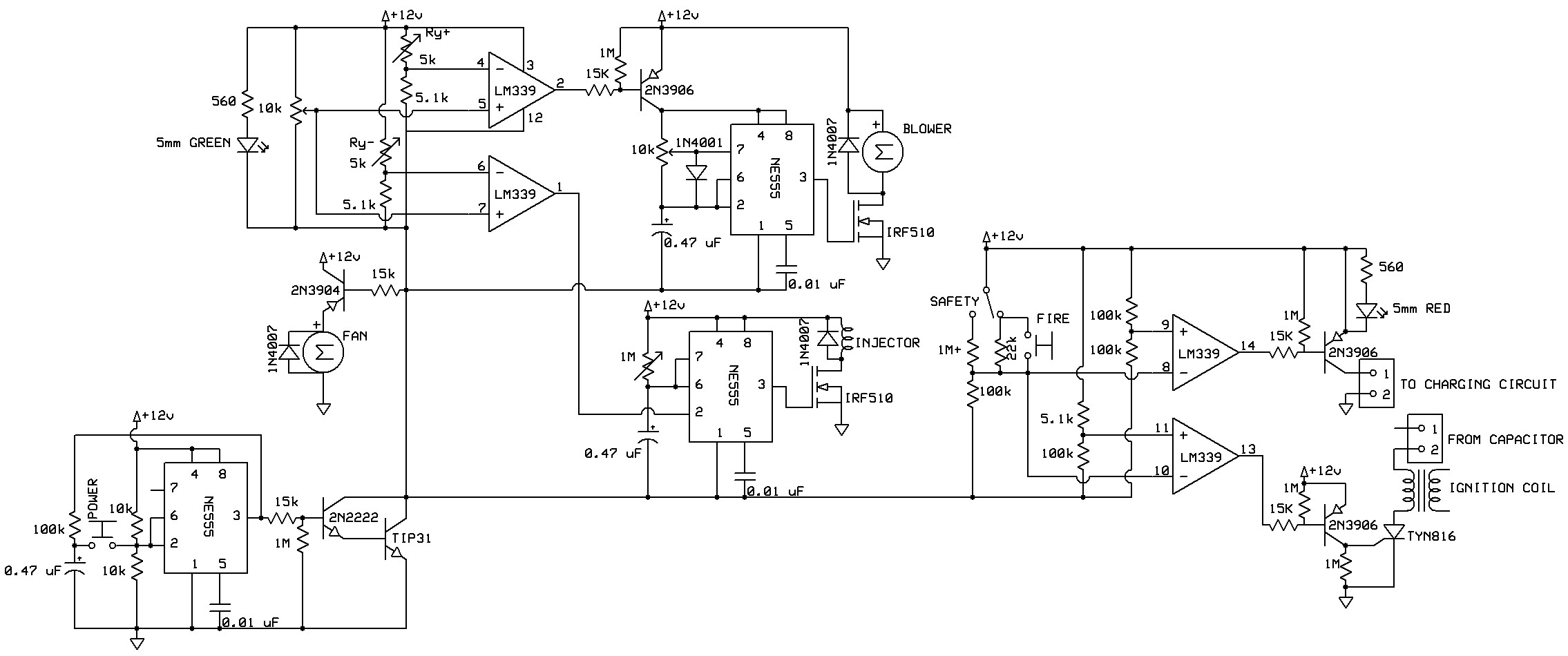

And very nice mark. May I ask why you didn't choose to go with a micro controller? But it's very cool that you're willing to design you're own analog circuit when there are lazy fecks like me around
Looks like the treasure chest from the "Dag for a day" episode of angry beaversmark.f wrote:I've highlighted the source of most of the added complexity...

I am with pneumaticcannons on this - Why didn't you use a uController ?

It's just what I like to do. I still have an arduino micro I could use, but I enjoy fooling around with analog circuits.POLAND_SPUD wrote:I am with pneumaticcannons on this - Why didn't you use a uController ?
