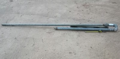

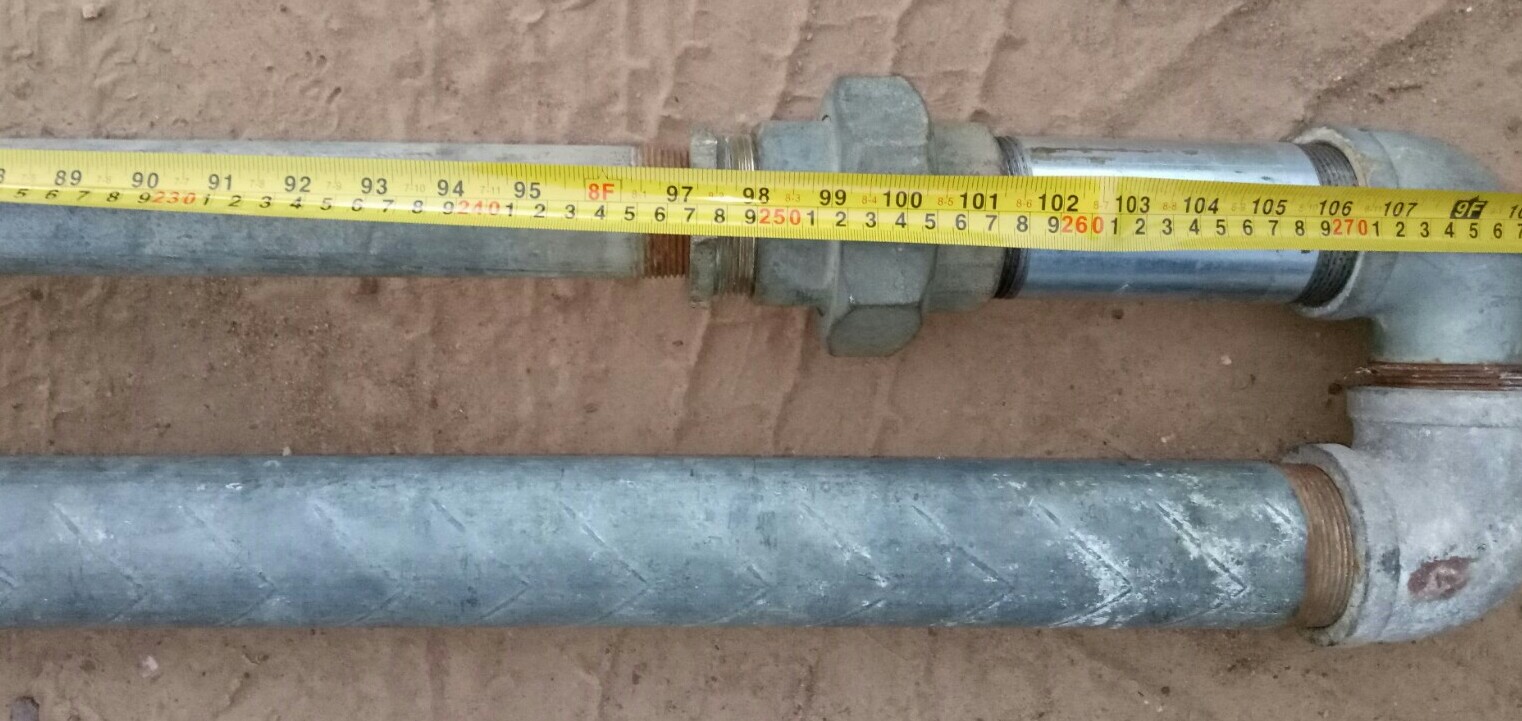

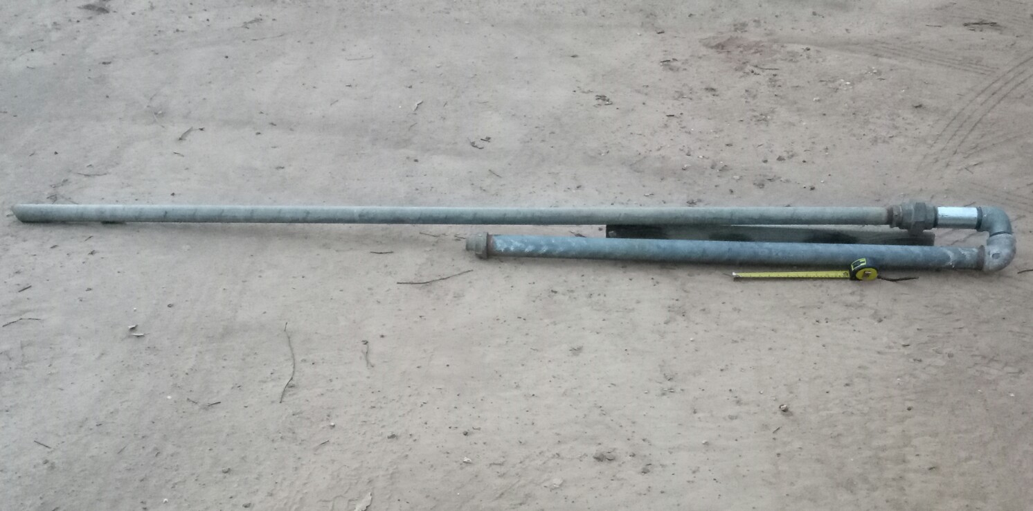

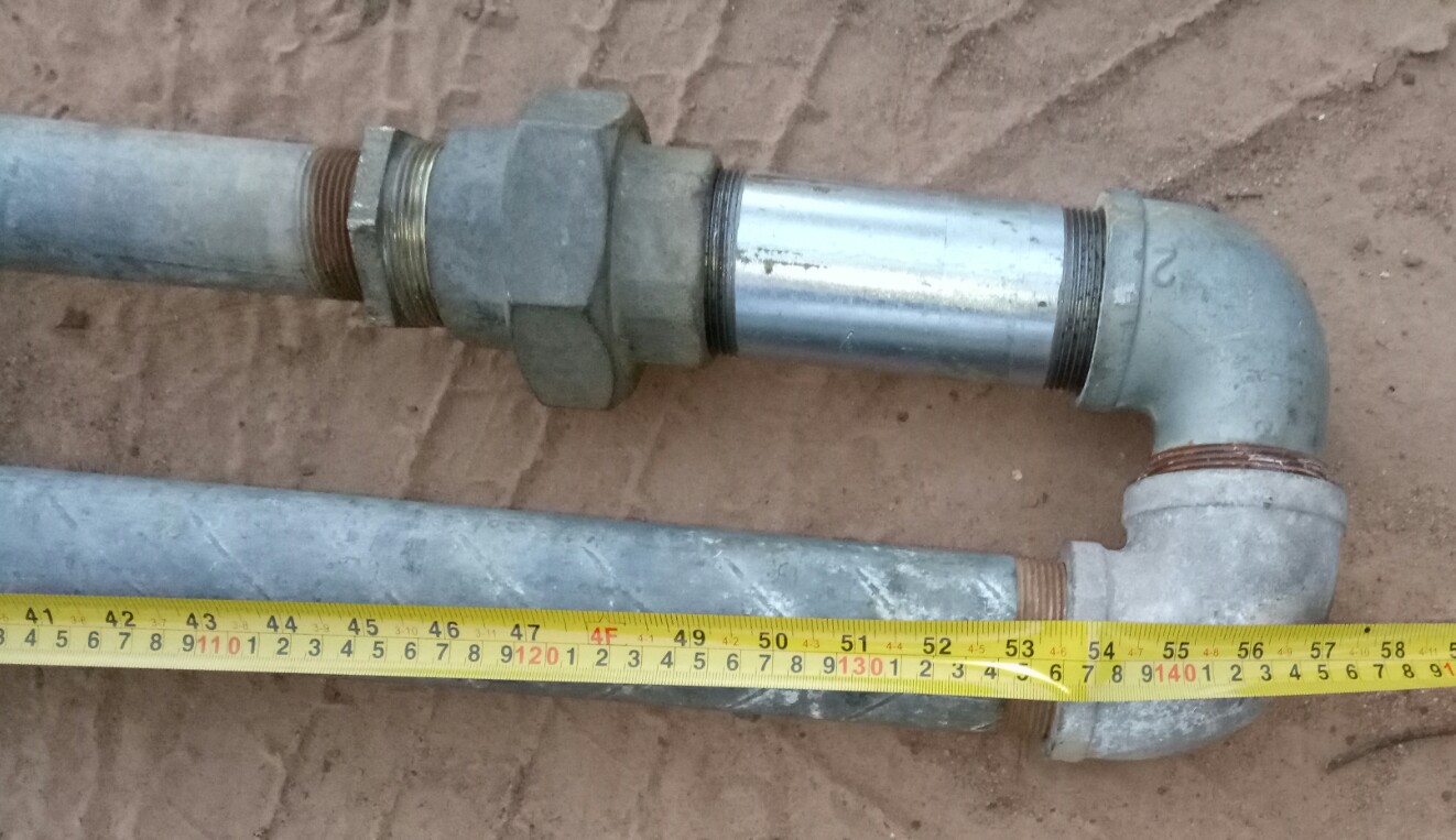

That looks like it will bring down a drop bear. Hybrid?
Hybrid of course. It was intended to be shoulder fired, but the barrel is a bit on the heavy side, being SCH40. I need some of MrCs tuning fork tubing.
