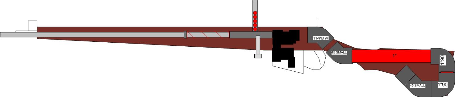

Staying with my love of all things single shot I am thinking a self loading single shot with a gravity fed tube of 10mm ball bearings.
- Lee - Copy.jpg (29.13 KiB) Viewed 7544 times

My one day, some day, pistol layout, I have the QEV, barrel and trigger valve already, damn, it's nearly built then
