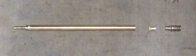

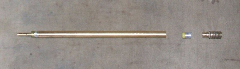

The only moving part is the piston, the aluminium tubing with the yellow BB stuck to it. Everything else is fixed in place.

So it is *slightly* servicable, with the help of a vice and a pair of pliers, I managed to remove the schrader valve. The reason behind this was that at 200-300 psi it would leak through the barrel, therefore given the small chamber volume its full potential was not being exploited.
I figured - for want of a better explanation - this was down to the spherical piston head pressing against the seal distorting it. What I did using my drill-clamped-in-a-vice improvised lathe was give it a flatter face, and also took the oportunity to shorten the piston as well as cut down on the dead space and shorten the body.
The Araldite's curing, I'll let you know if performance improves when it's done, though I left my shock pump in Spain so full details next weekend. Given my current string of excellent luck with pneumatics though, it'll probably not work at all now
