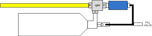

I think this might work :o with the slide valve open the chamber will fill through P, went it vents the QEV will operate, when it closes again the pilot air through the non-return will make sure it seats closed again hopefully before the chamber empties
:idea:
That's how it works in my head :wink:
I would still recommend one of theses as a trigger valve, a 3/2 with 3 ports, it's basically a ready made QEV trigger

F1 that drawing looks exactly what i put together, but the fill point is on the opposite side..?
Does the QEV need to be modded for that to work?

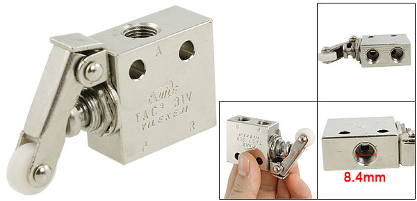

The trigger looks good, but when i google search/enter-3/2 trigger i can't find it anywhere, would you have a link by any chance?

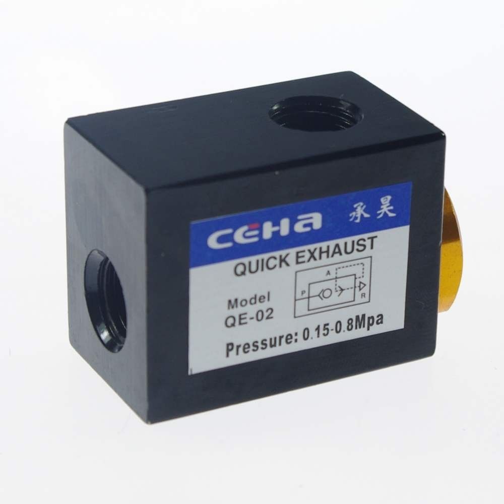

Ruined 2 more QEV's, but these smaller qev's are VERY weak, cheap pot metal.
Only air leak both times was on A, could never tighten it enough, and the photos show the result.
I wont be using those anymore...i couldn't believe they broke like that, wouldn't accept 100psi, it stopped leaking at around 50psi.
4 QEV's ruined... :roll:

Went back to my old QEV and never had a problem.
Not sure if my brass fittings didn't like the other QEV's...but the one pictured never leaked once, filled her up to exactly 350psi and the sound that came from it was rather intoxicating.. :)

wow, that's some poor chinesiem, the black block ones are pretty good, my 3/8 one was about $6 from Ebay. Sure someone here has tested these to failure to some really high pressures :shock:
If my circuit works the QEV can be standard, as god intended. But there must be a non return to make it seal when filling.

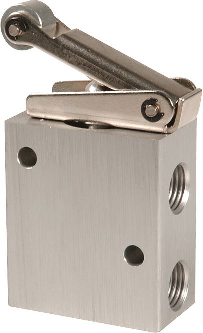

If you are near a Princess Auto they do a really nice 3/2 3port valve (roller lever valve) :idea:
https://www.princessauto.com/en/detail/ ... -p8192437e
Here's a nice one on Ebay
https://www.ebay.ca/itm/Air-Pneumatic-2 ... Sw2xRYRh0O

Ah thats awesome many thanks F1. :wink:
Do those triggers give the same performance as a 3-way/slide valve?

those lever valves are fine for triggering QEVs, 1/8 Npt ports should be big enough, keep the connections between the 2 as short as possible and small diameter so there is not too much volume to dump. I use 4mm OD air line, so it's 2.5mm ID, that would not take 1000psi though :shock:
