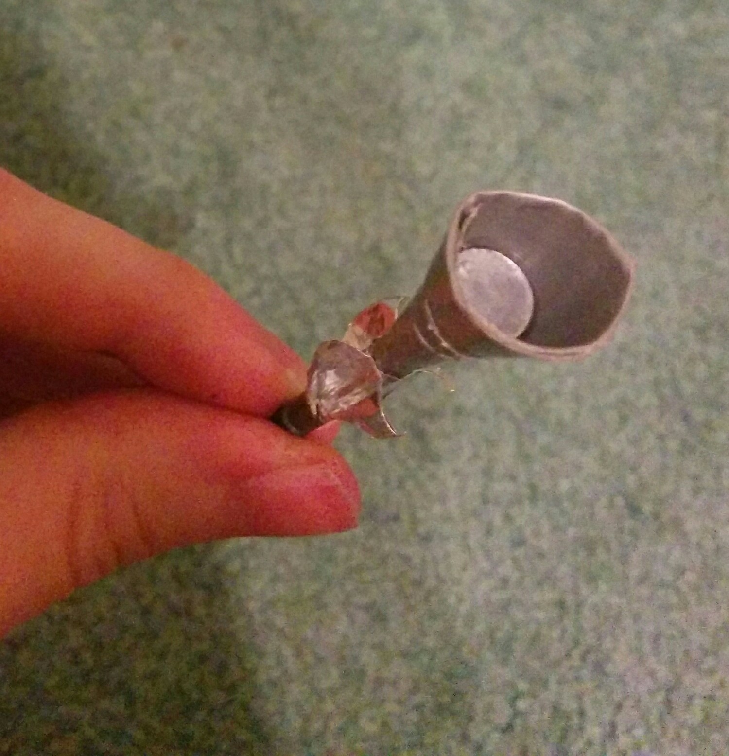

I finally got around to testing fletching on darts.
I made some quick and experimental (AKA sloppy) helical fletching onto a barbed dart I lathed on an electric drill.
Turns out (pun intended), that the dart actually does rotate as it flies!
I didn't temper this dart,I just quench hardened it and left it.
You can somewhat see the helical fletching here. I made it out of aluminum tape and it was difficult to keep neat.
I'm not sure if this increases accuracy at all, but my current tests have shown that it does indeed rotate clockwise as intended.
Sadly the fletching is easily crumpled and torn, so I'll be looking for a better material for it soon.
