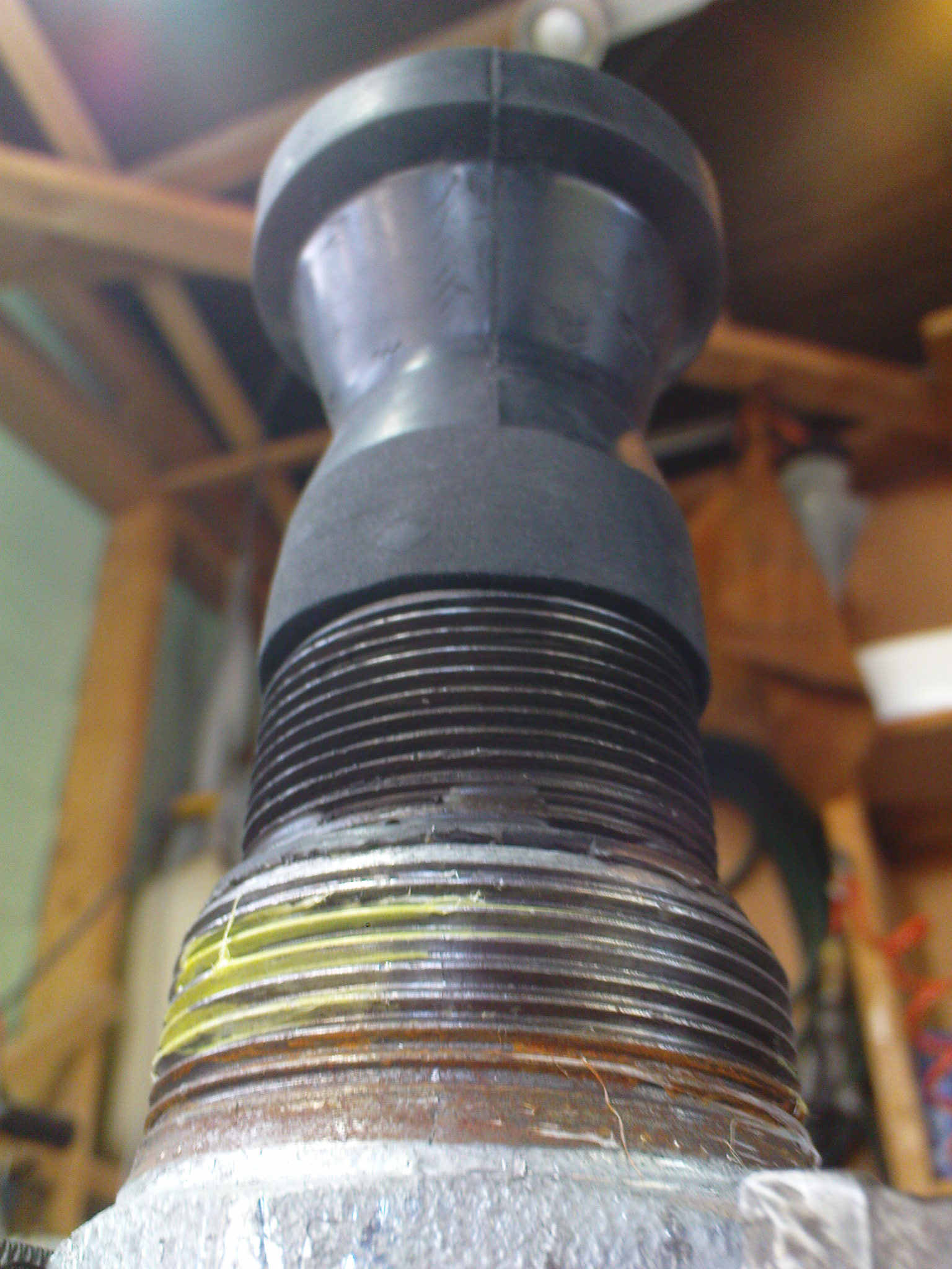

I've bought a keel roller to use as my new sealing face, I'll just use the end bit. If you're not familiar with keel rollers, they're made of very hard rubber that doesn't compress the slightest under human strength. Hopefully, if I file down the barrel seat, this sealing face wont be cut to shreds.

Hold it open? Even though the sealing face is epoxied down, it could morph enough under pressure?Now we just need a BIG fender washer to hold the sealing face open
When I remove the sealing face today and replace it with the keel roller, I'll try add the QDV style pilot as well. I have a wooden dowel o-ring piston that would work perfectly, I just have to remove some stuff and re-epoxy it
Edit: Attached photo shows new sealing face. I cut off about 25mm from the end and epoxied it on the piston. I couldn't believe how difficult it was to remove the old sealing face, I had to heat the crap out of it before the washer *popped* off.

Tested the new pilot valve today at low pressure. Seals well at 90PSI and I got the barrel to seal with 60PSI in the chamber but started leaking above that so hopefully with more pressure in the pilot (200PSI +) the leaking will stop.
Tomorrow: High pressure testing and hopefully I'll fire the cannon and make sure the valve still opens without bouncing.
Edit:
High pressure testing completed.
Pilot filled with 260PSI leaks to 250PSI over two minutes (time it takes to fuel + add air for 10x mix).
Chamber filled to 140PSI (with 250PSI in pilot), no leaks.
I'm satisfied with that, combustion testing on Wednesday

Things are working well. The piston doesn't open prematurely, it also opens fully without bouncing, there doesn't appear to be any leaking and it is louder than ever before.
