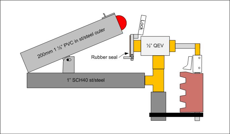

All the talk about grenade launchers has made me itchy to build something so I made a plan for a 40mm launcher. Foam golf balls and 1/2" QEV ordered off Ebay, the rest I have. Barrel will be 200mm 1 1/2" PVC inside 2" st/steel tube. 1/2" QEV triggered by 1/8" 3/2 lever valve, chamber 2 pieces 1" Sch40 st/steel tube, much fun to be had.

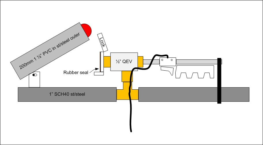

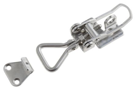

I might consider a simple break barrel, in fact I think I will
Barrel slides back to put pressure on rubber gasket, locked with a toggle clamp

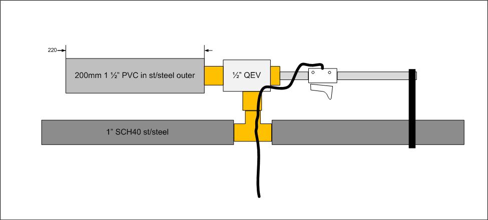

A possible pistol style, reduced chamber volume but lighter and more usable (fun), was going to say practical but

[quote="farcticox1"]A possible pistol style, reduced chamber volume but lighter and more usable (fun), was going to say practical but
are you piloting that with a simple push button valve? I want to build one of these for golf balls now
