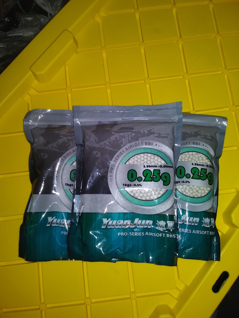

Also picked up these from the Princess Auto, 12,000 0.25g BBs for a total of $20.46 :D

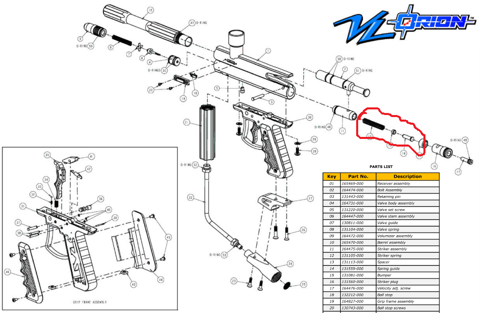

Finally got the old Viewloader Orion together and it seems to work, with only 120psi it will dry fire but wont cycle, I'm thinking there is not enough back pressure as there is no ammo to create any back pressure, going to get some rubber airsoft balls and try it at 150psi, maybe a weaker recoil spring will be needed :idea:

At full pressure a typical marker would cycle even without a projectile to provide back-pressure.
For lower pressure, consider boring out the valve seat in part #4 and increasing the diameter of the valve #6. This will compensate for the lower pressure with increased flow.

Yeh, I tried a super light spring and it made no difference, I will try it just a a single shot when I get some ammo. So the valve #6 is like a piston that moves forward and releases air/Co2 when fired ?

This is basically how it works:
The hammer (#11) strikes the valve stem (#6) knocking it open momentarily, allowing enough air to flow out for one shot.
Since you have low pressure in the chamber, there isn't enough pressure generated inside the mechanism to cycle the action.
You can compensate for this with greater flow by increasing the diameter of the valve seat and stem, but even then I'm not sure it will be able to cycle.
A lighter spring is easier for the air to cock, but it also opens the valve less, so the advantage is lost.

Got it, sweet, now I can see how that valve works. I think it will make a neat single shot pistol anyway. 50 balls on the way from China.
