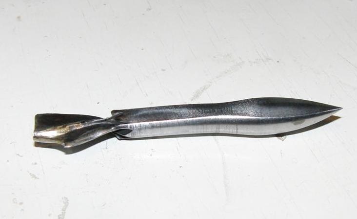

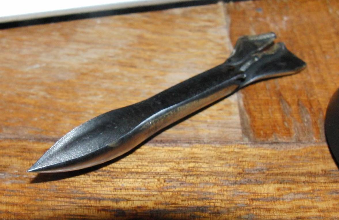

Before the failure i did two shoots with my darts , but it locks like the sabots is to weak to survive the extreme forces.
The first shoot with a hardened dart hit the steel plate and broke before it could penetrate but i suspect that the sabot disintegrated inside the barrel, The second shoot with a unhardened dart was even worse , the dart started to spin directly when it left the barrel and did hit the steel plate sideways with enough force to deform the projectile.
When i recovered the projectile i could see clear marks on the projectile both from the barrel walls and from when the brass burst disks hit the projectile.
So before i try the darts again i have to make some better "bullet proof" sabots.

Busted dart
Busted dart
busted dart.JPG (22.07 KiB) Viewed 5994 times
Busted dart
Busted dart

Why do you insist on the bulged nose dart design? All APFSDS designs I've seen use straight walled bodies. How about this soviet design?
The fins are the same diameter as the barrel for support, so you only need a small central sabot.

The main problem now is that the sabot is to weak and its both being hit by the burst disk fragments (3x of 0.5mm brass) and the extreme forces during acceleration.

Could a foam cylinder behind the projectile help?
psycix
Posts: 3684
Location: The Netherlands
Will break apart. I think you should consider a steel one.

jackssmirkingrevenge wrote:Why do you insist on the bulged nose dart design?
Presumably to help bring forward it's centre of mass.

Ragnarok: Exactly,, it was to forward it's centre of mass.

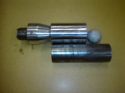

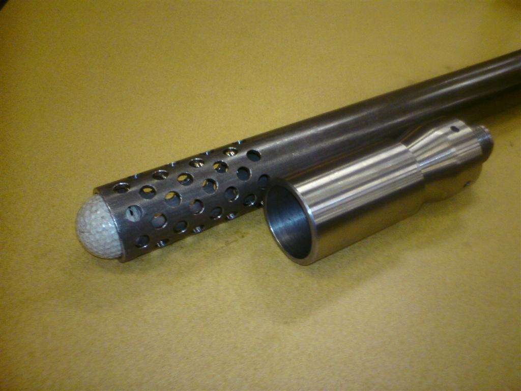

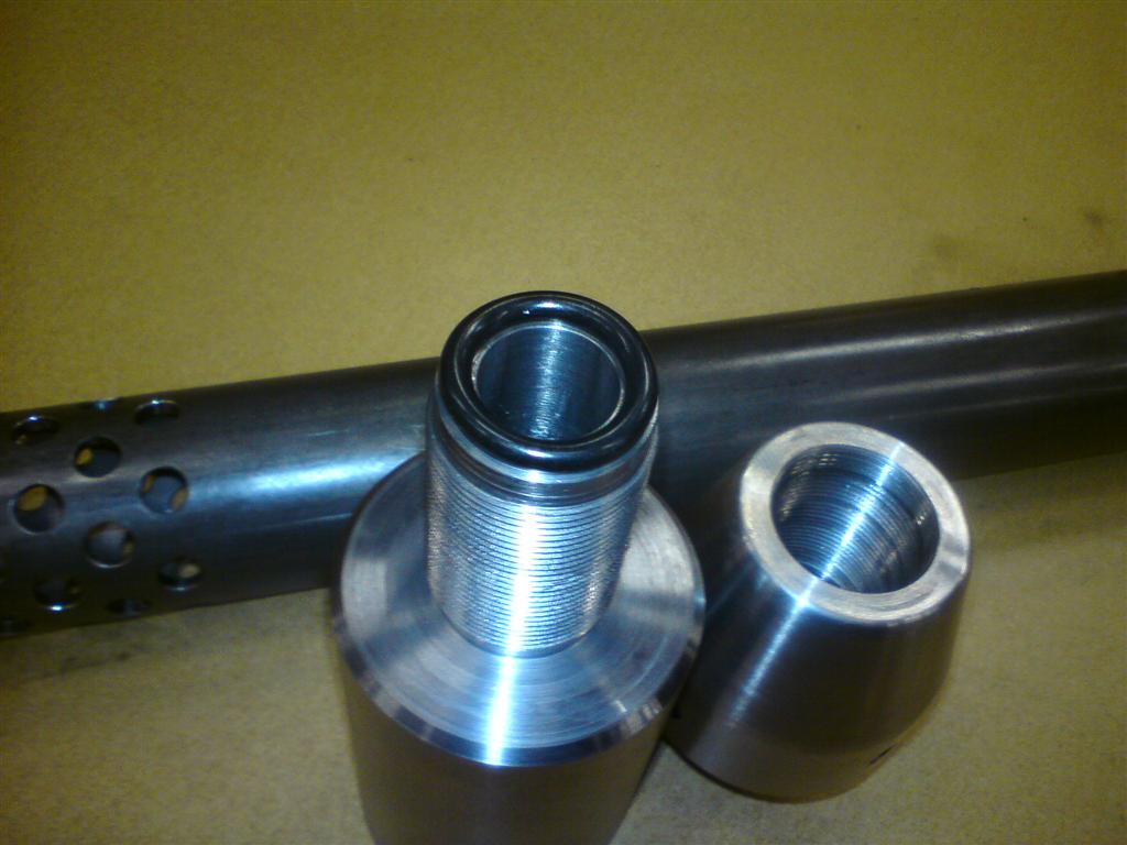

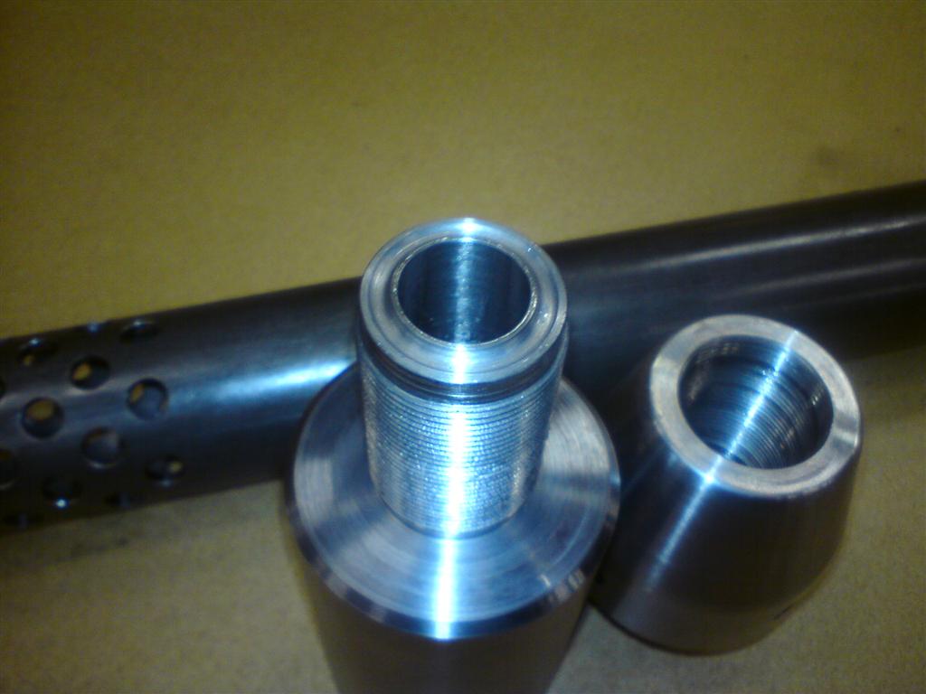

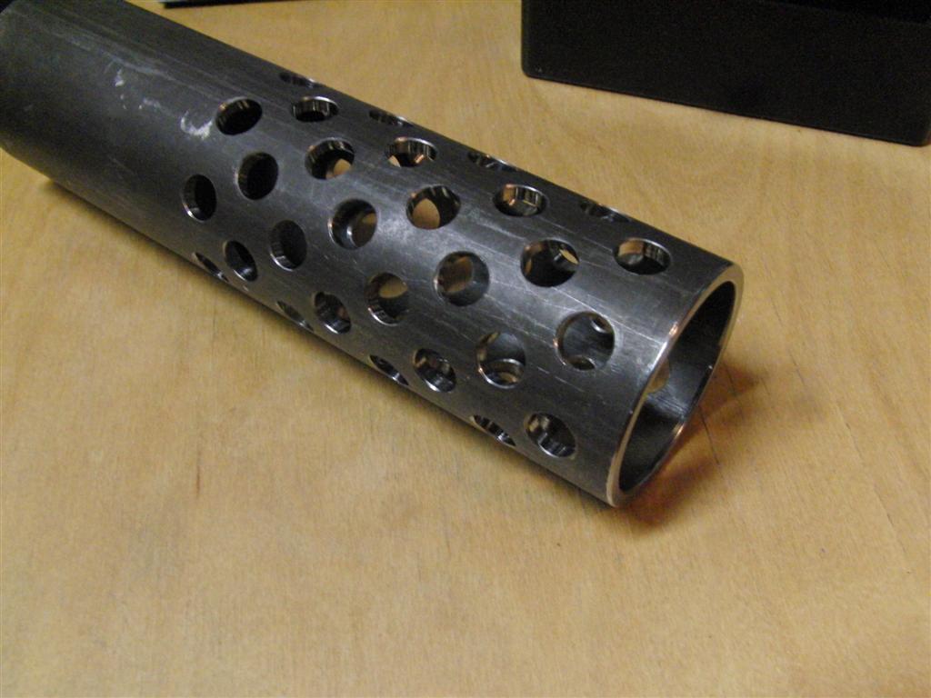

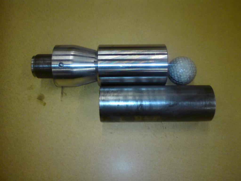

Yesterday i started working on a new GB barrel for the hybrid unfortunately i didn't have my real camera with med , only my mobile phone.
So sorry for the bad pictures.

Some sort of muzzle break.
Push to test... Release to detonate.
Poor, poor golfballs... Looking forward to see them screaming past the speed of sound :D

I am hoping for (speed of sound)x2 :D

Just what everybody wants,a golfball with brass chunks embedded in it traveling at mach 2 towards them!
I'd feel sorry for anything that gets shoved in that barrel..
Very nice, lets see if the golf balls hold up.

This was HOLY CRAP! - those pressures and that bore diameter? Heck, forget Mach 2, I'd be surprised if you weren't close on scraping Mach 3. I'd expect muzzle energies of 15000 ft-lbs or more.
My only real concerns are whether that barrel is up to containing the pressures - and whether the golf balls are going to deform horribly under pressure and jam in the barrel. Those forces and accelerations, you might see trouble.
