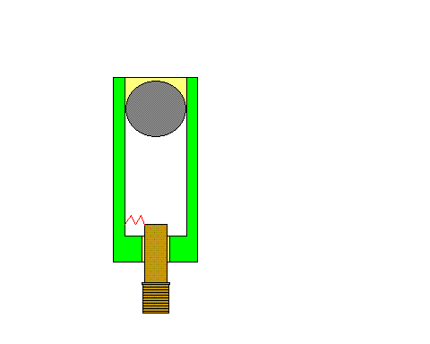

JSR, I think you might be better off to try that nichrome wire again. If you can't get ignition just up the voltage a little.
Light yellow is epoxy, red is nichrome, green is round stock of your choice OR threared bolt coupling.
If you have a drill press just drill out a piece of round stock. If you don't, just use a coupling and glue the schrader into a slice of threaded rod. Hell, you could just use a thread tap on the inside of a pipe that's about the right size.
(of course, you could also use a piezo with this, but nichrome is easier.)

The problem here though isn't ignition, but valve seal. Still, nichrome would be an easier ignition system to install in a complete launcher because the wiring wouldn't need that much insulation.Fnord wrote:JSR, I think you might be better off to try that nichrome wire again. If you can't get ignition just up the voltage a little.
Are you suggesting that I just epoxy the projectile in place?
I had though of this option when I first began thinking of hybrid cartridges on spudtech, something like this:
Not exactly quick reload time though, or easily predictable release.

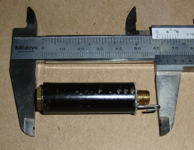

I'm currently making a micro hybrid with a burst disk in a compression fitting, making this for single shots but a cartridge will probably be similar.

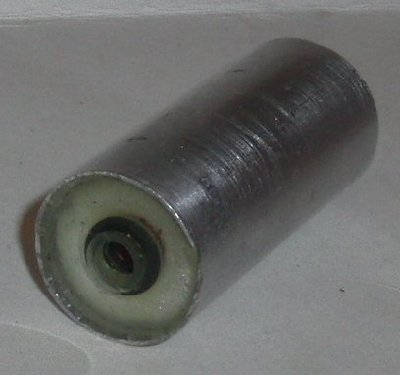

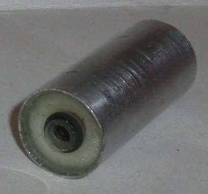

Posted some development in the mini-hybrid thread but it belongs here really.
It would appear the "non burst disk" idea is feasible with o-rings, but now a question of etiquette, do I stick with the tiny 0.177" BBs - especially after finding out that power is a little on the low side even at 16x from a small cartridge - or do I go for something with bigger balls?
- Posts: 26220
- Been thanked: 352 times
About 1/4" in this caseilovefire wrote:how thick are your epoxy plugs?
No vid I'm afraid, as it can only hold a 4x mix the spark gap is far too small at it won't ignite at that mix. In any case, now that I've gone to 16x I'm not interested in something that lowand have you tested it yet? cant wait for a vid
